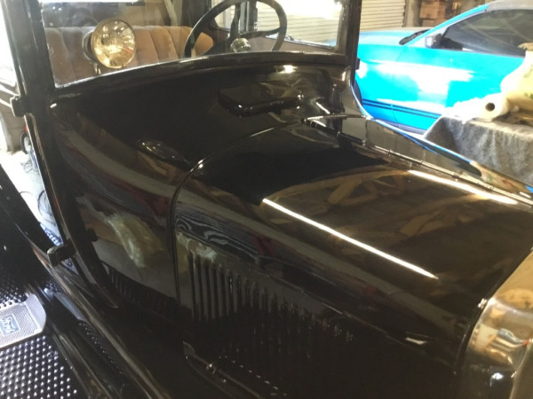

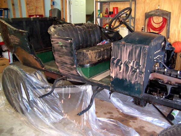

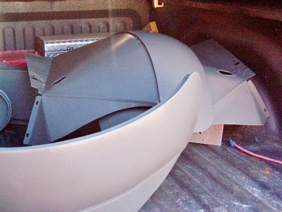

Gonna try a comparison pic of a DIY job on my former Model A...rear fender was done with a rattle can paint...Valspar Paint-n-Primer, the front fender was a local body shop job. Almost can't tell the difference in the picture...bit difference in real life.

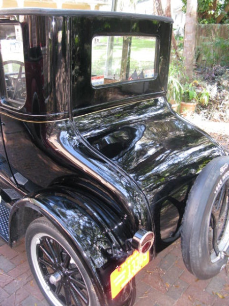

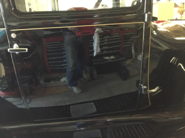

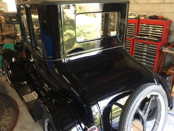

Good morning. I painted my 1926 coupe in 1995 with DuPont Gloss Jet Black Imron Epoxy paint and it still looks just as good as the day I painted it. Even back then, it was incredibly expensive but I’m glad I went all out with the best paint available at the time, probably of all time. It was one of those forever paints that almost lasts forever, at least in my case. Unfortunately, Ithink it was deemed dangerous by the government and is no longe available. Fortunately I bought two gallons of hat Imron with the activator for future use in painting parts or touch up. In the can, it lasts forever as well, until activator is added. Whoever buys my coupe when I list it in the next few week will get those two gallons of Imron with activator. Jim Patrick

PS. It just occurred to me that I have been posting those pictures for many years, leading some to be skeptical and asking, “So, what does it look like now?”. I just went out to the garage and took the following pictures just a couple of minutes ago. If you can find the equivalent quality of Imron, this is what you have to look forward to. What you see was painted 25 years ago and shows no sign of deterioration, age or oxidation and this is no trailer queen. While it has always been garage kept, it is not pampered and polished every week. Jim Patrick

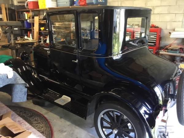

jiminbartow
- Posts: 2478
- Last Name: Patrick
- Location: Bartow, FL
Re: ball park paint cost???

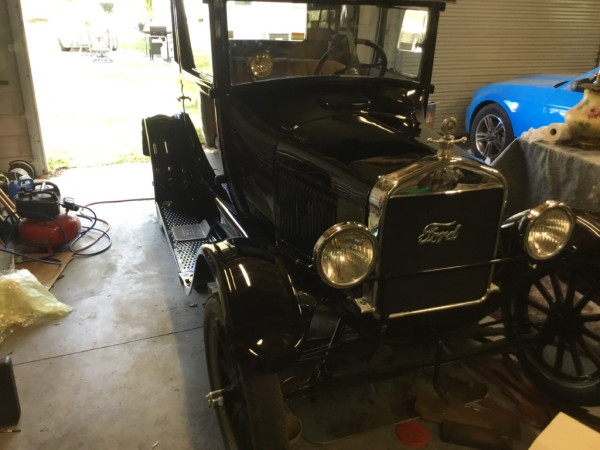

PS. Here are a few more. Jim Patrick

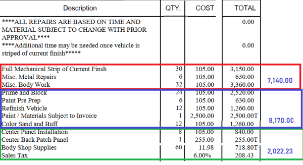

Just got an estimate for my 1927 Touring, $17,332.00, about $15,000.00 to rich for my blood
Attached PDF of estimate

The estimate appears to reflect painting it assembled. Is that correct? What is Misc. Body Work?

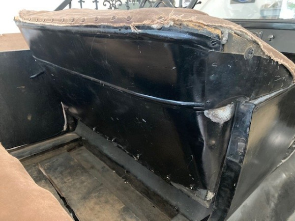

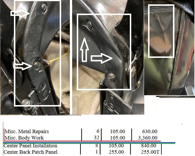

It has become very clear to me that I should have listened to Mom and Dad and made life work a Rocket Scientist ! ( or a painter as $17000 is out of this world!!!! ).....
- Posts: 7411
With the high tech fillers, I’d use plastic over lead any day of the week.

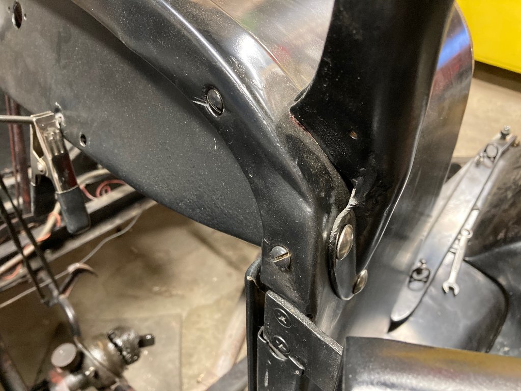

Plastic filler on my hood former (I'm guessing about 50 years old) has been cracking and peeling off. It was used as a cover to fill pretty serious orange peel. What should I use for that? Do I want to fill it with solder, or go with plastic?
...where is there lead filler on a T originally??
It didn't have orange peel originally.
- Posts: 4671
Clean it up really well. Go back with plastic filler, repaint or whatever you choose to do.
To what extent you want to redo your hood former, the plastic filler will be good for many years and probably outlast the folks reading this.

First off, hard to make a silk purse out of a sows ear. If filler was used to fill orange peel , it was used incorrectly to start off. If you got 50 years out of it, you did good. If you mean it was used to fill rust pits, unless those pits are white metal clean, something will come back. Also pinholes can cause problems. Also, braze repairs are notorious for causing future paint problems.
If you look at the big picture, finding a better former would be money well spent. Otherwise, sandblast and plasticfiller up again. I’d expect you’d be satisfied with another 50 years.
I’ve found it’s always most cost effective to start with the best possible object. Penny wise and pound foolish is a saying I use a lot.

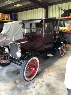

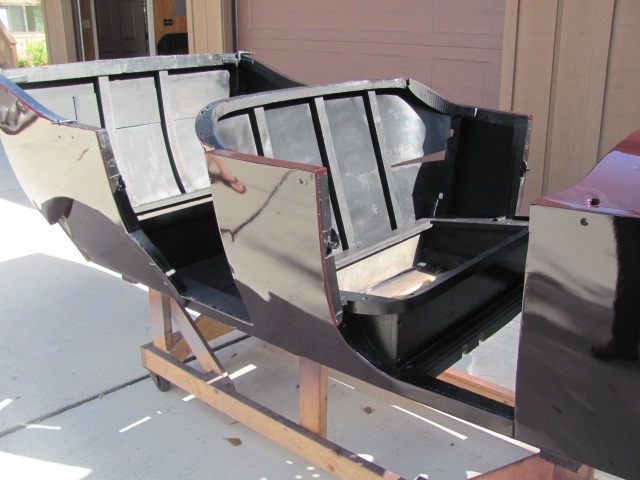

One way to reduce total costs is do the work yourself. Isn't rocket science as you posted!
This aftermarket-bodied Model T I did 8 years ago. Was intact but needed it all. Stripped the old paint with Citristrip chemical $60, then took the loose sheet metal, fender, hood, splash shield etc. to sandblaster, he also etched primed all. $200
Then did the hard part, sanding, prime, sand, prime, wet sand, prime, wet sand, the sprayed on sealer. (un-told hrs. of my labors of love
), primer cost @ $75. The finish paint, acrylic enamel with gloss hardener.
Bought the paint at local auto paint store, gal of black $122, gal. of maroon matched to original, $155. Then found down highway on US301, Hotrod Boyz paint and body shop. They do low cost stuff, like repainting trucks, police cars, etc. Trailered the body there on its wood rolling frame, and they painted it for labor cost of $400! Pays to ask around, they loved it, hadn't done an antique, but all they needed to do was roll it in their spray booth, and hang the fenders and hood sections and apply the paint I supplied. Great deal and looked good, mostly from my labor prep of the body.

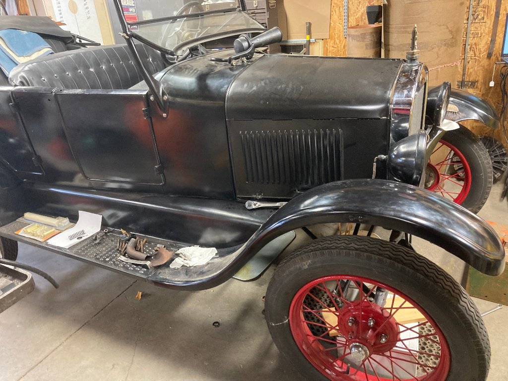

When I got my car it was 80% in primer, I painted it with rattle cans to get it one uniform color while I puttered around in it last year, The rattle can paint job I did is good enough for me but it need some body work, rear panel has a crease in it and the cowl needs some work that I'm not capable of doing and I'm having no success finding a replacement cowl. Going to hire out the body work and thought if I could get my car painted for $2000.00 I'd have it done, as of now I think I'm going to get the cowl fixed, paint it with rattle cans and call it good enough.
Body work in the quote is to replace the back panel and fix the cowl, they wanted just the body at there shop

So you have to remove the body and deliver it to their shop too!
Have you thought about what is involved in do that besides removing seats, windshield, top, wiring etc.. You need a dolly made to transport it with the wood frame, else the body will distort.
Not sure what condition the rear panel is that would require it to be replaced and if they are aware of what effort is involved. I would take the car to a dent repair guy for that and to see what they can do about the ripples down the seam - may be the result of a previous replacement. The drivers side of the cowl looks a bit suspicious - some rust flaking?. Fractures around the bolt holes of the dash may be a sign of another issue needing attention.
as they say = "If it ain't broke don't fix it"
