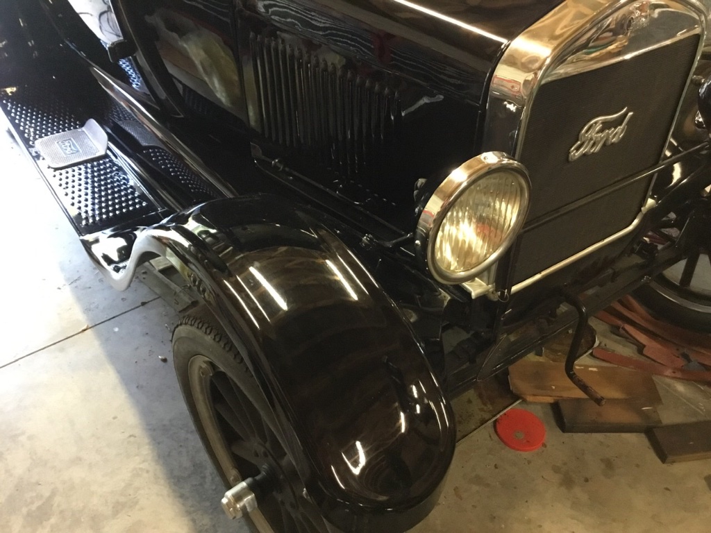

Post by TWrenn » Mon Feb 21, 2022 9:40 am
My Fordor was a frame-off resto by the guy's late father. He said he's pretty sure his dad sunk arond $15K in it, I did find the receipt for just the primer work...it was $3K for just that! It's a drop dead gorgeous job, both inside and out for sure. You can see he took off literally every part of the car, the chassis & running gear actually isn't as nice as was done on my '11 Torpedo, but good enough. The body work in and out is beyond perfect.

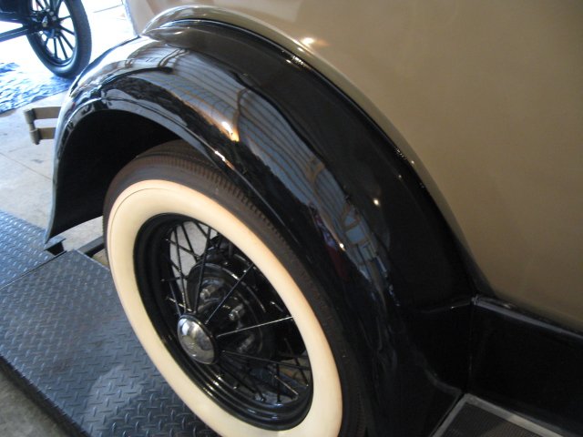

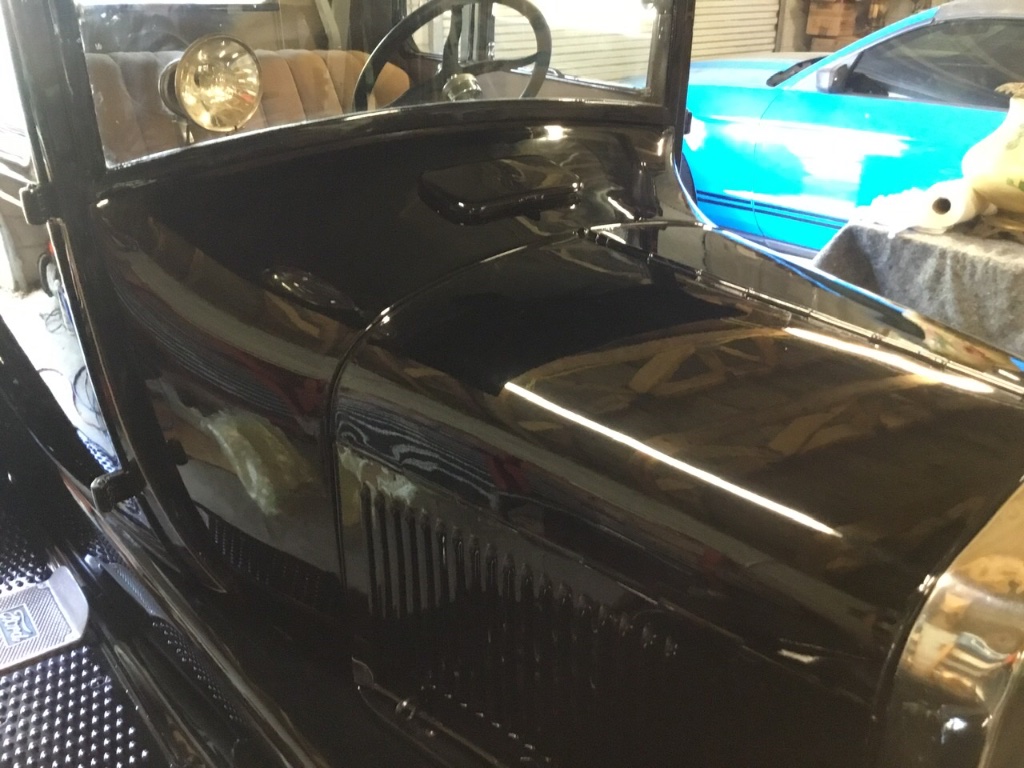

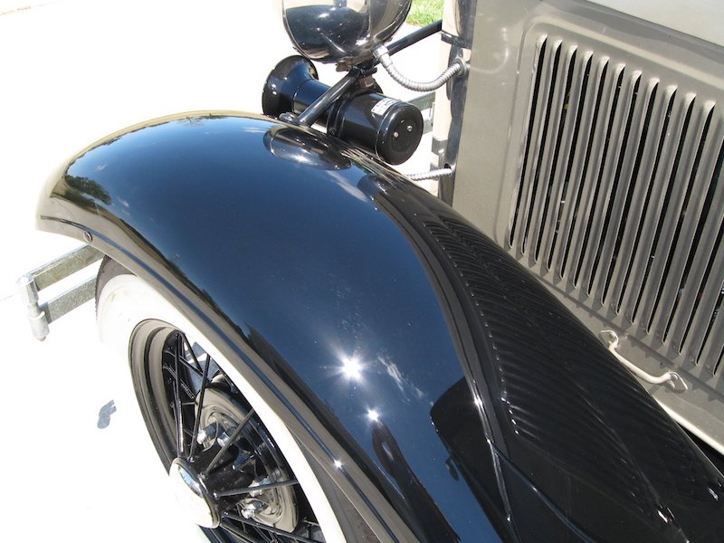

Gonna try a comparison pic of a DIY job on my former Model A...rear fender was done with a rattle can paint...Valspar Paint-n-Primer, the front fender was a local body shop job. Almost can't tell the difference in the picture...bit difference in real life.
rear fender w/rattle can paint
Body shop job
Body shop job

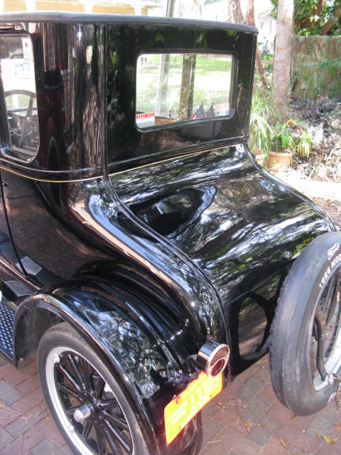

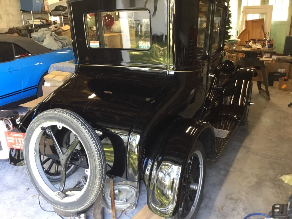

Good morning. I painted my 1926 coupe in 1995 with DuPont Gloss Jet Black Imron Epoxy paint and it still looks just as good as the day I painted it. Even back then, it was incredibly expensive but I’m glad I went all out with the best paint available at the time, probably of all time. It was one of those forever paints that almost lasts forever, at least in my case. Unfortunately, Ithink it was deemed dangerous by the government and is no longe available. Fortunately I bought two gallons of hat Imron with the activator for future use in painting parts or touch up. In the can, it lasts forever as well, until activator is added. Whoever buys my coupe when I list it in the next few week will get those two gallons of Imron with activator. Jim Patrick

PS. It just occurred to me that I have been posting those pictures for many years, leading some to be skeptical and asking, “So, what does it look like now?”. I just went out to the garage and took the following pictures just a couple of minutes ago. If you can find the equivalent quality of Imron, this is what you have to look forward to. What you see was painted 25 years ago and shows no sign of deterioration, age or oxidation and this is no trailer queen. While it has always been garage kept, it is not pampered and polished every week. Jim Patrick
jiminbartow
Posts: 2482
Last Name: Patrick
Location: Bartow, FL
Re: ball park paint cost???
Post by jiminbartow » Mon Feb 21, 2022 12:08 pm
PS. Here are a few more. Jim Patrick

Tim Wrenn makes a good point in comparison of the rattle can paint job to a standard job.
If his whole car was painted with about 2 -3 cases of rattle cans it would look pretty good,
And as good as Henry’s!

Post by TWrenn » Mon Feb 21, 2022 4:22 pm
Jim your car with that Imron looks great. I wish it was still available. As you said it's indestructible. I've used it, have a little left. Used to be put on commercial airliners cause it held up so well to the extreme temp changes.
John, thanks. I've often threatened to do a complete paint job on a project car just to try it. That Valspar paint as well as the appliance epoxy has come a long way if prepped right and sprayed carefully. They really don't do bad if you're not wanting museum quality out of them. And a LOT cheaper!! :lol:

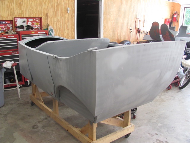

Post by Loftbed » Mon Feb 21, 2022 6:46 pm
Did this PW back in 2016 and material costs exceeded $1500.00 two stage BC/CC
If you're going for top of the line show finish or average, just remember that after care is a very important part of how that job will look after a short time. throw away them bath towels I don't know how many times I've seen a great paint job destroyed by the use of dry towels as a dust cloth. Detail spray is your friend.

One way to reduce total costs is do the work yourself. Isn't rocket science as you posted!
This aftermarket-bodied Model T I did 8 years ago. Was intact but needed it all. Stripped the old paint with Citristrip chemical $60, then took the loose sheet metal, fender, hood, splash shield etc. to sandblaster, he also etched primed all. $200
100_8096 (640x480) (600x450) (580x435).jpg (135.68 KiB) Viewed 9403 times
Then did the hard part, sanding, prime, sand, prime, wet sand, prime, wet sand, the sprayed on sealer. (un-told hrs. of my labors of love ;) ), primer cost @ $75. The finish paint, acrylic enamel with gloss hardener.
Bought the paint at local auto paint store, gal of black $122, gal. of maroon matched to original, $155. Then found down highway on US301, Hotrod Boyz paint and body shop. They do low cost stuff, like repainting trucks, police cars, etc. Trailered the body there on its wood rolling frame, and they painted it for labor cost of $400! Pays to ask around, they loved it, hadn't done an antique, but all they needed to do was roll it in their spray booth, and hang the fenders and hood sections and apply the paint I supplied. Great deal and looked good, mostly from my labor prep of the body.
