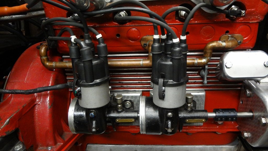

Your cut off year of, 1927 parts only, means things will not come cheep to go two spark. The two cap system you talked about is from a Stuz and they can be mounted like a side drive mag, that would fit 1927 requirement. Back in the early 1980’s I had a BB Rajo running a Bosch ZR4 mag on a cross drive, it was very fast. I don’t think the two spark Nash distributor came out until the later 1930’s, but it would look something like the more current Nissan two spark that you talked about. Back in 1927 there were many left over Bosch ZR4’s mags, 2 mags per airplane, because they had been used in WW1 trainers and in early 1920’s airplane engines that were now outdated by 1927. I think that Layden Butler had a Bosch ZR4 mag for sale not to long ago, but I could be wrong on that. I haven’t seen a Stuz system for sale in a long time. Maybe get your car running with a later system until you can get the 1927 system you really want. Good going with your project.

I am running a Stutz on a BBR. They bolt to a standard magneto mount. Bosch works well. This set up was THE set up in period. I am always looking for parts. One vendor had a used cap @ Tulare - $400. I did sell a extra complete Pierce unit(same) a few years back for a smokin good deal @ $1200. If you can find the body, later stuff can be adapted. Its an expensive way to go, unless you get really lucky.

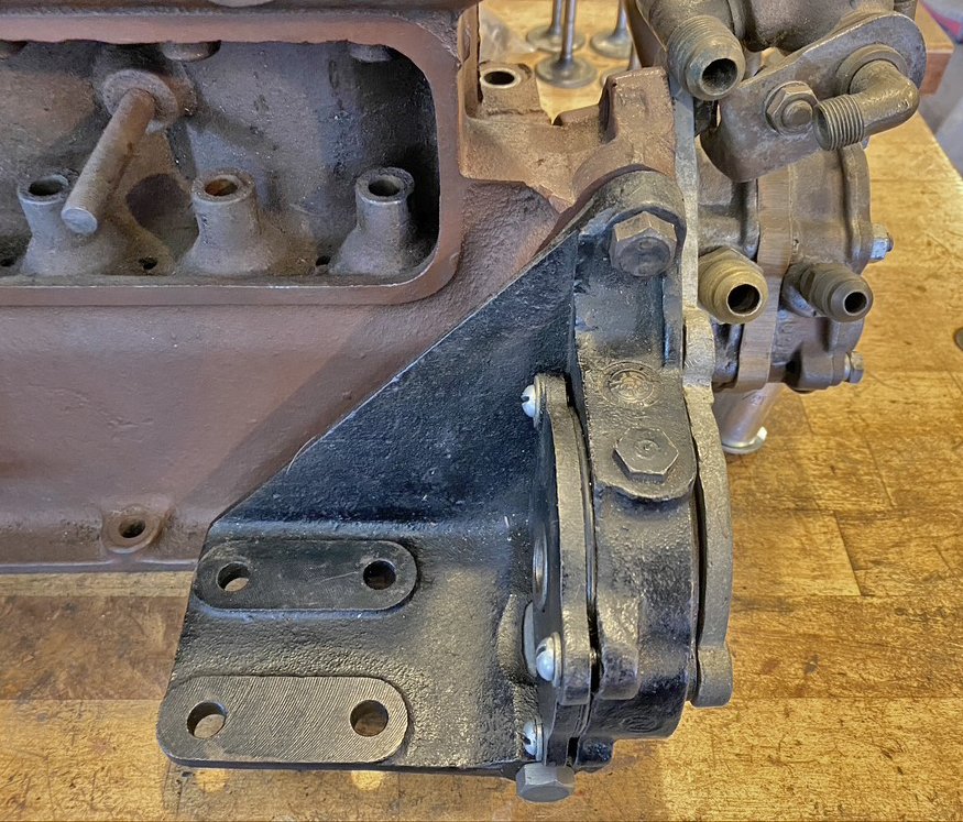

Morgan if you want to stay pre-1928 here are two of your choices and one the dates to 1929.
Left to right top photo: a Stutz Dual Delco and a ZR4 Bosch two-spark mag although both are expensive and hard to get in todays market place and will also need rebuilding. There are other two spark mags available at lower prices. I've used both although my first choice would be the mag but and they both workout well.
In the middle is a Nash twin-fire 8 cylinder distributor adapted to a T on an iron base for aftermarket distributor, it was 1st offered in 1929. By the time you find a good unit and a base, convert it and rebuild both it could cost about a third of the other choices. Only eight of holes in the top need wires and the other eight stay empty, although they could be wired to a ground with wires to look a little better. I used this unit in a Rajo BB in the past and it worked out fine.
In the Bottom photo: Is American Bosch mag adapter which takes the place of the original Ford generator mount. Both The Stutz Dual Delco and a ZR4 Bosch mag or any other mag need one of these, they are not inexpensive either and sell for about $500. There is one in the classified ads for sale now.

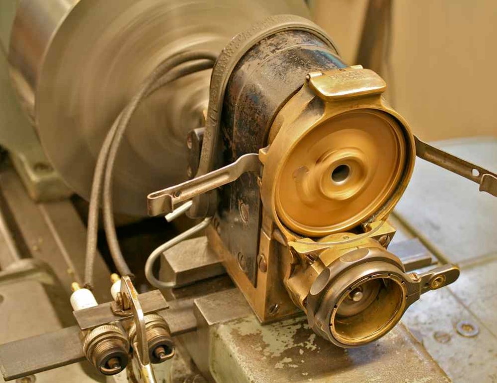

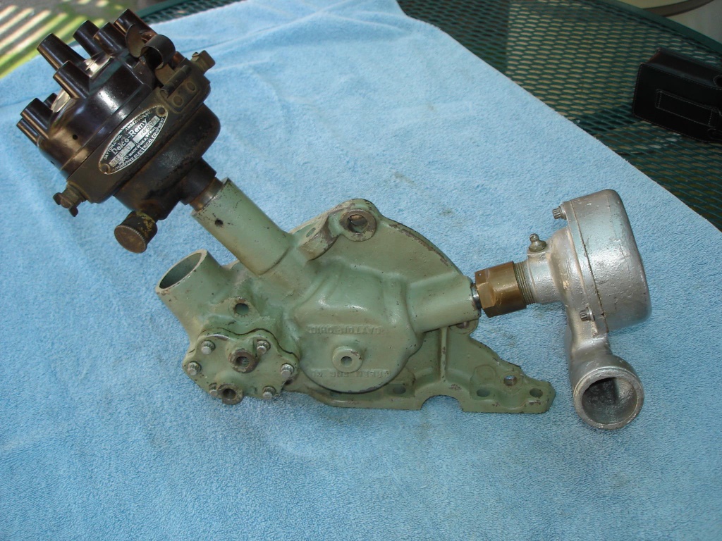

Morgan, Here is one that slipped my mind that was made in the teens and twenties and they come up for sale now and then; it is probably the most affordable vintage dual systems today. It's a Philbrin dual 4 cylinder distributor that can be driven off either end and in either direction. They also made other single units for other cars including one for the T. Philbrin was a sponsor for the Duesenberg racing team in the teens and these units proved to be reliable, and helped them win a number of races.
The one in the bottom photo is one on a 1915 Duesenberg racing car I have done a lot of mechanical work on and prep it for vintage races for a customer. The two distributors were replaced with semi-modern Delco units by another shop before it came here 30 years ago. I had the bottom half apart then and it was in very good condition, and did it again last year and it's still in the same condition after running in about 15 race meets at high speed. Based on this experience I would recommend one for a dual setup.
