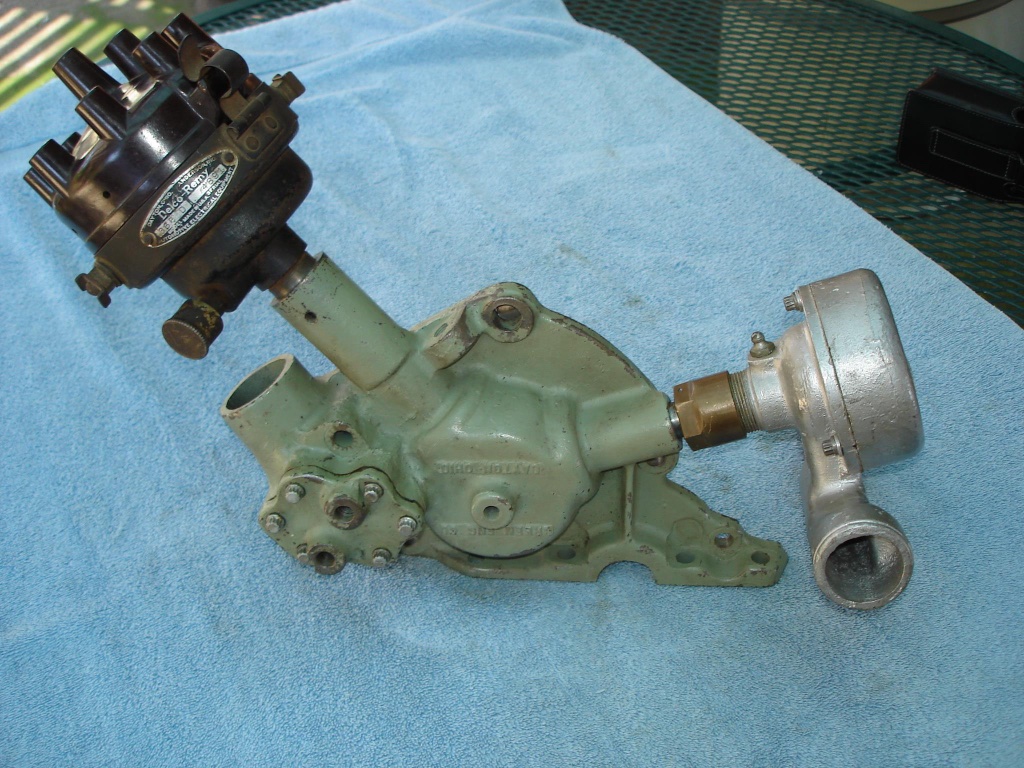

Morgan, Here is one that slipped my mind that was made in the teens and twenties and they come up for sale now and then; it is probably the most affordable vintage dual systems today. It's a Philbrin dual 4 cylinder distributor that can be driven off either end and in either direction. They also made other single units for other cars including one for the T. Philbrin was a sponsor for the Duesenberg racing team in the teens and these units proved to be reliable, and helped them win a number of races.
The one in the bottom photo is one on a 1915 Duesenberg racing car I have done a lot of mechanical work on and prep it for vintage races for a customer. The two distributors were replaced with semi-modern Delco units by another shop before it came here 30 years ago. I had the bottom half apart then and it was in very good condition, and did it again last year and it's still in the same condition after running in about 15 race meets at high speed. Based on this experience I would recommend one for a dual setup.
Last edited by David Greenlees on Fri Apr 29, 2022 8:53 am, edited 1 time in total.
