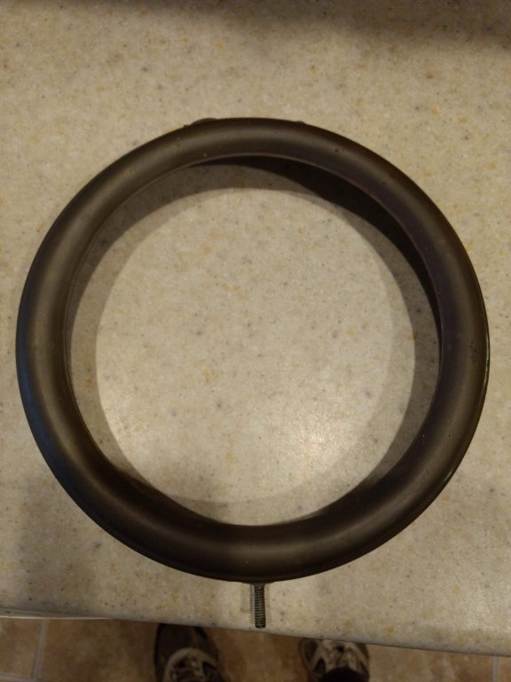

Re: Brass cleaner suggestions?
Craig,
here are the door sill pieces as an example. The other brass pieces are dull and brownish looking, but not corroded as bad.
Hi Neal,
Pat is correct about exposure. I used Zepp because it is stronger than vinegar. If you use vinegar try the commercial grade it's more like 30% -35%. Many of the polishes are acidic, I like to wash & wax after polishing.
Craig.
Craig.

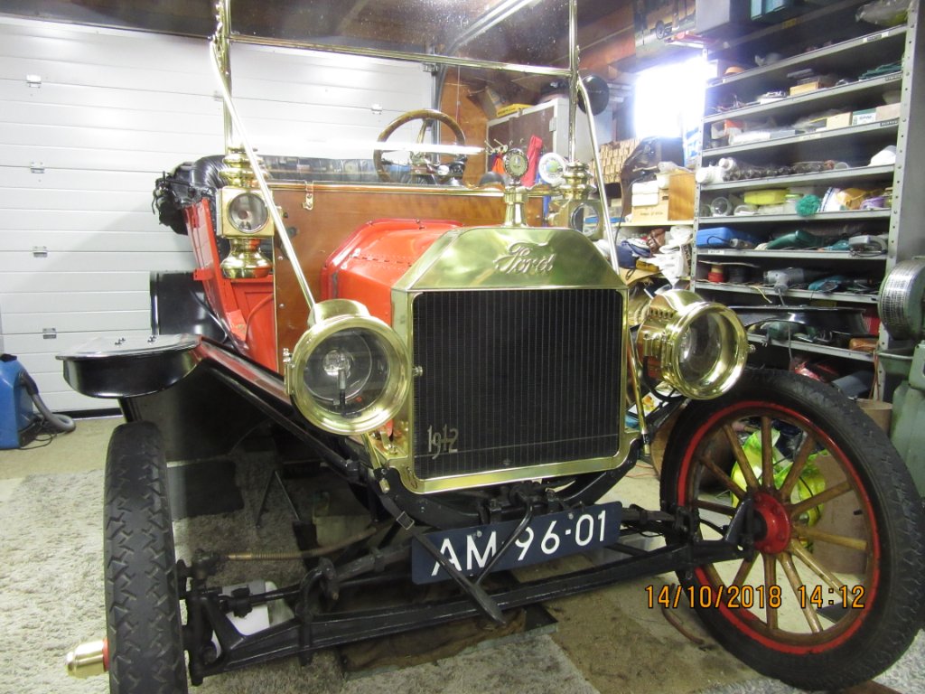

To polish our 1912 to do that it take's about a day .
And I don't like to do that often.
One time a model T-friend told me he has some thing to spray it on .
We both use that for four years ago now .After we drove in rain and snow several times, it looks still good.
Just a little darker as after polishing .
You can take it off with Aceton if needed
The spray is sold by: HG a Dutch company .
