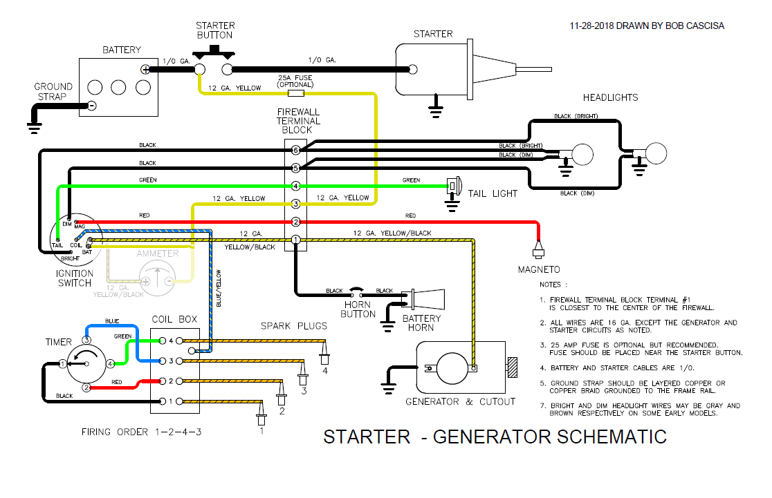

Would it be possible to run a car without an ammeter?
How would you configure the wiring if possible?

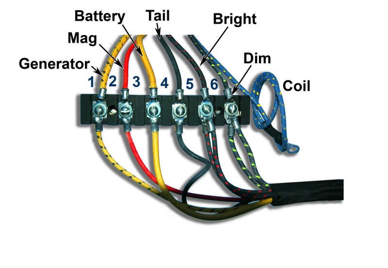

the battery wire would go directly to the BAT position via the barrier strip

So the striped yellow and the plain yellow would go on the same position on the junction block?

Yes. Just think of the ammeter as having a wire between its to posts. So all you need to do is remove the wire from the ammeter to the BAT position on the ignition switch and then disconnect the other wire on the ammeter and connect it to the BAT position on the ammeter. Click on the image to enlarge it

1. YesProfessor Fate wrote: ↑Sun Jun 19, 2022 9:01 amWould it be possible to run a car without an ammeter?
2. Simply add a jumper wire across the ammeter terminals.

Dan's second question is easy to answer.
An ammeter has to be placed in the line from the generator to the battery to measure the amount of electrical current being sent to the battery.
To run without an ammeter, one only has to remove those two wires from the ammeter and fasten them together with a splice.

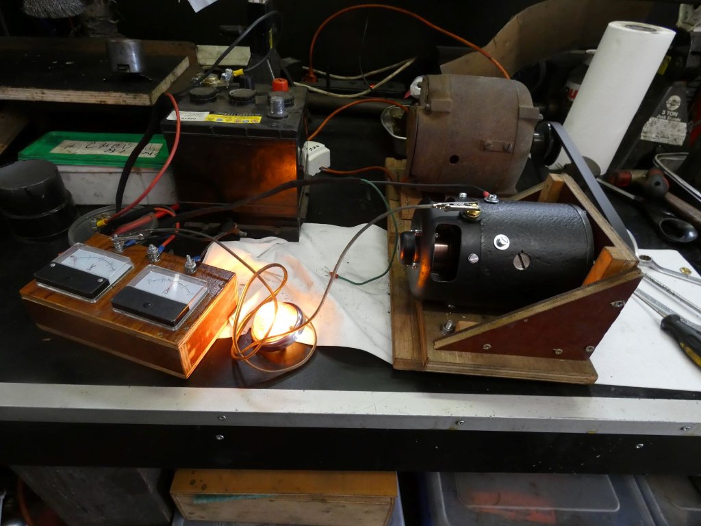

As I rebuild a generator, the first test I do is make it run with only a 12V 10W test light connected between the generator post and the generator body.
