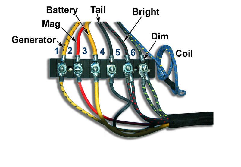

Would it be possible to run a car without an ammeter?
How would you configure the wiring if possible?

Yes, you can
the generator must have it's output grounded
the battery wire would go directly to the BAT position via the barrier strip

The two wires that attach to the factory meter are either jumped, or both wires an on one meter terminal.

So the striped yellow and the plain yellow would go on the same position on the junction block?

Yes. Just think of the ammeter as having a wire between its to posts. So all you need to do is remove the wire from the ammeter to the BAT position on the ignition switch and then disconnect the other wire on the ammeter and connect it to the BAT position on the ammeter. Click on the image to enlarge it

2. Simply add a jumper wire across the ammeter terminals.
3. WHY? Not a good idea! You'd have no indicator as to impeding electrical problems, like fires maybe... Wire the car as it's meant to be wired. It ain't so difficult.

An ammeter has to be placed in the line from the generator to the battery to measure the amount of electrical current being sent to the battery.
To run without an ammeter, one only has to remove those two wires from the ammeter and fasten them together with a splice.
