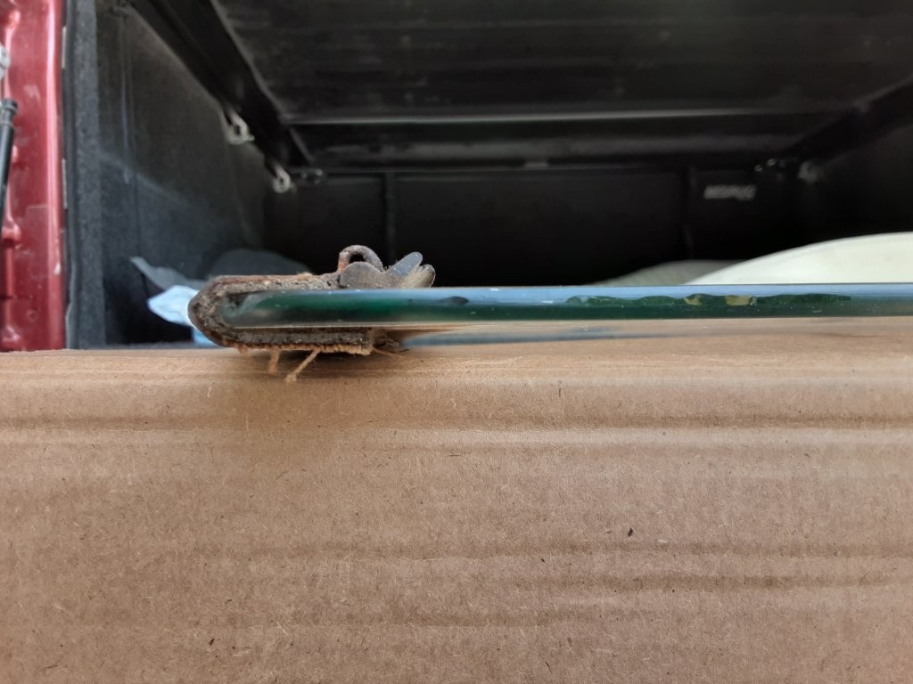

Bruce Brakke is restoring what was an all original 1927 Coupe and is doing a great job. Several weeks ago, he posted a photo showing a cross section of his original door window glass. As you can see, there is a rubber piece of rubber moulding that, when the window is rolled up, prevents rain from flowing down into the window. This rubber moulding would provide enough tightness to keep the glass in the channel. Jim Patrick

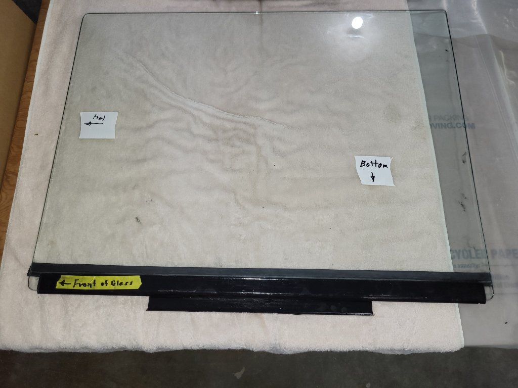

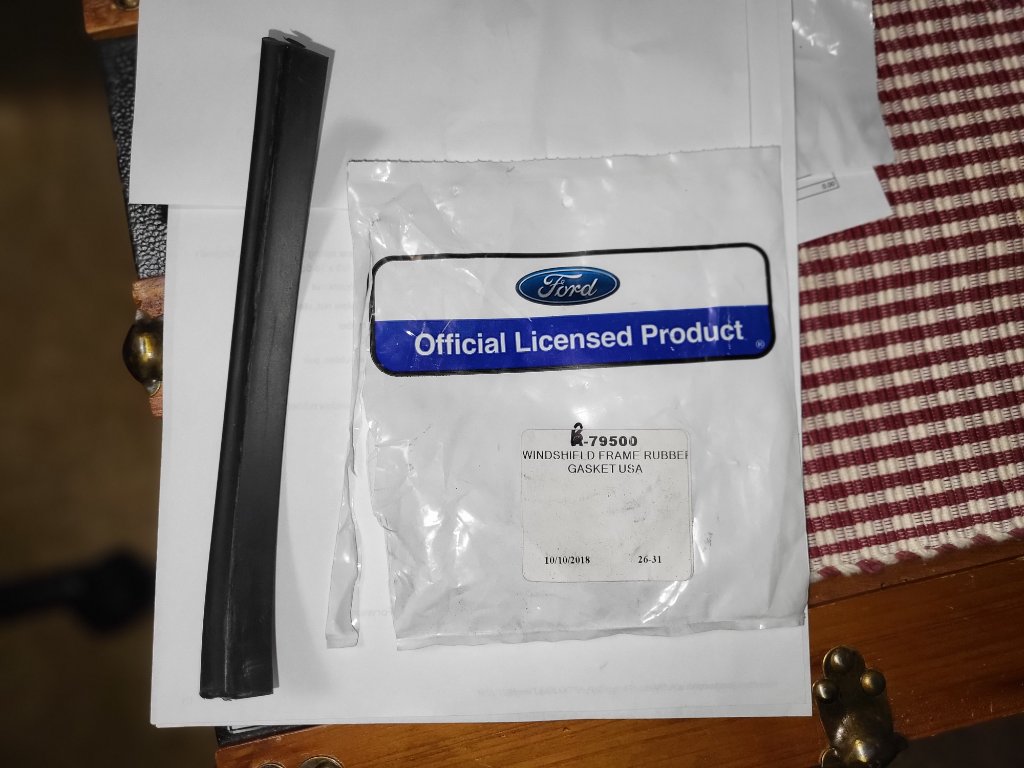

The attached photos show how the metal channel is fitted to the bottom of my 1927 coupe door glass. The original is also shown.
The bedding material is rubber to which oil is added to get it to swell once in place.
The seal piece is A-79500.
