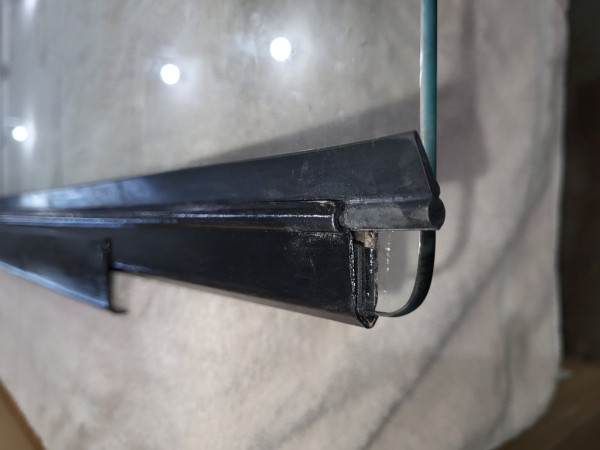

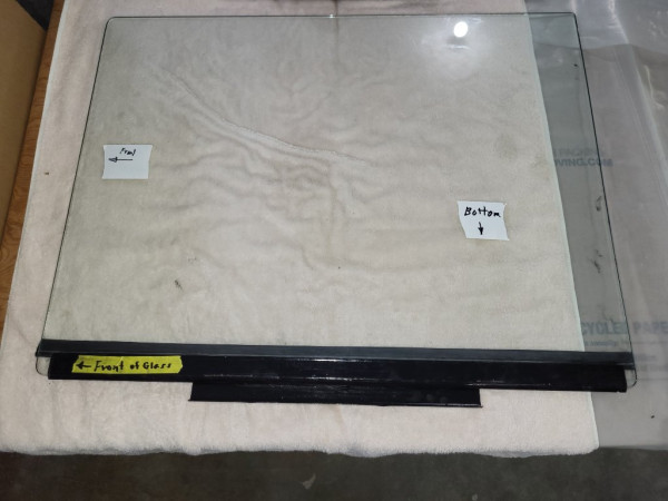

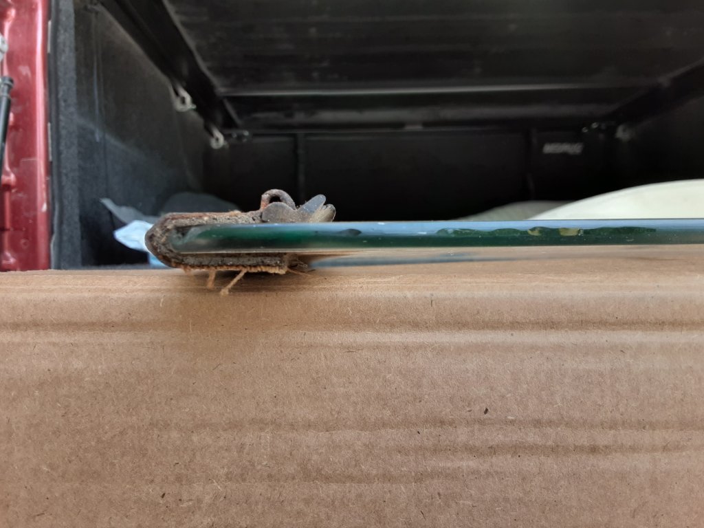

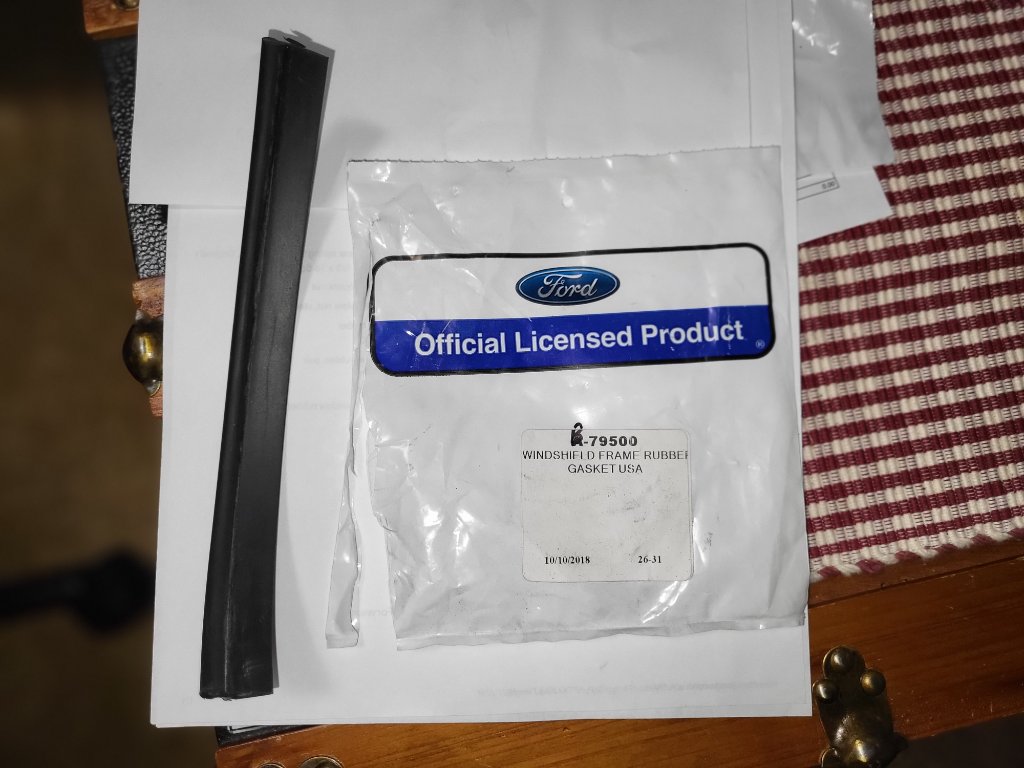

Re: 27 Coupe door glass install
The attached photos show how the metal channel is fitted to the bottom of my 1927 coupe door glass. The original is also shown.
The bedding material is rubber to which oil is added to get it to swell once in place.
The seal piece is A-79500.
