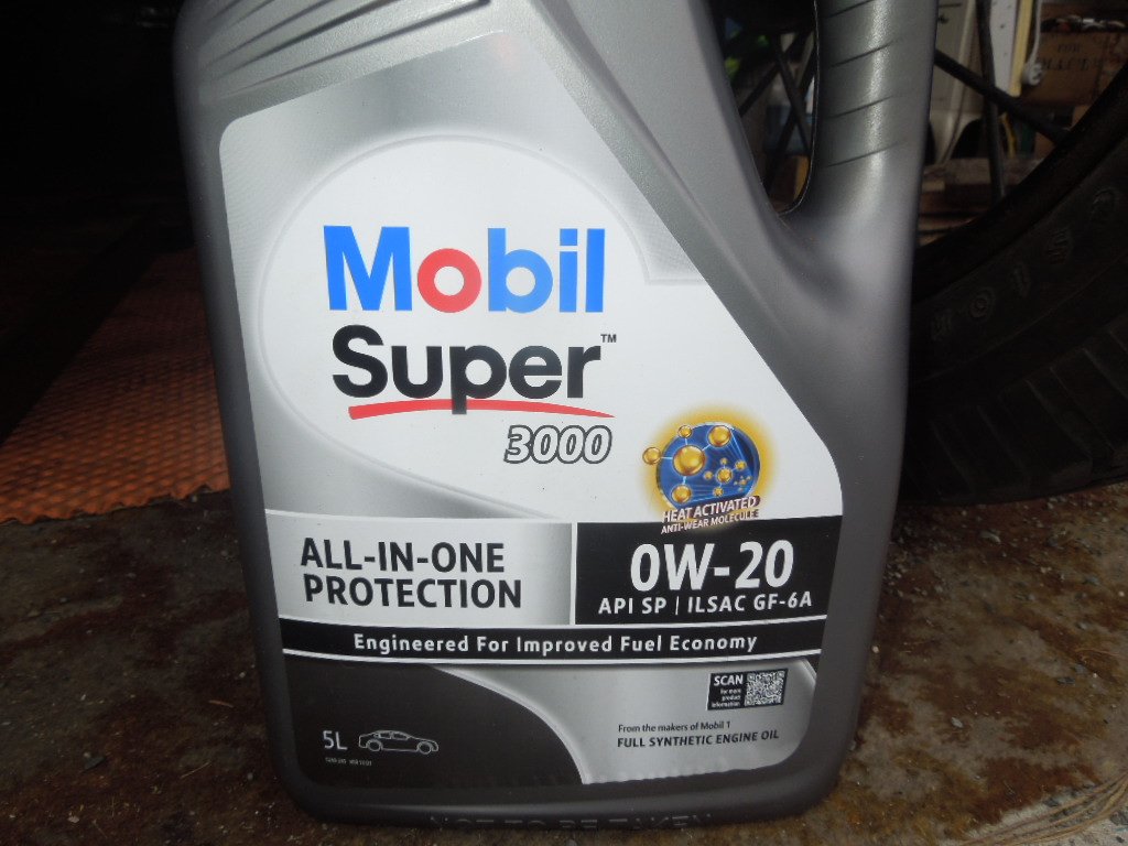

Follow up to an earlier post - One of my T's is very stiff when turning over cold, impossible by hand and starter also struggles. Even parked after 4 hours it has to be jacked up to get it started. PLUS it has to run for over 5 mins jacked up before I can use foot brake or handbrake without engine stalling. In other words its a 10 mins job to start cold. Some people have a similar issue but it clears quickly once engine is started.
This engine/trans was in another of my T's which I hardly used and has been like this since I got it about 7 years ago. I have swapped the running gear into one of my T's I use most days so was keen to sort it out.
I had the Hogs head off to change brake band, after that no difference.
Oil (20/50) was clean already but I changed it, No difference.
Parked over night with handbrake on, No difference.
Drove a few test drives getting it up to temp but still the same problem every day.
Yesterday I drained the clean oil out and replaced it with this oil. Went for a 10 mile run to get the oil splashed about and to ensure the brakes/reverse etc worked correctly (and they do) and this morning the problem has gone away.
Handbrake on, all 4 wheels on floor, 2 cranks to prime it then key on and fired up first crank.
I'm sure some will say you shouldn't use this oil .
download/file.php?mode=view&id=138852

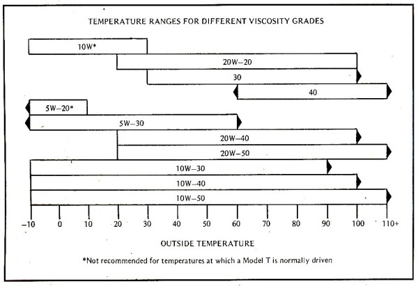

Post by Steve Jelf » Sun Aug 21, 2022 10:58 pm
I suspect that my famous rod failure may have been at least partly due to my mistaken use of 5W-20 oil, which is NOT the same as the old 20W that Ford recommended. I would much rather jack up a wheel to start than pay for more premature engine surgery, so I'm using the 15W-40 recommended by a well-known rebuilder I asked about oil.

Yes Robert it has always been parked with the lever forward but I thought I would try leaving it back after a run to see if it would stay fee, no difference.
I'm happy with the result, the way it stood it was almost unusable and might have needed a pull down to rectify. Maybe over time it will still need the same pulldown and if what some of you are saying it will need even more work to repair potential damage, only time will tell.
I dont think it will and I predict it will still be running fine in years to come. If I remember I'll post an update each year.

Like I said, time will tell. In the meantime I now have a car I can start quickly hot or cold with all 4 feet on the ground...perfect!

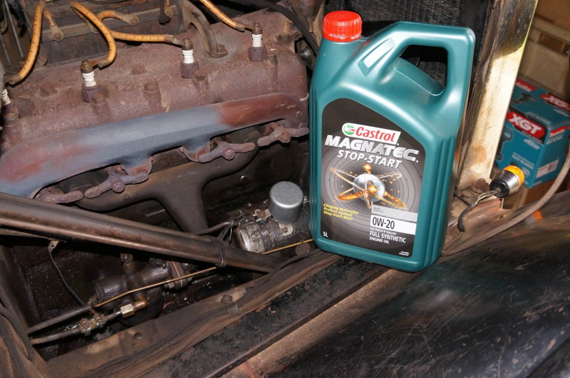

0W20 is hideously expensive; (nearly $70 for 5 litres) but I'm going to give it a go. (Due for an oil change anyway). I just don't believe there's a mechanical issue with my clutch either, since it's a 26 with lug shoes, and it's a low mileage car. It's purely a winter problem. In summer it will start without jacking up the back wheel on the 3rd crank.

JohnH - I got mine from Supercheap auto when it was on special for about $50. I used exactly 3 litres which took it just under the top petcock.
A 5L pack, so I still have 2L for the next change.
But if I knew how successful it was going to be price wouldn't have stopped me even if it was $100.
Like TXG suggests perhaps I could move to a 10w down the track if that is cheaper. I could always go back to 0w if it didn't work as well.
One other thing I noticed which I didn't post was I believe the motor ran better on this oil. I took the car for a long drive to warm up before I drained the nearly new 20-50. Then drove the exact same route with the new Synthetic 0w-20 in an hour later and I am sure it ran nicer and just felt smoother to drive.
Let us know if you try it John, I remember your comment on my original post that you had a similar issue and that's one reason why I updated, hoping you would read it.

I did the oil change today and put in 3L of 0W20. There's a lot for me to think about now given the change in performance.
After I drained the old 20W50 out, I cranked the engine by hand just to remind myself how much clutch drag there is. After putting in the 0W20, I started using the starter motor with the back wheel jacked up as always. Straight away, the starting was much more lively - sluggish drag gone. In fact, it was an unusually easy start. (The big test is of course if it will start as easily with the back wheels on the ground).
Then I went for a 12km drive. The throttle is more responsive - it's just like everything is so much freer. In fact, it's a bizarre feeling seeing such a change in how it runs and drives. Even if the clutch doesn't free up, just this improvement is enough to justify the cost of the 0W20.
Tomorrow, after it's all cooled down I'll take it out again and see if there's any improvement to the clutch drag.
But after that excitement, I have to come back down to earth and think about a lot of things. The 0W20 is thin, and flows easily compared to 20W50. The bands and high speed clutch did not slip, so the oil is OK in that regard. Neither does the engine blow any smoke, so all OK there too. My one and only concern is the bearings and if it's safe to use 0W20 full time, or just to clean out the gummy clutch, and then put something thicker back in.
I have to say up to this point I've always used 20W50 because I've never had any bearing problems, and I do clock up the km's on my car. Also, I've always run it with the oil to the top petcock just to be sure. Perhaps I need to rethink all this.

This is very interesting. I'll try some out in my car at the Australian Nationals in Dubbo next month.
I see Supercheap Auto has Mobil Super 3000 0W-20 5 litres on special at the moment for $51.69.

The oil chart from the MTFCA engine book indicates that 5W-20 is not the same as Ford's recommended 20 weight, and is not recommended for Model T use. Is it wrong?

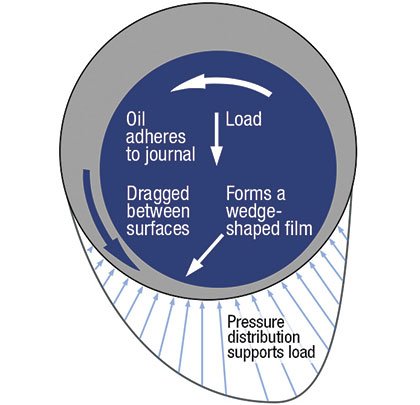

Post by Kerry » Mon Aug 29, 2022 5:34 pm
The debate is mostly based on one side by opinion and not the understanding of today's oil in old design bearings.
First, a splash bearing relies 100% on hydrodynamic lubrication, meaning that shaft to bearing pressurizes the oil in a wedge between the faces.
Now the oil, A multi grade oils does not get thicker as it gets to operating temp. all oils thin with heat but a multi grade formulated with additives to act like it's thicker under pressure, a higher viscosity oil has been measured to get up to 600+ PSI in a hydrodynamic lubrication system.
Now a 0W starting point, an oil that is designed to move fast for modern engine specs which can be less than 1/2 of a run in model T.
For a 0W-20 to get the oil to act like the 20 it must get to operating temp to do so. A O oil will have trouble to be able to float the bearing surface from the shaft to create the hydrodynamic pressure required, it's thin and simply is just pushed out of T bearing clearances, it needs to get hot to get close to a 20 to do any good.
So by engineering standards the 0w oil on a cold engine splash system is running metal to metal until it's able to generate enough heat to lift it's viscosity. So Henry had it right , a 20 to work from a first start.
