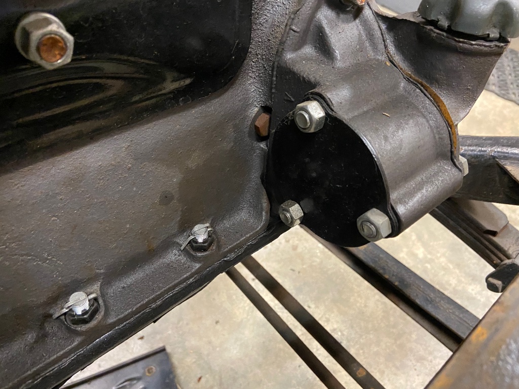

I am working on a 1924 Touring I have questions about. The engine has a starter but no generator, just a block off plate where the generator would mount. Is that correct? It has electric headlights and oil cowl lamps if that matters. Should it have a generator and if not can one be added? Art

If it has a block off plate, it should be no problem to install a generator and cutout. Be sure to use the correct bolts. The headlights and horn could be 6 volt or they could be magneto lights. If the car has a plastic or fiber timing gear, it would be a good idea to replace it with a metal one. If the car never had a generator, some wiring changes/additions may be necessary and the magneto lights and horn would need to be replaced with 6 volt items if you want to run the lights, etc, and charge the battery off the generator rather than the magneto.

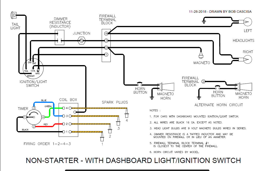

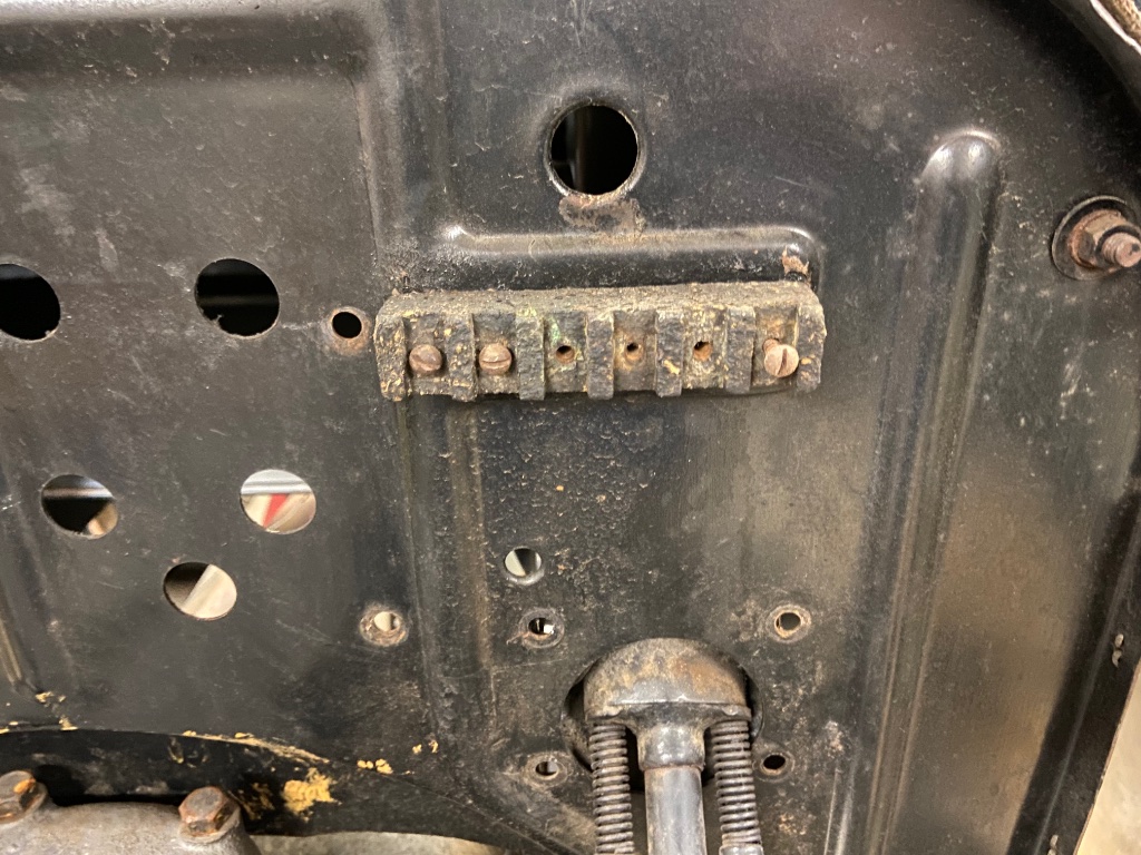

The terminal block on the firewall would have 5 connectors if it never had a generator with a generator it would have 6 connectors

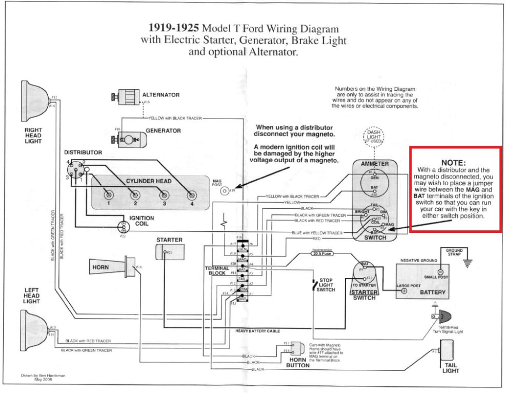

Many T owners have a starter and motorcycle battery for ease of starting (no cranking). Coils can run on battery or magneto, same is true for lights. How long they can run all depends on the Ah of the battery and how you consume its energy. The generator is useful to power lights and maintain battery voltage for longer usage time.
The point about the wiring is important , magneto or incandescent bulb that is the question. Magneto bulbs are wired in series and incandescent in parallel. see diagrams. A simple way to id your wiring is if you have an ammeter or dimmer. Note the generator just has a simple entry point into the electric circuit.

Add a picture of your terminal block on the firewall and your ignition switch. They will tell a lot. If you look at the wiring diagram a magneto horn is wired to the terminal block where the magneto wire is also wired. A battery horn is connected to the terminal block where where the battery wire is connectedArt Ebeling wrote: ↑Fri Oct 28, 2022 9:28 pmI would like to add a generator to this car. I'm going to need a generator and cutout to do that. How would I tell the difference between a 6 volt or magneto horn and lights?TXGOAT2 wrote: ↑Fri Oct 28, 2022 7:23 pmIf it has a block off plate, it should be no problem to install a generator and cutout. Be sure to use the correct bolts. The headlights and horn could be 6 volt or they could be magneto lights. If the car has a plastic or fiber timing gear, it would be a good idea to replace it with a metal one. If the car never had a generator, some wiring changes/additions may be necessary and the magneto lights and horn would need to be replaced with 6 volt items if you want to run the lights, etc, and charge the battery off the generator rather than the magneto.

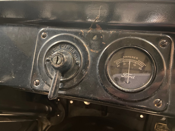

Ammeter on the switch plate indicates it should have a starter and generator.

I have removed and installed my generator without removing the radiator, but the bolts were already present and of the correct type. Another note: It may be necessary to adjust the generator pinion gear mesh when you install a generator. That is done, if needed, by adding or removing gasket shims from the generator to timing case mount to obtain the correct gear clearance. (See Ford Service book) NEVER run the engine without the generator either being connected properly, or grounded.

The terminal block looks original and indicates that the car originally had a generator.
It most likely has 6 volt lights, horn, and wiring. If the wiring is not present, or to be replaced, choose wiring for an "electric" car, which will have the correct wiring for the generator, ammeter, terminal block, lighting, etc. The ammeter you have will work fine with a generator, as will the starter.

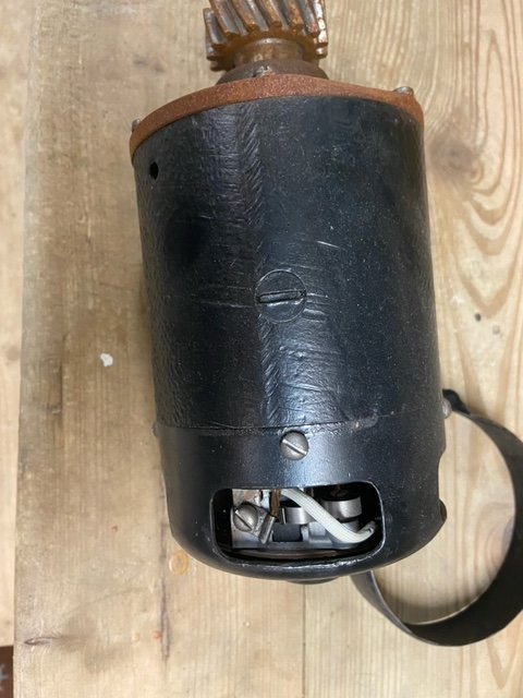

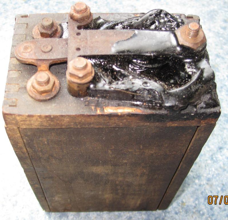

This falls under the "look with your eyes and not your lips catagory". This was in one of several boxes of parts that came with the car. Art
- Posts: 3743
- Last Name: Wrenn
Re: 1924 No generator
Almost looks like it could be "new", i.e. never used? Give it a try!
- Posts: 7401
We've already deducted that you probably have a battery horn. But you can confirm that with a peek into the business end. If there's an adjusting screw in the center of the diaphragm it's a magneto horn. If the diaphragm doesn't have an adjusting screw in the center it's a battery horn.
- Posts: 8497

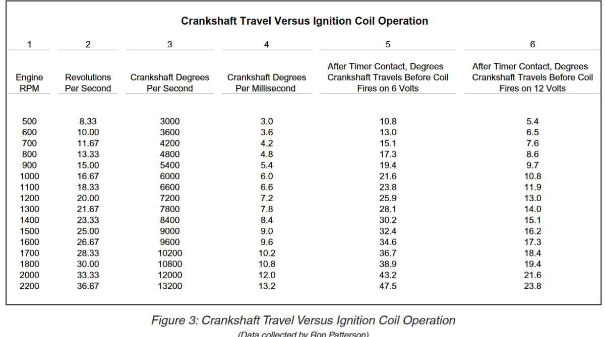

The chart above shows clearly why Model Ts perform better running on a good mag. You get a good spark and semi-automatic timing adjustment. Probably easier on timer and points, too.
- Posts: 5510
Ok Art, looking with my eyes; the screws holding the end plate on are wrong.
