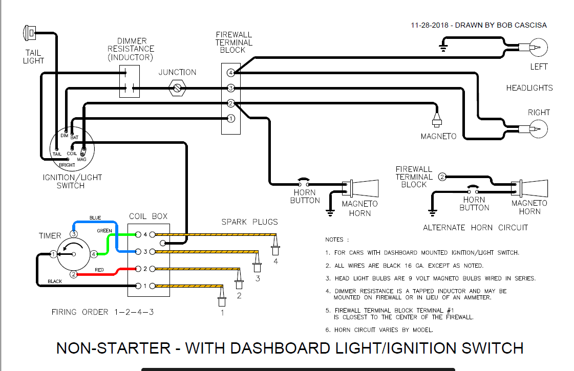

Many T owners have a starter and motorcycle battery for ease of starting (no cranking). Coils can run on battery or magneto, same is true for lights. How long they can run all depends on the Ah of the battery and how you consume its energy. The generator is useful to power lights and maintain battery voltage for longer usage time.
The point about the wiring is important , magneto or incandescent bulb that is the question. Magneto bulbs are wired in series and incandescent in parallel. see diagrams. A simple way to id your wiring is if you have an ammeter or dimmer. Note the generator just has a simple entry point into the electric circuit.

Add a picture of your terminal block on the firewall and your ignition switch. They will tell a lot. If you look at the wiring diagram a magneto horn is wired to the terminal block where the magneto wire is also wired. A battery horn is connected to the terminal block where where the battery wire is connected

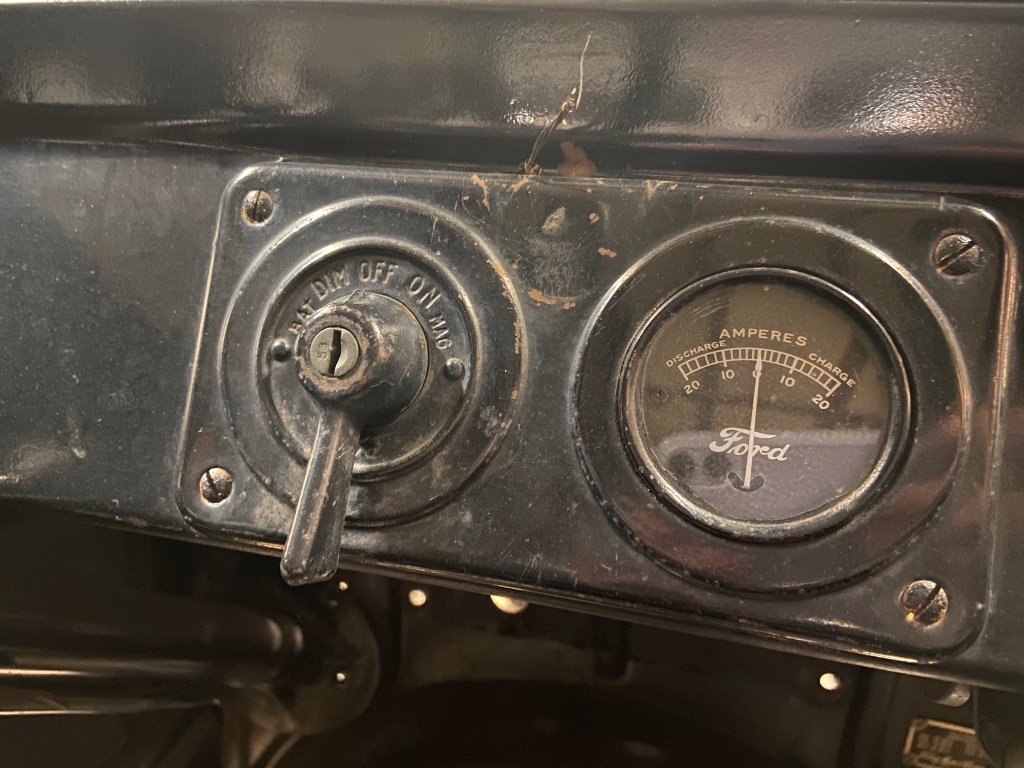

Here are pictures of what I am working with. Art

Post by Humblej » Sat Oct 29, 2022 8:56 am
Ammeter on the switch plate indicates it should have a starter and generator.

The terminal block looks original and indicates that the car originally had a generator.
It most likely has 6 volt lights, horn, and wiring. If the wiring is not present, or to be replaced, choose wiring for an "electric" car, which will have the correct wiring for the generator, ammeter, terminal block, lighting, etc. The ammeter you have will work fine with a generator, as will the starter.
