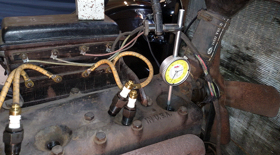

Is this overkill?
- Posts: 6732
Re: Is this overkill?
...your title: yeah, pretty much
How does piston movement get transferred to the indicator?

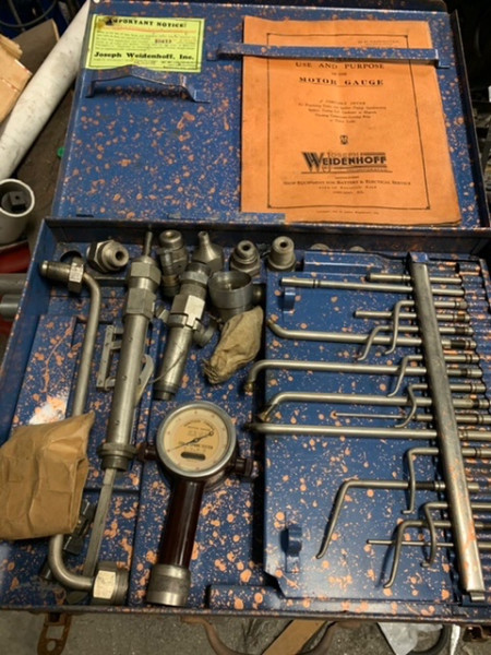

- Posts: 5433
- Last Name: Hatch
- Location: Alabama
Here is the old school way from back in the day.
Looks like the shaft the indicator is mounted to rises up and down with the piston.
… except that the piston isn’t straight under the spark plug hole…

- Posts: 6732
use some imagination, Miles
I’d rather just use a plastic drinking straw. Fortunately I live in a state where they’re still allowed….

- Posts: 6732
the amazing thing is, with a micrometer, 6" screwdriver, or a plastic straw, the crank pin is horizontal in every case. That 'ol Henry was a genius.
I’m thinking rev2 should have a whistle in the indicator shaft to announce compression!
Mark, I’m. Not the sharpest knife in the drawer and my eyes aren’t as good as they used to be so I find “horizontal” sort of an arbitrary value to time an engine by. I built this contraption in an hour or so and the cost was about ten bucks for material. It doesn’t show me approximately where TDC is, but precisely. I was joking about the whistle but found some on eBay for about two bucks each and am going to get some just for fun. The next step will be to get some magnetic strips printed to stick onto the crank pulley so I can align them at TDC, advance the spark fully, and check the “full advance” timing as well. I will have one strip for 3” pulley and another for 3 1/2”. I know it’s not necessary but it keeps me out of the bars and bingo halls.
- Posts: 6732
If you find horizontal (9-3) "arbitrary", you're going to absolutely love 15 degrees ATDC...(9:30-3:30)
That is where your timing is set at.
It occurs to me that 15 degrees after TDC can’t be ascertained unless TDC can be confirmed. I’m just not as handy as you are so I need to provide myself with a helper. I guess I’m still a novice having only seven Model T’s for about thirty years, but I’m willing to learn.
- Posts: 6732
David
I'm not trying to be condescending!
For everyone else who may not have lots of experience on model "T"s: On a Model T engine, any time, the crank pin is horizontal, 1 piston is at TDC compression and 1 piston is at TDC exhaust. It doesn't matter which one it is, really. Scootch the engine a bit past TDC to 15 degrees past and SOME coil is going to buzz, and THAT's the cylinder that is just past TDC on compression. And at that setting, if SOMETHING isn't buzzing, then adjust the timer until it JUST does, and adjust your spark rod to make the timer attain that setting. And seriously, it is at 15 degrees past TDC where timing is set...not TDC. Even if you have just one Model T. Or seven.
Scott, You don’t have to try to be condescending, it’s a gift. I know exactly what you are saying. By the way, I have twenty or thirty Fordson model F tractors and they time the same way.
- Posts: 6732
David
wow.
with 30 or 40 tractors and 7 Model T's I'm surprised you're having this much trouble establishing what "horizontal" is. I honestly thought I'd be able to offer some help, but it is clear that I cannot, or at least you don't want it. Had I known I'd be bludgeoned with your immense count of vehicles, and the wealth of knowledge that apparently confers, I'd never have offered.

- Posts: 7401
For those preferring the clock analogy, at 15º past TDC Mickey's big hand is pointing between 3 and 4.

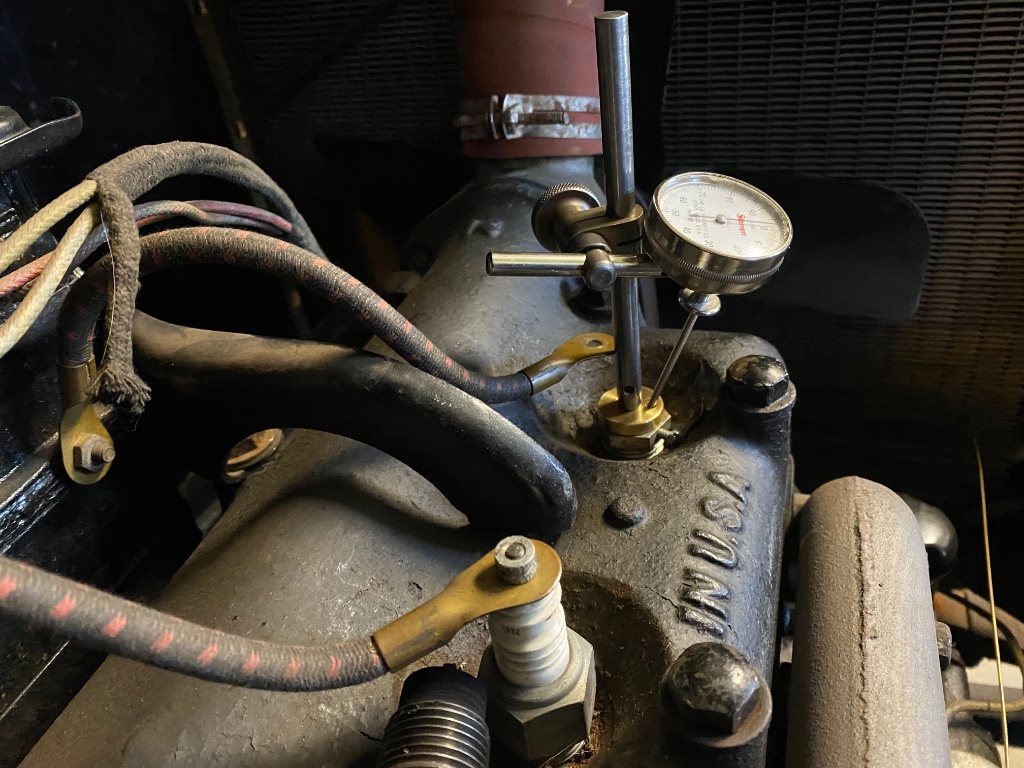

I made an offset tip for this dial that looks like the offset extensions in Dan Hatch's first photo. I used it to find TDC. Then I continued to turn the crank until the reading went down .087". That is 15 degrees. If you prefer to use the 15.5 degree method, the drop is .093". These measurements will only work with stock crank stroke and rod length.

- Posts: 5510
You asked if it was over kill, we gave our opinions.
