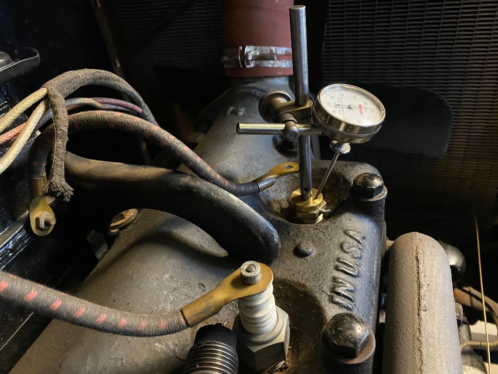

Is this overkill?
Post by browning » Sun Dec 04, 2022 4:08 pm
Timing device

Post by Scott_Conger » Sun Dec 04, 2022 4:12 pm
...your title: yeah, pretty much ;)

Re: Is this overkill?
Post by mbowen » Sun Dec 04, 2022 4:15 pm
How does piston movement get transferred to the indicator?

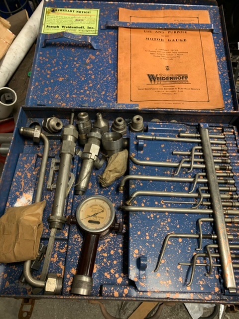

Post by Dan Hatch » Sun Dec 04, 2022 4:22 pm
Here is the old school way from back in the day.
Post by Tourabout » Sun Dec 04, 2022 4:33 pm
Looks like the shaft the indicator is mounted to rises up and down with the piston.
Post by mbowen » Sun Dec 04, 2022 4:35 pm
… except that the piston isn’t straight under the spark plug hole…

Posts: 6789
Post by Scott_Conger » Sun Dec 04, 2022 4:40 pm
use some imagination, Miles ;) :D
Post by greenacres36 » Sun Dec 04, 2022 4:48 pm
Absolutely not overkill. I like it.
Post by mbowen » Sun Dec 04, 2022 4:49 pm
use some imagination, Miles ;) :D :D
I’d rather just use a plastic drinking straw. Fortunately I live in a state where they’re still allowed…. :D

Posts: 6789
Post by Scott_Conger » Sun Dec 04, 2022 5:00 pm
the amazing thing is, with a micrometer, 6" screwdriver, or a plastic straw, the crank pin is horizontal in every case. That 'ol Henry was a genius. :lol:
Post by Dan Hatch » Sun Dec 04, 2022 5:15 pm
Here is the manual.
Post by browning » Sun Dec 04, 2022 5:31 pm
I’m thinking rev2 should have a whistle in the indicator shaft to announce compression!
Posts: 6789
Post by Scott_Conger » Sun Dec 04, 2022 5:54 pm
Rube would be proud!
Post by BUSHMIKE » Sun Dec 04, 2022 6:07 pm
They were commonly used on aircraft timing.
Post by browning » Sun Dec 04, 2022 6:18 pm
I didn’t know Rube (my hero) was an aircraft mechanic.
Post by Mark Gregush » Sun Dec 04, 2022 8:14 pm
As long as it does not kickback when using the starter, moving the lever on the quadrant will render all the work moot. :twisted: The pulley pin when horizontal is top dead center from there turn 12-16 degrees to first impulse from the magneto (approx) for stem winders or just after the pistons rolls over TDC and just starts to drop for the rest of us mere mortals with electric starter. ;)
Nice work.

Post by browning » Sun Dec 04, 2022 9:24 pm
Mark, I’m. Not the sharpest knife in the drawer and my eyes aren’t as good as they used to be so I find “horizontal” sort of an arbitrary value to time an engine by. I built this contraption in an hour or so and the cost was about ten bucks for material. It doesn’t show me approximately where TDC is, but precisely. I was joking about the whistle but found some on eBay for about two bucks each and am going to get some just for fun. The next step will be to get some magnetic strips printed to stick onto the crank pulley so I can align them at TDC, advance the spark fully, and check the “full advance” timing as well. I will have one strip for 3” pulley and another for 3 1/2”. I know it’s not necessary but it keeps me out of the bars and bingo halls.

Post by Scott_Conger » Sun Dec 04, 2022 9:38 pm
If you find horizontal (9-3) "arbitrary", you're going to absolutely love 15 degrees ATDC...(9:30-3:30)
That is where your timing is set at.
And don't get your panties in a wad over it being #1. Anytime the hand crank pin is horizontal, SOMEONE is at TDC and it doesn't matter who, as you continue to turn to 15 ATDC. That's where the timer, timer rod bending, and spark lever are all set to. Again...not TDC.
