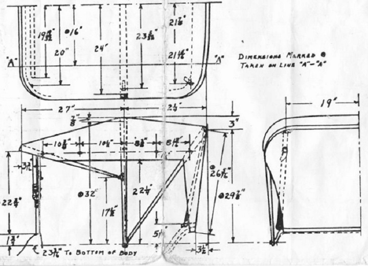

This Roadster top schematic may give you an idea. You can take a measurement from the back to front of your Roadster body and compare with the measurement on this one to see if it’s the correct body that’s shown. Some MTFCA posts have this pictured from 14-17 and some later. The low cowl T bodies for Roadsters are close to the same as far as body wood structure goes. There are some differences but not a lot.

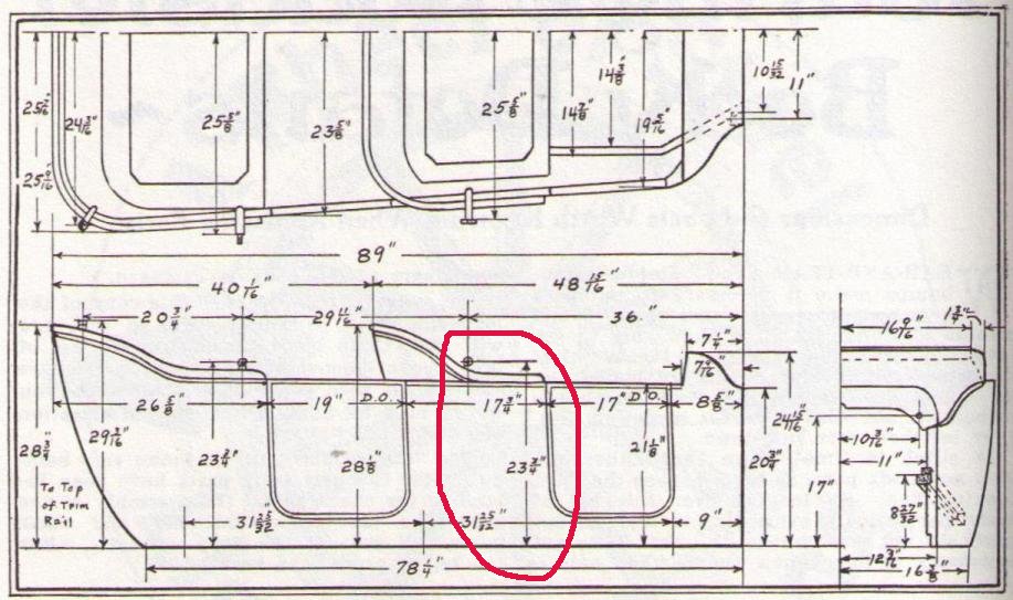

Is this the dimension you are looking for?
http://www.mtfca.com/discus/messages/25 ... 1335141932
It says it's for a '15 Touring but I think it would be the same.

The body's top mounting iron's position is different on a roadster/runabout than it is for the front on a touring car. The touring car's is near the back of the front seat, whereas the runabout's is near the front of the front seat arm rest. This is necessary for the rear socket/bow to have a "rest" for it to sit into, and for the socket/bow to angle back like it does.
A later 1910s runabout, but the top placement is the same.

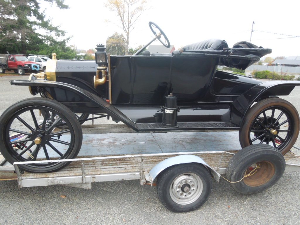

Maybe this is some help. It is how I did my '14 Touring.
Not the right irons. I made do.When did I do that?

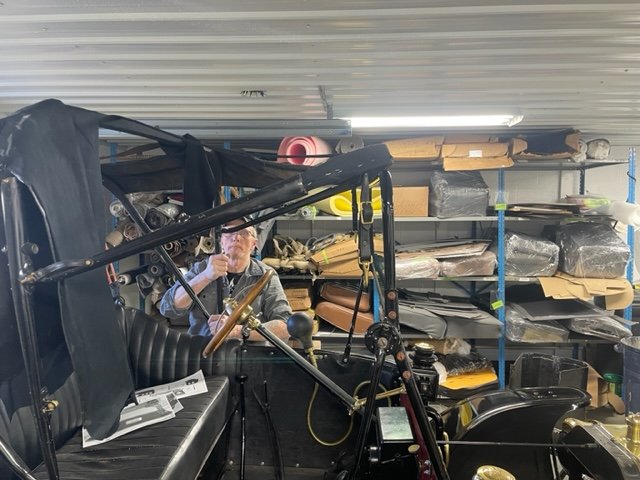

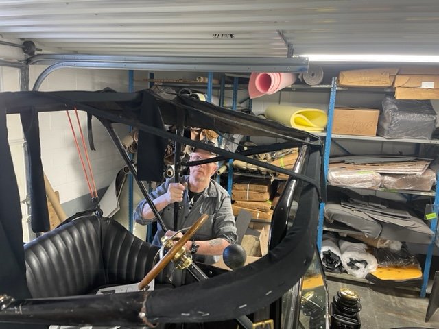

Scott, therein lies my problem. On this '14 that we are working on, if the center bow is set at vertical we can barely get the front bow to extend past the windshield without it rubbing. Now I am almost wondering if this front bow is incorrect??
Notice in the factory image and the 'gas company car' images just how much clearance is between the top of the windshield frame and the backside of the front bow. This set of bows does not have that amount of latitude which makes me believe these bows were either homemade incorrectly, -or possibly something like the ends where they entered the sockets was deteriorated so the previous 'restorer' just cut-off a little from the very end and jammed the shortened bow back into the socket.

Re: Roadster top irons..
Ohh jeez, I hope we don't get in trouble for hi-jacking Dave's thread.Wayne Sheldon wrote: ↑Wed Dec 28, 2022 10:18 pmNo Brent, no worries. You were fine! I should apologize to you. I saw an opportunity to clarify some language that is all too often misused by many people! Sometimes I go to make a quick comment about something and the next thing I know it is a page long!
Did anything ever come about from that early friction drive chassis you were researching a few years ago? It was interesting. I find myself often wonder what became of it.
As to that car, I own it by default, ...but I don't have a clue what it is -nor does anyone else it seems. I would restore and tour with it but again, it had some cobbled up wagon body on it and so there is not much to go on to identify it. The irony was several people suggested the vehicle was likely just something that was a made-up vehicle for a movie or as a prop car in the 50s or 60. I was about to agree with them as I had no clue either, Then after the owner had passed and the estate was trying to be settled, some pix were found that are either the prototype of this vehicle, -or they ARE of this vehicle I have but with the wheels changed. That kinda blew the theory of a prop car to the naysayers. My wild guess is that likely it was an assembled car from the 1908, 09, 10-ish era that the 'assembler' used to try to raise investor funding for an automobile manufacturer start-up. Likely didn't make it too far into production though. Kinda hard to register it with the DMV or HCCA when you don't have a Make or even a year of manufacture to list.
- Posts: 632
- Last Name: Mills
Brent, One more thought to add...
What would it be like on the Roadster top if you set the center bow true vertical...then taped a 2x2 extended and parallel on the top windshield frame...then let the front bow settle on the 2x and adjust the top straps/pads length accordingly to the rear bow placed and jigged at the drawing dimensions shown?
That's how I do it and then set the D rings at the back secondarily. Then remove the 2x
Then when you put the cover on with a tug to just cause the front to start to want to lift, stop...tight enough and stop. Then the leather straps in front will add just enough tension to keep everyone happy?
(I am guessing that you already know that the tacks on the back bow only get nailed in 1/2-way until you get the Goldilocks solution both on the rear curtain and top and only then seat the tacks?)
- Posts: 445
- Joined: Mon Jan 07, 2019 11:21 am
- First Name: Brent
- Last Name: Terry
- * REQUIRED* Type and Year of Model Ts owned: 1909 Tourabout, 1914 Runabout, 1915 Touring, 1916 Speedster, 1925 Speedster, 1926 Hack
- Location: Eastern Tennessee
George Mills wrote: ↑Thu Dec 29, 2022 8:33 amBrent, One more thought to add...
You're pretty much on it George. Thanks!! Something that has worked for us in the past is using motorcycle straps around the center bow and fastened overhead to the ceiling. Actually, I think we have used the garage door roller rails to anchor to. With slight tension on the straps, this holds the center bow & socket vertical so you can place the other bows. Then a long wood ruler is clamped along each side from the rear socket up to the front using clamps. Instead of using tape, we typically use those cheap Harbor Freight plastic pistol-grip clamps only because they are re-adjustable many times over as you are trying to position everything. Just quick release and re-squeeze. What we have done in the past is use those same clamps on the windshield glass and let the excess tail of the clamp support the front bow.
