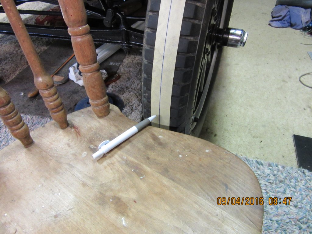

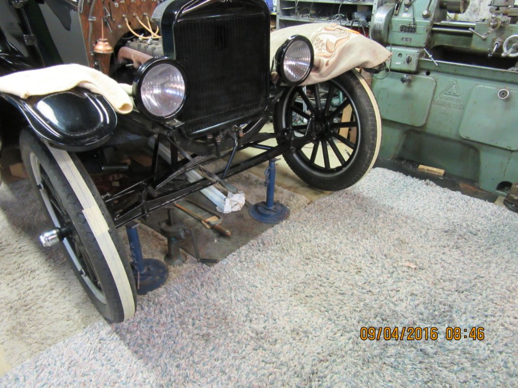

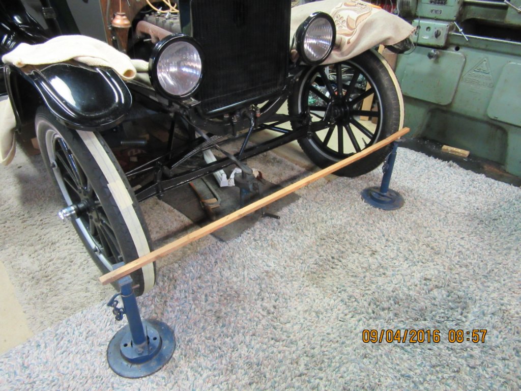

ABoer
Posts: 232
Joined: Mon Jan 07, 2019 2:41 pm
First Name: Anthonie
Last Name: Boer
* REQUIRED* Type and Year of Model Ts owned: 1912 touring 1923 roadster 1925 pickup
Location: Klaaswaal NL
Re: Wheel Alignment on a 1915 Touring
Post by ABoer » Thu Dec 29, 2022 7:32 am
I do it this way , no problem with sideways run out .
Toon
Posts: 4292
Post by Jerry VanOoteghem » Thu Dec 29, 2022 8:15 am
I do it this way , no problem with sideways run out .IMG_0093.JPGIMG_0094.JPGIMG_0095.JPG
Toon
This is the best method, (in my opinion). Notice that the dimensions are taken with the front wheels back on the ground. I would even roll the car ahead a few feet before measuring.
