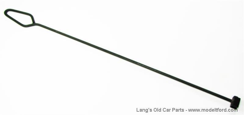

Re: Anyone use an Akuret oil gauge?
I scored an older version of the dipstick Lang's carries. No hole in the splash apron. http://www.modeltford.com/item/3079DS.aspx

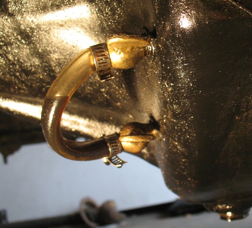

Important to find out if the full mark is same level as the upper petcock. If not, be sure to mark the correct level.
I can open the petcocks without crawling under. I get on my knees and face the front of the car and reach under with my left hand. to turn them. Another popular gauge is the glass one. However it is easy to have it turn from vibrations or to get bumped and broken. Then the oil runs out as you drive, so I don't use that type.

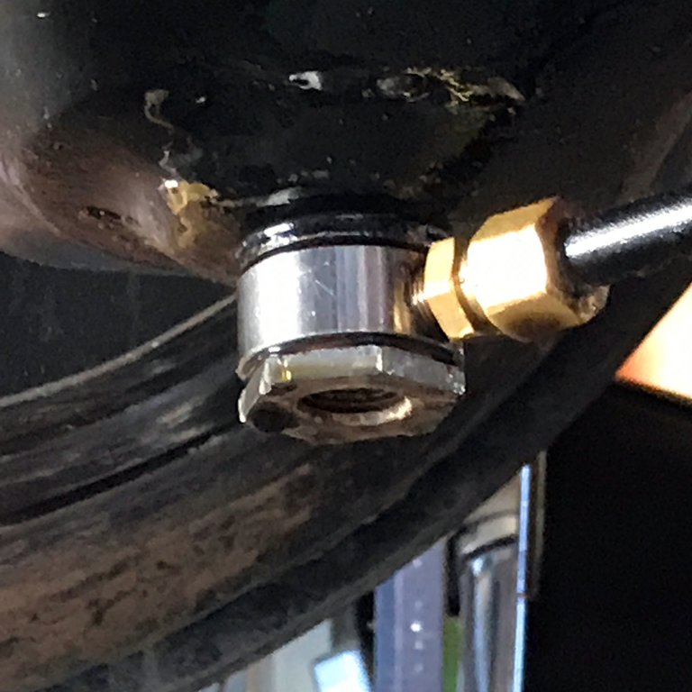

I prefer an actual dipstick. I purchased an "Advantage Dipstick" from the folks at Antique Auto Ranch in Spokane that replaces the oil pan drain plug with a fitting that allows you to read oil level down to zero....popular with the Montana 500 crowd. No new holes required. After seeing mine, several guys in my club bought them as well.

I avoid crawling under by using my homemade version of this T era accessory.
My oil sight gauge is a short bit of plastic tubing. If the level goes below half full I add a quart.
Morgan, I mapped the position for the hole on my wide body roadster by making a template from the original badly rusted splash apron. How could that go wrong? Easily as it turns out, due to differences in the angle of the thread in the pan and the brass fitting on the dipstick. DO NOT try to bend the brass fitting to align the tube with the hole! Don't ask how I found this to be a bad idea.
The solution I found was to use two right angle unions at the base of the tube. This allows any difference in orientation to be corrected by adjusting one or both of the unions to align the tube.
Being an original accessory, often sold by Duncan and Fraser, I had no qualms about drilling the hole to refit item.
