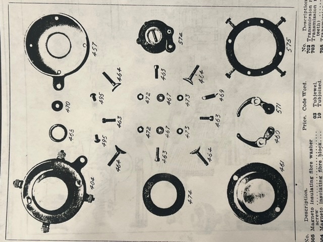

Is anyone reproducing the timers for the early Model T's like in the picture?
David - Yukon, OK
