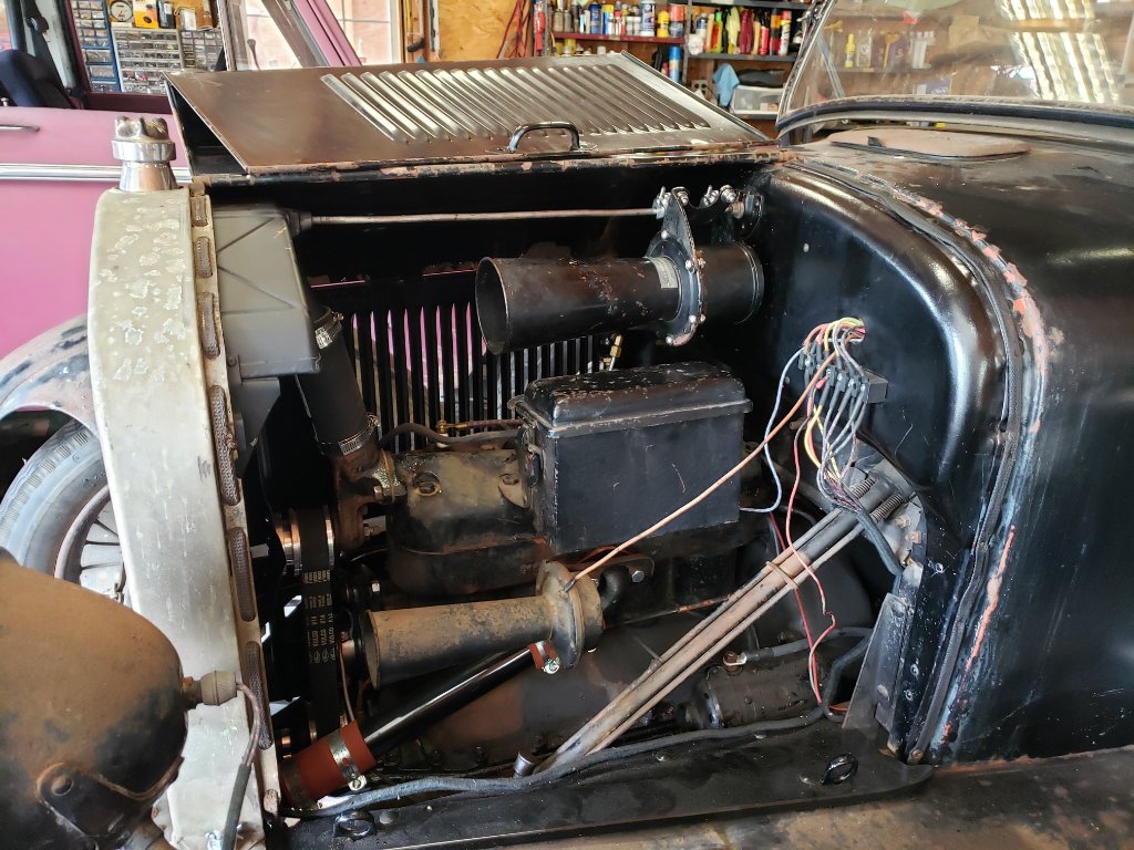

Horn will not fit inside 1926 Coupe hood after installing a water pump
Sprucing up an older engine and am putting a water pump on it. There are threaded holes to mount the horn bracket but when I mount the horn it is
now not inside of the hood. Does anyone have any suggestions or photos of how they overcame this problem. I will probably figure something out but
was curious to see what others came up with. I did find an old thread but now cannot locate it through the search.

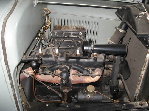

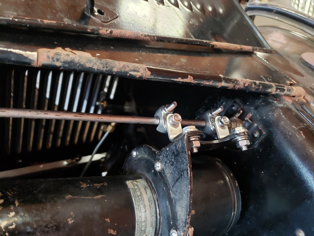

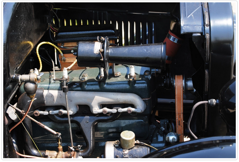

On my 1926 Coupe that has a water pump the battery horn is mounted to the radiator support rod. It works ok for now.

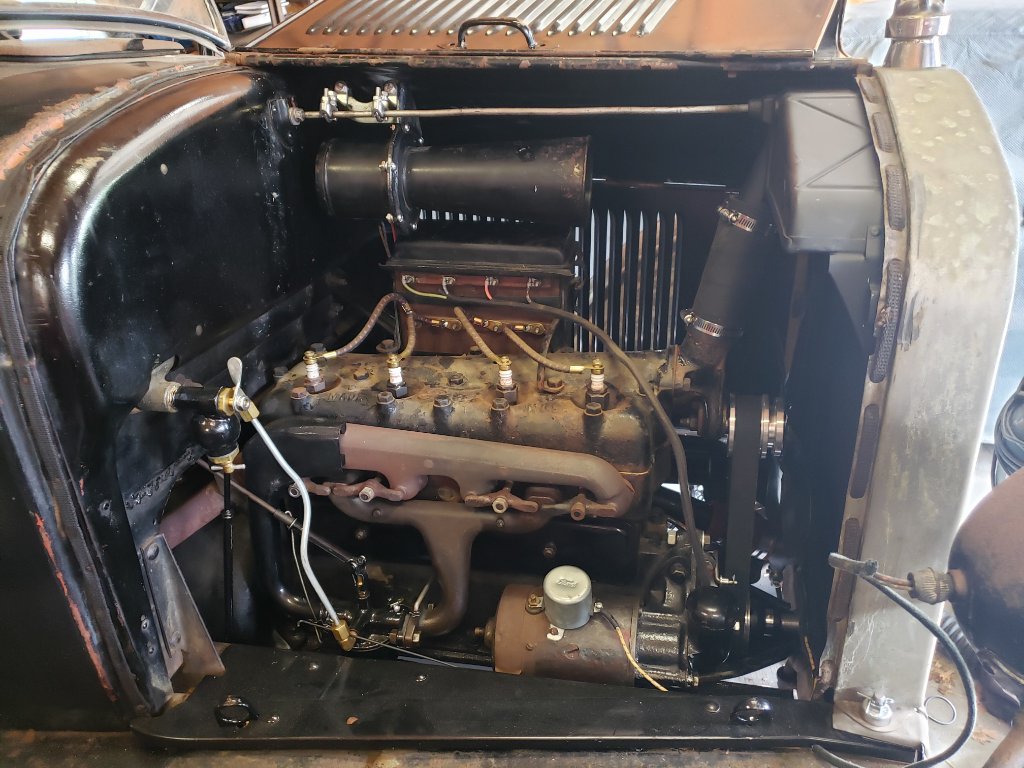

William,
Can you show us a picture of the arrangement you've got?

Re: Horn will not fit inside 1926 Coupe hood after installing a water pump
Hey Jerry,
At work but will take a photo when I get home and post it.

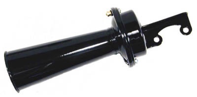

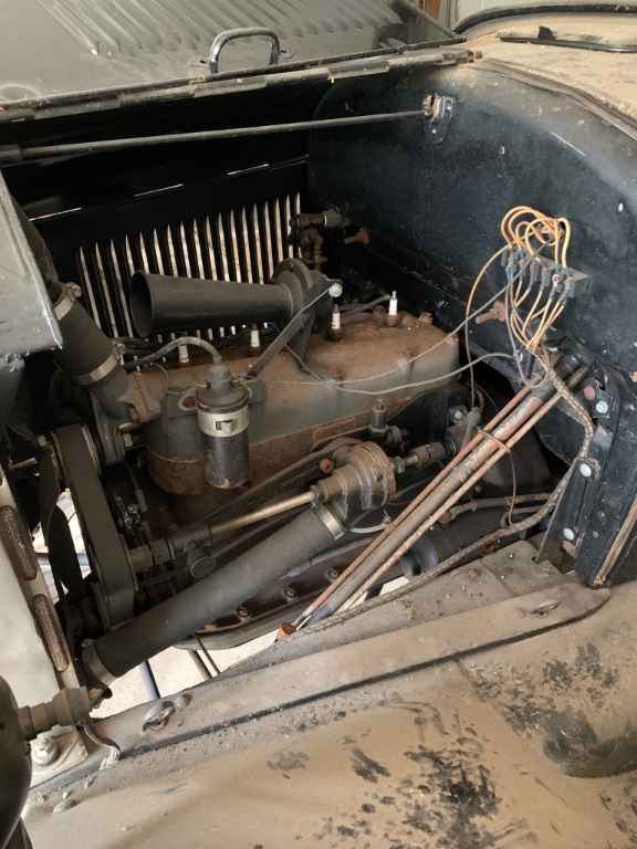

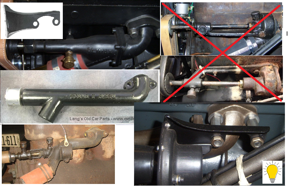

It is pretty easy to make a horn bracket out of 1/8” x 1” steel flat bar to position the horn atop the engine attached to two head bolts on the passenger side of the engine next to the coil box. There is only one 90 degree bend needed using a butane torch to heat the steel where the bend is to be made and the sharp bend made with the help of a heavy vice and heavy mawl. Jim Patrick

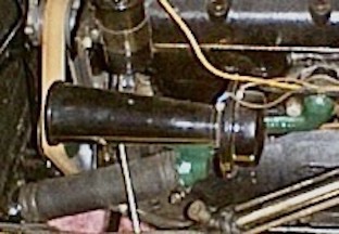

Prior to 26, all T horns mounted with a bracket to the left of the cylinder head, away from the water inlet. In 26, when the coil box was located in that space, the horn had to be relocated and a new bracket was made to locate the horn using the two bolts holding the water inlet to the left side of the motor. Since NO T ever came from the factory with a water pump, the bracket was made to fit around the water inlet casting and NOT the casting of a water pump. When this happened, all side mount water pumps made before 26 would not allow a horn to be mounted to them. Aftermarket manufacturers of water pumps redesigned their castings and pumps with a set of threaded holes to allow the stock 26-27 Ford horn bracket were available. You didn't say if you were trying to use an original Model T vibrator horn or a Model A motor driven horn , or a 6 volt horn off some other make vehicle. Purists would never put a motor driven horn on a T, but owners who don't give a 'squat' about correctness will use anything as at least one of the pictures, above, prove.

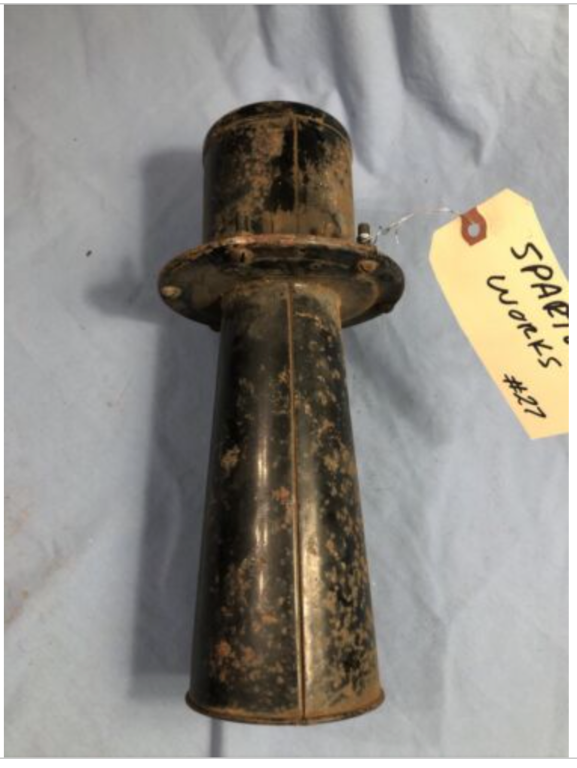

Scott thanks for the kind words. I was surprised that the post would get such a reaction. I just want to get the car on the road and drive it. I can tell a fib or two about what parts are what and get away with it. Here is a photo of the horn that will not work. I found it searching for horn photos. This is exactly what I have and it said it was for a chevy, buick, dodge brothers fit. If it can be verified as to what it came off of I guess I can sell it and get rid of it. It really works well and sounds good.

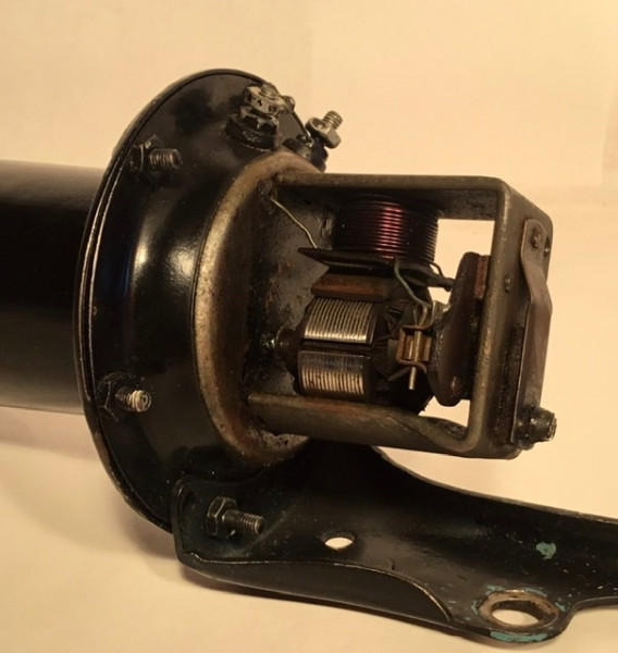

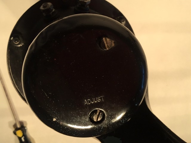

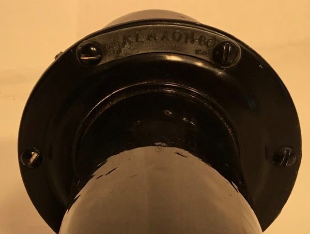

That's an original Sparton Ahooga horn - they're a great horn & easy to clean & adjust. A stock Model T horn sounds like a sick goose ! You can make your own mounting bracket easy enough - down along the frame towards the front is a good spot - I stay away from mounting brackets that utilize any head bolts.
BarnesvilleT
Topic author - Posts: 101
- Joined: Mon Nov 14, 2022 8:26 am
- First Name: William
- Last Name: Hallada
- * REQUIRED* Type and Year of Model Ts owned: 1926 Model T Coupe
- Location: Barnesville, GA
Thanks for the info. Now that I know what it is I will be keeping it now. i will look into mounting it on the frame as well. Do you know
if it was a stock item or after market access.

Period aftermarket water pumps with the holes drilled to fit a "stock" late horn, typically fit a stock horn.
With the realization that your horn is indeed other, the problem is apparent.
You still may be able to mount your horn in the correct position by using the correct late horn mounting bracket
& changing the horn mounting holes in your horn. Parts vendors sell a stock replacement bracket.
Back to your horn issue.

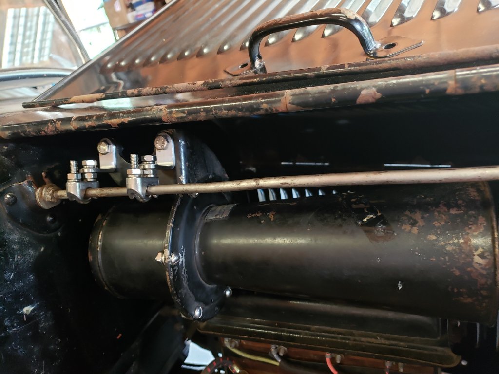

I attached mine to the underside of the hood rod, at the rear, facing forward.
(I don't have a water pump, but it seemed a better location than on head studs.)

It would have either been an aftermarket accessory or simply "borrowed" from another make & model of car. You mentioned mounting it to the frame. I wouldn't do that for fear of it getting wet or pummeled with road dirt. Best bet is to make a bracket for it that uses a couple of the head bolts on the "carburetor side" of the engine. If you do that, be sure to use longer head bolts in those 2 spots. Sorry for the water pump commotion.BarnesvilleT wrote: ↑Thu Feb 23, 2023 1:05 pmThanks for the info. Now that I know what it is I will be keeping it now. i will look into mounting it on the frame as well. Do you know

Yes, that would work well too, but might be tough to clamp it there firmly enough so it won't swing around on the rod.Chris Barker wrote: ↑Thu Feb 23, 2023 2:49 pmI attached mine to the underside of the hood rod, at the rear, facing forward.

I just removed the water pump on my 25 roadster and put the horn back to its original location with a new bracket, as the original bracket had been modified to fit on top of the engine.

A few of the water pumps* have correct build for fitting stock 26-27 horn and bracket. Texas T Parts (Birdhaven) 'Leakless' version pump is one, the std. Ford horn fits right on the water inlet pump housing. Photo below is the 'Leakless' pump

Making it work

Frank I had thought about mentioning to the original poster that he could use longer studs or bolts with the appropriate length spacers (like one of your pictures, shows) IF he didn't have the later design pump that accommodated a 26-27 horn and bracket. However, when he said what kind of horn he was trying to mount, I didn't mention the "spacer idea". No amount of spacers or the original 26-27 horn bracket is going to a allow a 'Humongous' Model A motor driven horn to be mounted in that location without interference. Its like trying to mount a turbocharger on the exhaust manifold on the other side of the motor.

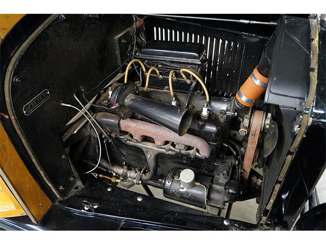

Funny Bruce Brakke posted WTB for an Ahooga horn yesterdayBarnesvilleT wrote: ↑Thu Feb 23, 2023 12:42 pmScott thanks for the kind words. I was surprised that the post would get such a reaction. I just want to get the car on the road and drive it. I can tell a fib or two about what parts are what and get away with it. Here is a photo of the horn that will not work. I found it searching for horn photos. This is exactly what I have and it said it was for a chevy, buick, dodge brothers fit. If it can be verified as to what it came off of I guess I can sell it and get rid of it. It really works well and sounds good.
- Posts: 4056
Here is another way to mount with a water pump. This Ford electric horn has the '25 and earlier bracket, that is two holes, vertical from one head bolt to one water outlet bolt.
The owner turned the bracket to fit to the cylinder head, with one bracket hole, and used a long strap from the other bracket hole, to another cylinder head bolt.
Very nice way to do it. Once used a single bolt mount bracket, and the weight of the horn caused the bracket to fatigue in the bend, and the horn fell loose.
Whatever way you mount the horn, be sure to accommodate the shake, rattle, and roll of the Ford.

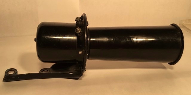

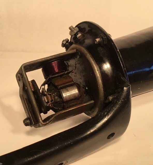

The vintage 1920’s 6V Klaxon in my picture is an 8C. It is a very good quality motorized ahoogah horn. Jim Patrick

Thats a good option for a horn. The small size fits better than an A horn. Fits a stock bracket as shown.
The key point to what you seek is a motor driven noise maker as opposed to a vibrating unit.
Easily identified by the can behind the bell about the size of a bendix cover.

Here's my solution where I have an ahooga horn and the stock horn switched with a dual throw switch. Cable clamps with shelf brackets.
Cheers,
Mike
Cheers,
Mike
