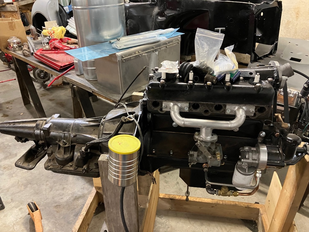

A picture of a 4speed behind a T engine
The special pan for installation of the A transmission was reproduced some years ago and I have one I plan to use soon.
There were era versions of “hogsheads” that had sliding gear transmission incorporated and I have two of those.
A automatic behind a T engine!
I have made the pieces to install a Volvo 4 speed behind the regular T engine. The all synchro I believe would be an advantage when dealing with potential clutch drag.

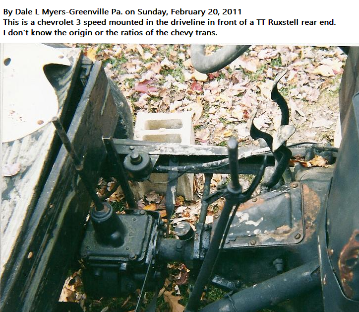

I have head some people use a 1937-1939 Chevrolet transmission as an auxiliary as well. Cannot find anything on that. Curious to hear of other transmissions using solely the Ford high clutch.

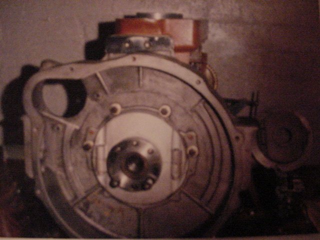

I have castings available for the rear main seal shown. It only works with an unshortened A crank. The pan is a shortened 4 dip and the bell housing is Model A.

Dan, fantastic work, you’ve peaked my interest. Is the seal retainer also acting as a spacer on the flywheel housing? This is the first completed setup I have seen.
How did you seal the rear of the cam area?
Another talking point, would a Model a flywheel (turned down to a loaded T flywheel weight) bolted to a T crank work? I know the crank is shorter, and I’m not even sure the crank flanges are the same, (will check that later today) If they are, could a spacer of the distance needed be used between the flange and flywheel be used? Or would potential problems arise from that?
