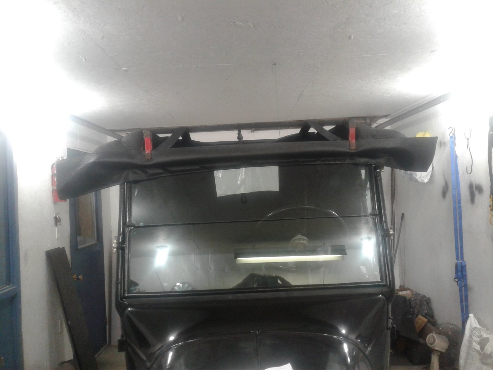

Installing the roof covering kit. Not sure how the front flap is to be installed at the corners. Do I cut it? Pictures anyone?

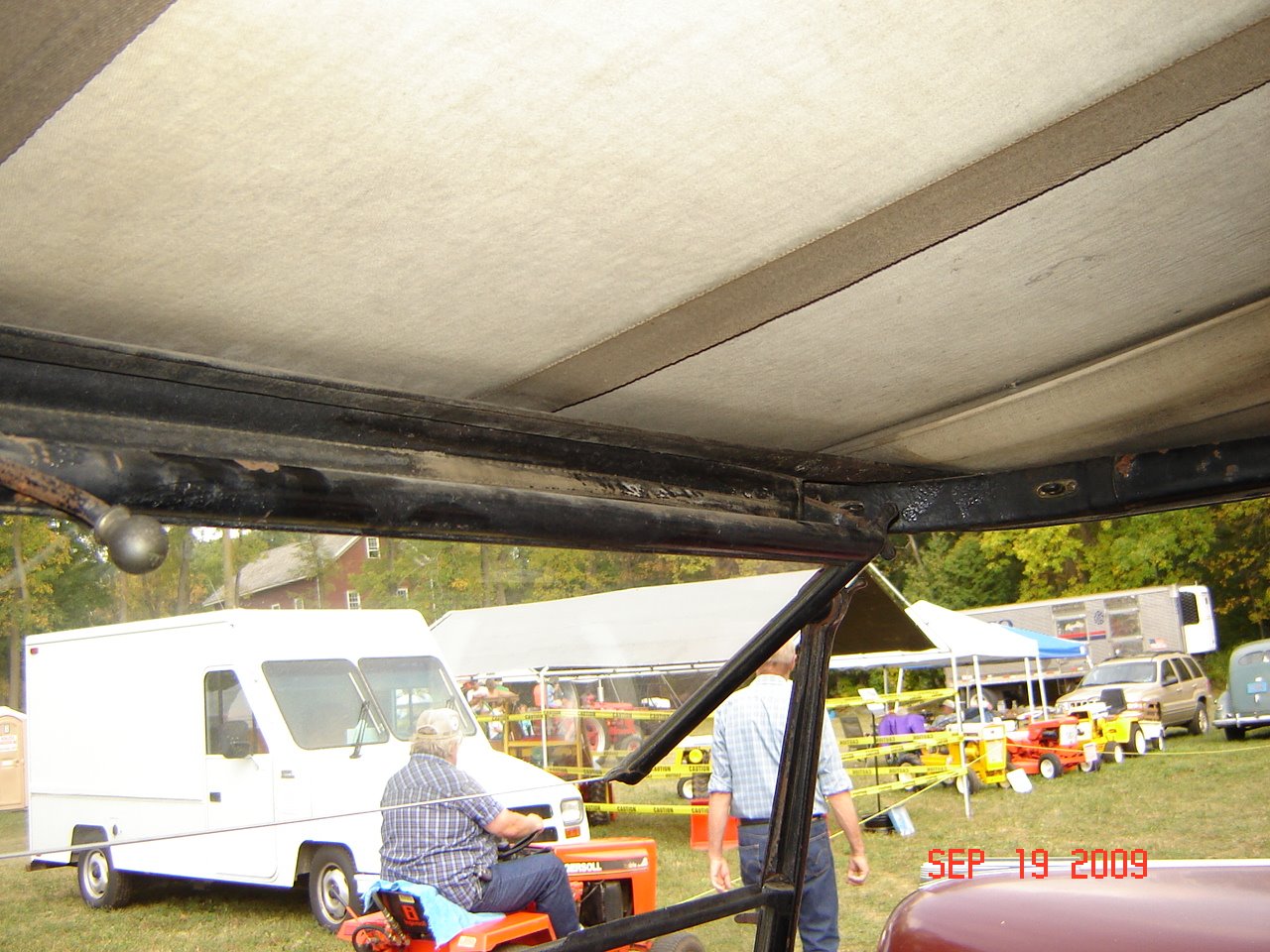

I'm not sure if this helps. It is a Dan trace photo from this 1915 discussion but looks like a '23-'25 front flap.
http://www.mtfca.com/discus/messages/82 ... 1535333350

The photo you posted above is not correct. Should you need the correct information, I'll be happy to help.

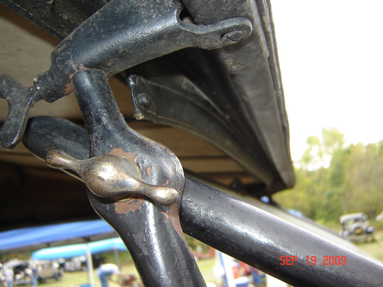

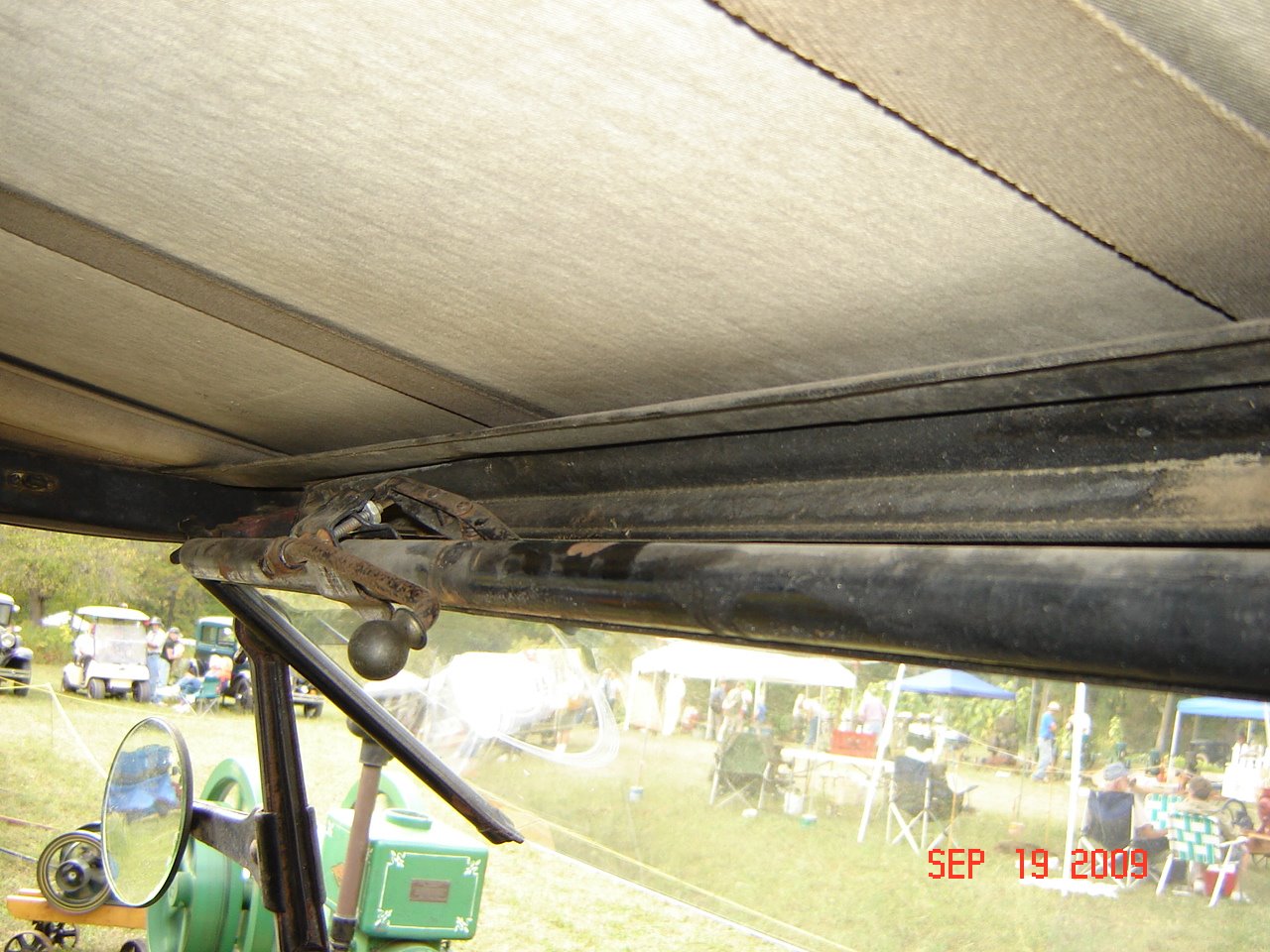

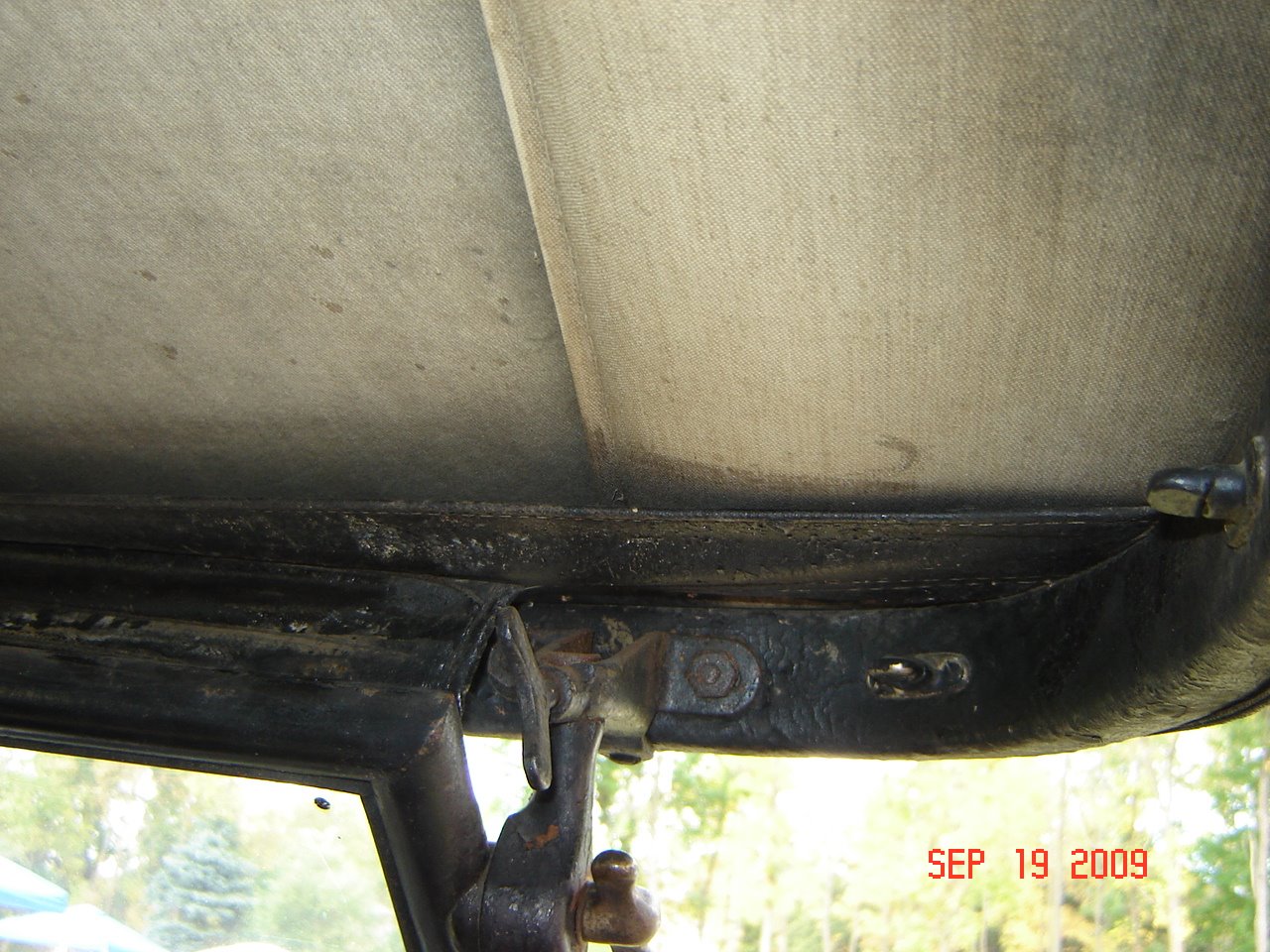

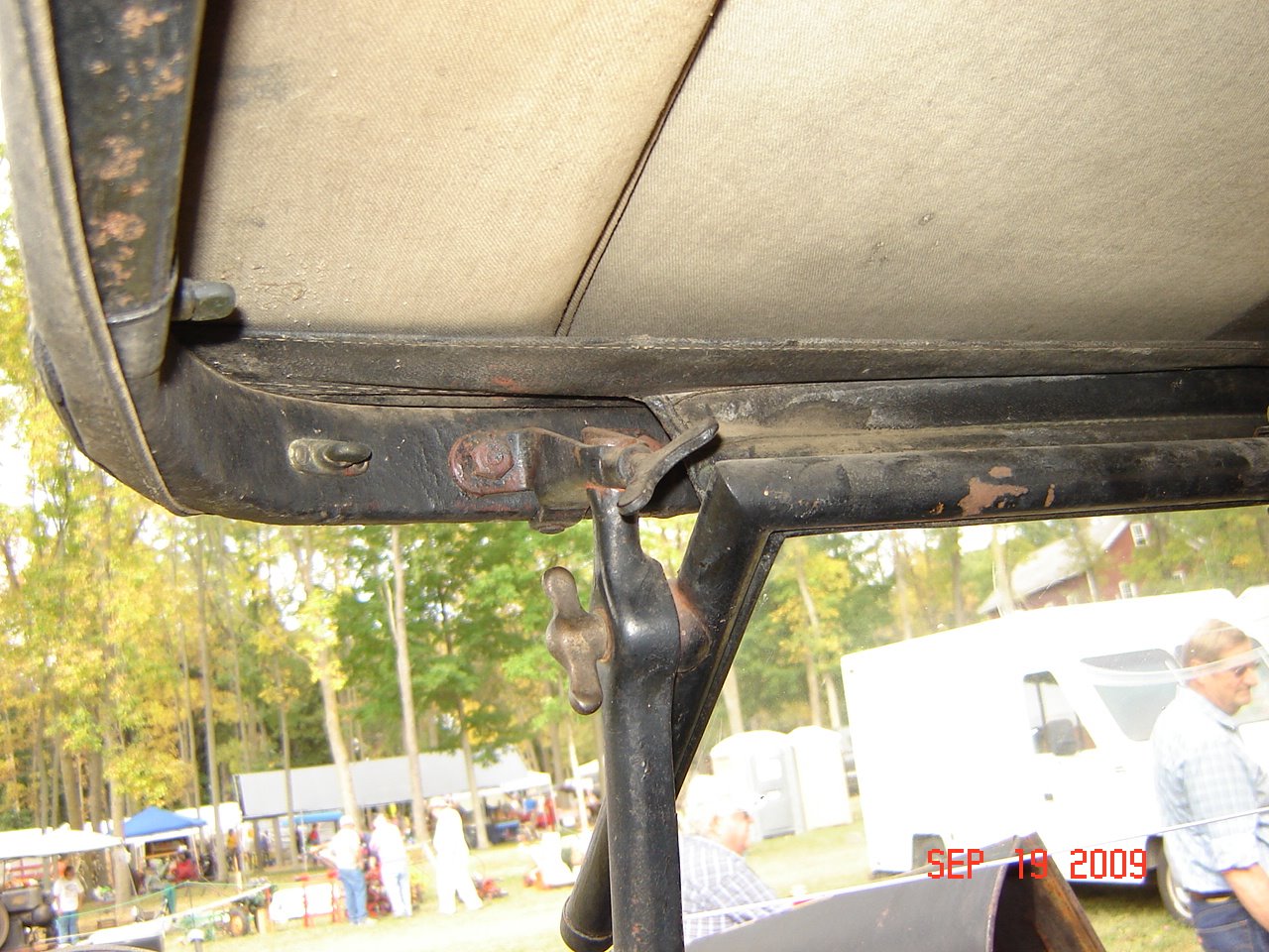

Here are some photos of the wind flap on a 1924 Touring that has the original top and upholstery. I have more photos of the details if you need them.

Jim, your photos confirm my suspicion that what I was posting may not apply to later cars with the front bow set well past the windscreen. It is just like it is done on our Colonial tops.

Thank you for the pictures and info. I think I can get it from here on. Not sure why the piece is made about 8-10 inches longer on each end and sewn. It's a big rectangle that is too thick to roll into place anywhere and the instructions are very vague.

Scott, The problem is the front "windscreen" is about 16inches too long compared to the pictures I have seen anywhere. It is cut square on the ends and sewn nicely. Just seemed strange that it would need to be cut down that much. It is similar to the one in the second post you mention but the instructions show it not being wrapped up around the front bow but rather tacked to the front and under. There is way to much material the way it is to ever nail it in place and look correct. Not my first top install, but my first 25 top install.
