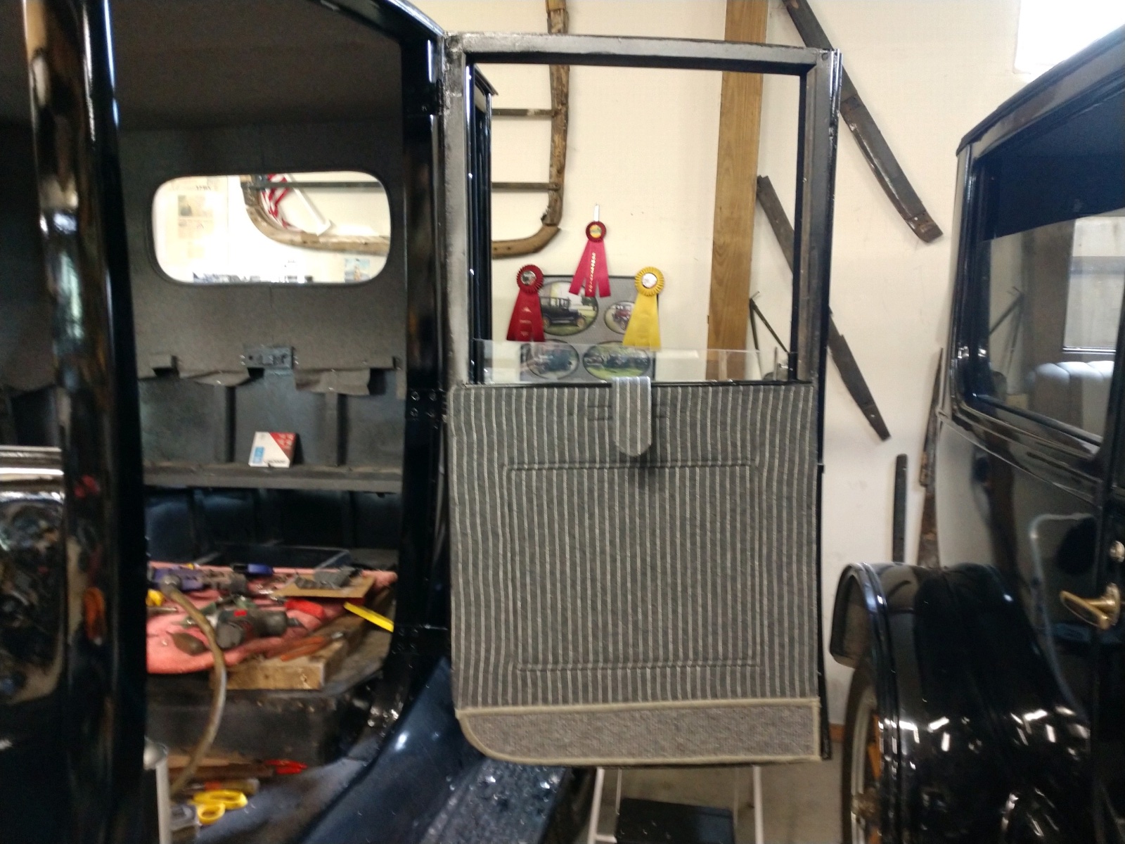

Hey everyone first time posting on here I’m in the process of restoring a 20 coupe and need pics of the interior door pulls or handles also window straps what keeps them from falling in the door thanks for all the help. Willing to buy a correct set of interior handles or pulls if anyone has a set available Thanks Dale

All 4 windows used straps. Up till the introduction of the metal sliding type, the windows were ether open or closed, there was no in between. The door pulls on the 20 would look like a towel bar, just a piece of round stock. My 21 had no pulls on the lower window garnish molding and the short door pull handle came about the same time as the latching window (late 22?). All my photos of the 21 body that was on Nelly-Bell the Raloo Rocket are on my other computer that I can't access thru here.

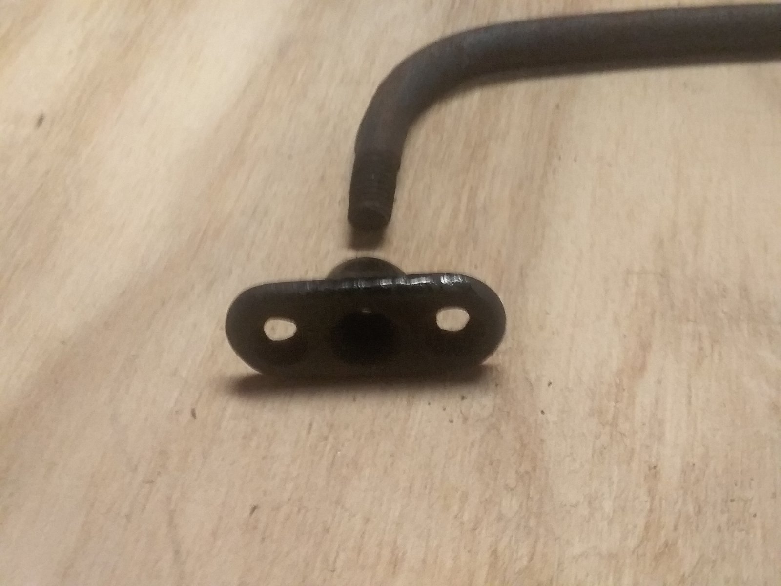

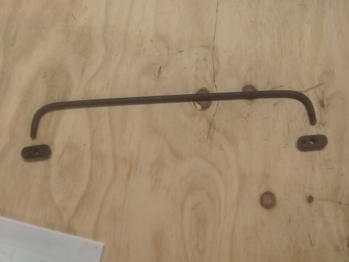

I'm not as far along on my 20 coupe as you are, so my pulls aren't mounted to the doors. I will attempt to post a picture of them.
The bar is 5/16 rod 14 3/4 mount to mount the little brackets are cast and threaded.
