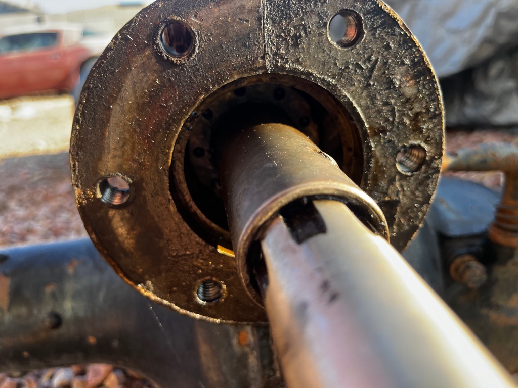

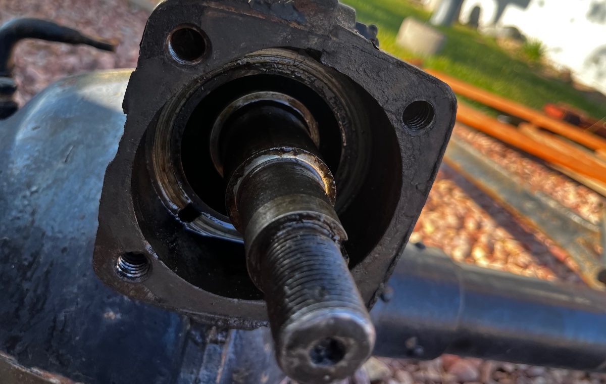

Re: Taking the Driveshaft off of a TT Ruckstell
Post by Jacob Mangold » Fri Jun 23, 2023 9:27 pm
Here’s where I’m at now.
Driveshaft side bearing is in but I cannot seem to get the other one quite in all the way.
Post by StevenS » Fri Jun 23, 2023 10:50 pm
I have a TT truck with a Ruckstell rear end, and I had to rebuild it. I have taken 8 more TT Ruckstell rear ends apart to get parts and spares for my truck rear end. From my experience I would take apart your rear end completely to inspect it. All the rear ends I have taken apart all had some sort of damage in them. The MTFCA rear end book (seen above) is a needed tool for a good rebuild. Here are some more articles that maybe helpful. Also got any questions feel free to ask. Also take lots of pictures as you disassemble it. I also built two carts to rest each half of the rear end when I split it and reassembled it.
Post by Jacob Mangold » Fri Jun 23, 2023 10:55 pm
Was able to get both bearing back in with an extra set of hands.
