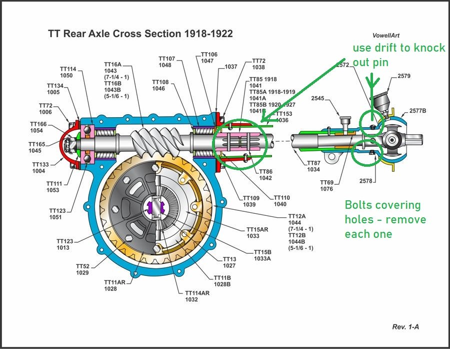

Re: Taking the Driveshaft off of a TT Ruckstell
Hi Jacob,
Take a look a the diagrams Martynn has made in our technical drawing section: app.php/gallery/album/59
These may help you understand what fits where and what parts need removal.
To help us a little, what are you trying to do? What stage of disassembly are you at? Can you please post a picture? .. as it depends what you are up to and what you want to do as to what explanation to give you.
Is the rear axle/torque tube assembly out of the truck?
Are you dismantling the rear axle ? (the only way to remove the worm)
For example (same idea with Ruckstell or std diff):
To remove the drive shaft you need to remove the pins holding it in the connecting shaft at the front of the axle (pink coloured in Martynn's drawing).
To remove that you need to remove the torque tube.
To do that you have to remove the universal joint.
To do that you have to knock out the pin through the holes on the front casting.
To do that you really need the unit removed from the truck.
You cannot remove the drive shaft through the rear of the diff or by removing the work.

- Posts: 1189
- First Name: Adrian
- Last Name: Whiteman
Hi Jacob,
At the front, where the U joint fits in, there are bolts screwed into the casting.
Undo these - one at the top, and the other is 180 degrees below it.
Use a drift (long punch), line up the pin through the top hole and knock the pin out through the bottom hole .
You can now pull the U joint out the front, then pull the torque tube off the drive shaft.
Once this is done, use the drift again to knock the pins out of the splined casting at the rear end of the drive shaft.
You may have to wack it a bit as the end of the pins will be peened.
