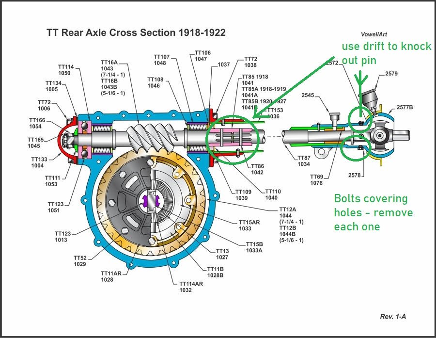

For example (same idea with Ruckstell or std diff):
To remove the drive shaft you need to remove the pins holding it in the connecting shaft at the front of the axle (pink coloured in Martynn's drawing).
To remove that you need to remove the torque tube.
To do that you have to remove the universal joint.
To do that you have to knock out the pin through the holes on the front casting.
To do that you really need the unit removed from the truck.
You cannot remove the drive shaft through the rear of the diff or by removing the work.

Hi Jacob,
At the front, where the U joint fits in, there are bolts screwed into the casting.
Undo these - one at the top, and the other is 180 degrees below it.
Use a drift (long punch), line up the pin through the top hole and knock the pin out through the bottom hole .
You can now pull the U joint out the front, then pull the torque tube off the drive shaft.
Once this is done, use the drift again to knock the pins out of the splined casting at the rear end of the drive shaft.
You may have to wack it a bit as the end of the pins will be peened.

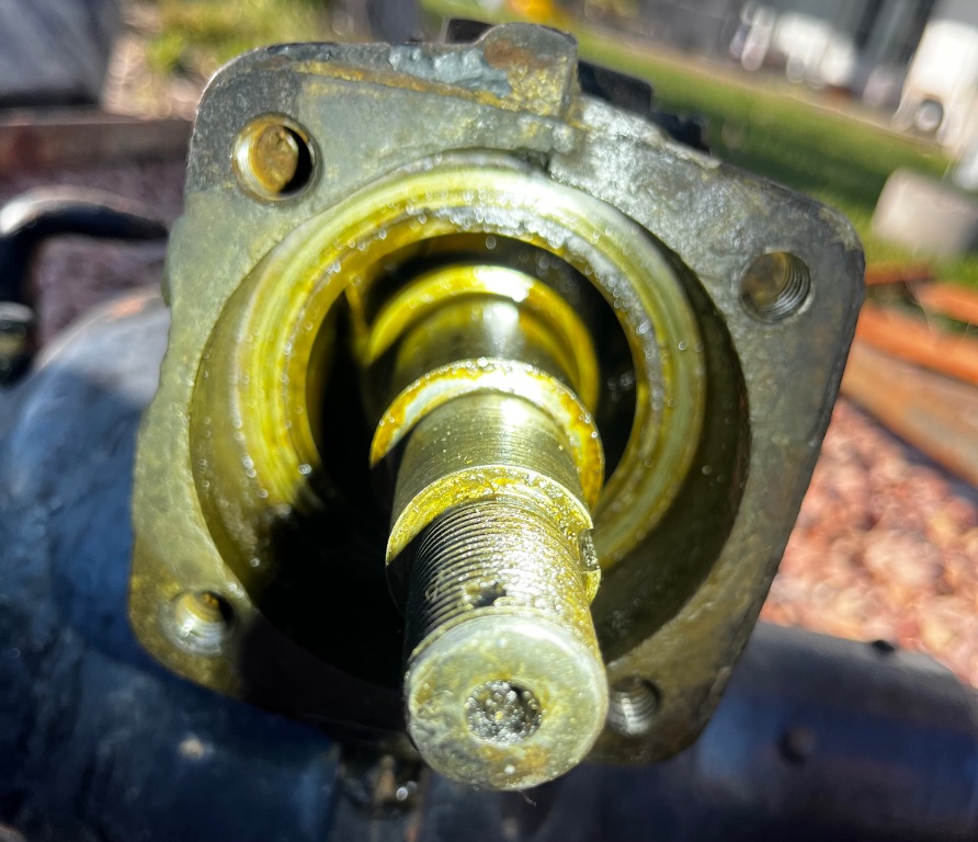

Here’s where I’m at now.
Driveshaft side bearing is in but I cannot seem to get the other one quite in all the way.
