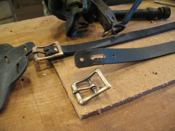

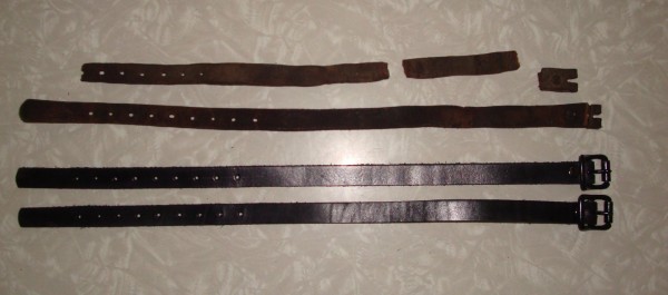

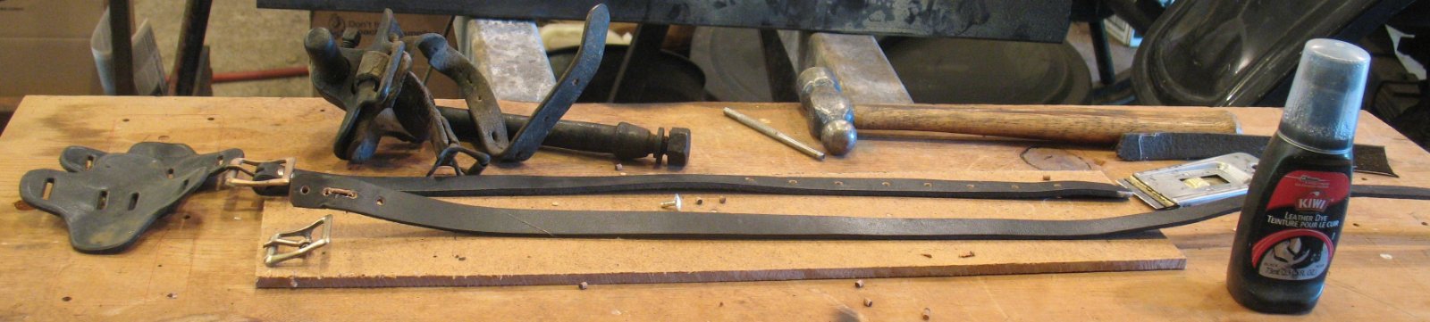

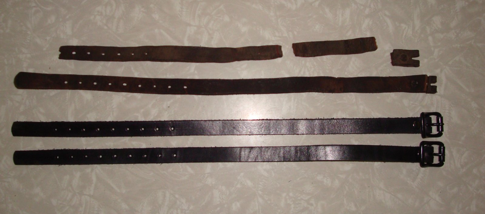

A few years ago, my dad made a set of pads and straps for my 1917 roadster using the originals as patterns. There is a saddle shop here in Minneapolis that was established in 1907 and has a fully equipped shop with 100+ year old machinery.
My dad had the shop shave a piece of leather to the correct thickness. He did the rest of the labor himself: cutting correct length and width straps from the leather, putting a radius a one of end of each strap, punching the holes, dying the leather and riveting the loop around the original buckles from my roadster. See attached for the completed straps shown with the originals.
My father also made a set of straps and pads for his 1917 touring (the straps are longer than the touring). They were actually the second set of straps and pads he had made for his touring. He had the first set made by the same shop mentioned above in 1951 but they did all the work for him the first time around. He drove the car down there and they did it while he waited.
