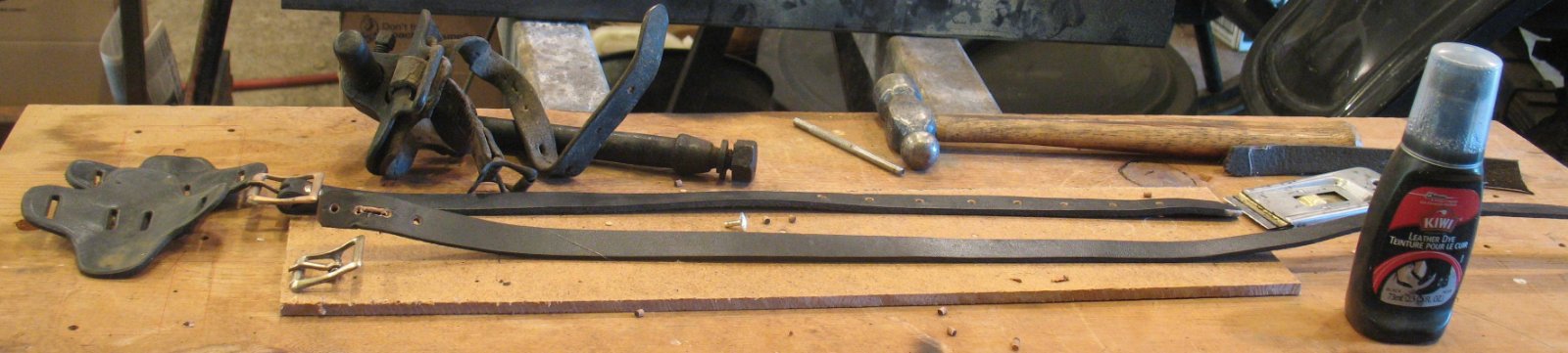

I was lucky enough to have a brittle old pad for a sample. I took it to the local saddle shop and had a pair of new ones made. I was able to borrow an original strap I could copy.
This was a couple of years ago, and I have no recollection of where I got the buckles.
