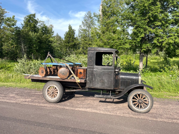

Post by BUSHMIKE » Sun Jul 09, 2023 1:22 pm

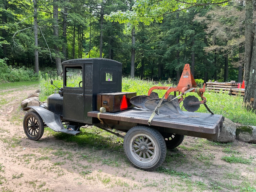

Earning its keep……Getting lots of “thumbs up” and horn blows from the logging trucks I run into on the FS roads. Big smiles on their faces. What a great improvement in ride with 500#’s on the bed. This pick-up and drop-off will be another 50 mile round trip 2x. What a hoot!

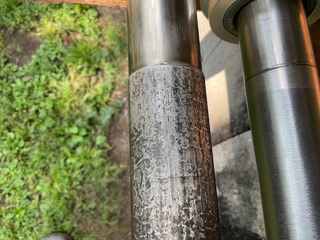

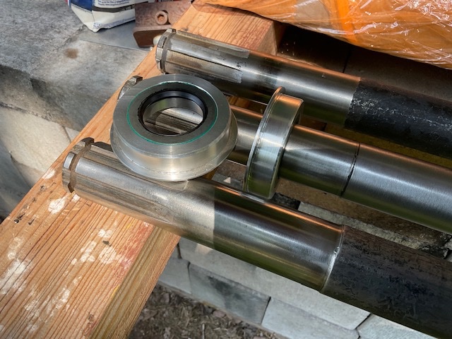

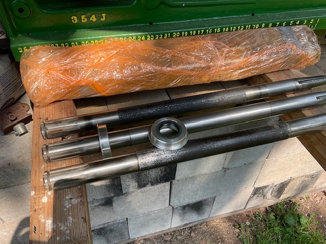

Today, I turned down the center section of my NOS LEMPCO axles for the TT. I ended up tearing the rear end apart to check things out before the upcoming Fall Color Tour. Im glad I did. The sleeves, bearings and axles were shot. I could lift each axle 1/8” with the weight of the truck/wheels off! I found (2) excellent bearings and one good sleeve in (5) complete axles. Thanx to this forum, I was able to locate (2) NOS LEMPCO replacement axles and a good useable sleeve. I designed and turned up (2) glands to adapt modern double lip seals to the inner axle seal….the seals next to the differential. The top axle is a stock Ford, the middle is the modified LEMPCO, and the lower an unturned LEMPCO. I designed the gland to be a light press fit where the stock Ford seal was. The axle has to be loaded full length thru the lip seal and dictated that I smooth up the rough forged center section. Ill turn up the 2nd LEMPCO later today and start reassembly.

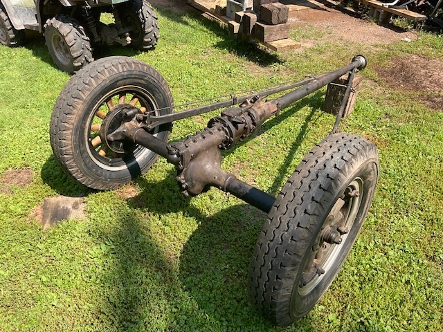

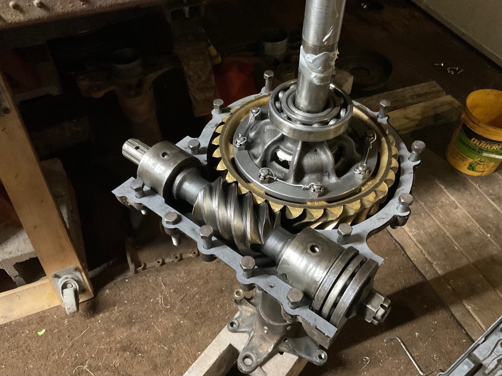

Last evening I started final assembly of the rebuilt TT axle. If all goes well, I hope to have the axle ready to roll back under the truck this afternoon.

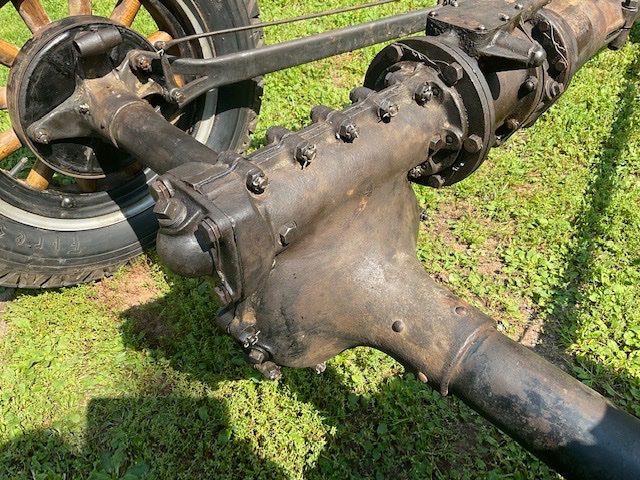

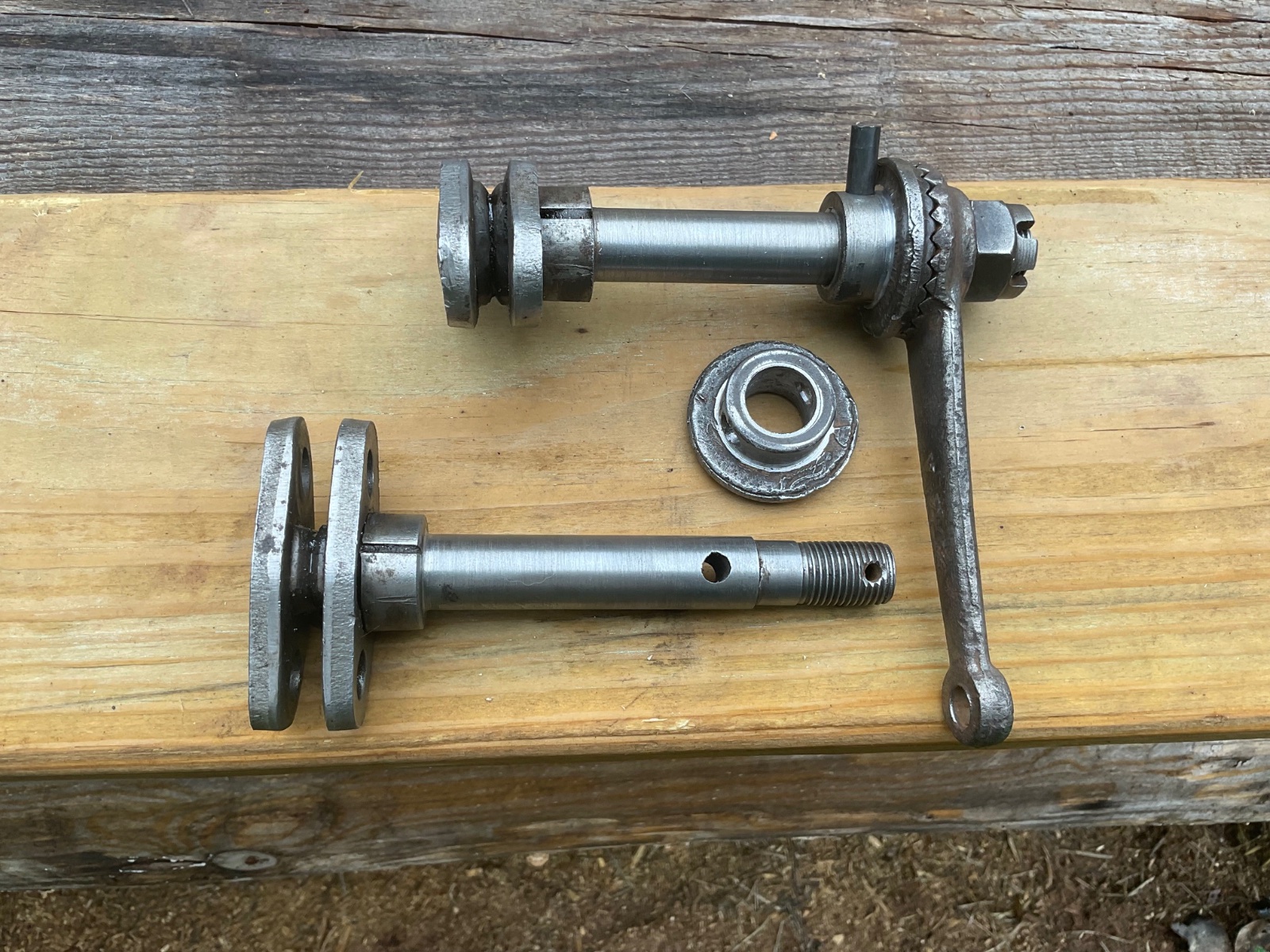

Todays project was making press fit bushings for TT PN# 1064, brake expander ajdustment collar. I had previously turned the expander shafts down to .625” to remover 1/16” or more of eccentric wear. I bushed the axle housings to match with SAE660 bronze bushings with .001” clearance. Reducing the diameter of the adjuster shafts dictated bushing the collar bore down to .625” as well. My goal is a TIGHT set of TT brakes with dry hubs…..time will tell. I enjoy going thru a slapped out loose old assembly and tightening wear points back to factory spec or BETTER. Ill start at the axle and work forward as assembly progresses. I wont bore anyone with machining set-up details but feel free to ask if you have a question.

Mike, I'm afraid you wouldn't bore us with your work to keep The Time Machine ticking. :)
Gosh, that internal view from Tuesday looks like a surreal and dream-like photo.

Ready to roll the rebuilt axle back under the Time Machine. Boy did that trick of using the fan mount bolt screwed into the bottom u-joint access hole ever work slick. It gets screwed in and then the head of the bolt set on a steel anvil/backer while peening one side of the u-joint pin. Rotate the u-joint 180deg and turn the bolt in again until it touches the just peened head to peen the second side. Tomorrow, Ill make some 4” long headless bolts to act as guides for aligning the ball assembly as it slides forward. With any luck, I should be making a test drive in the next couple of days.
