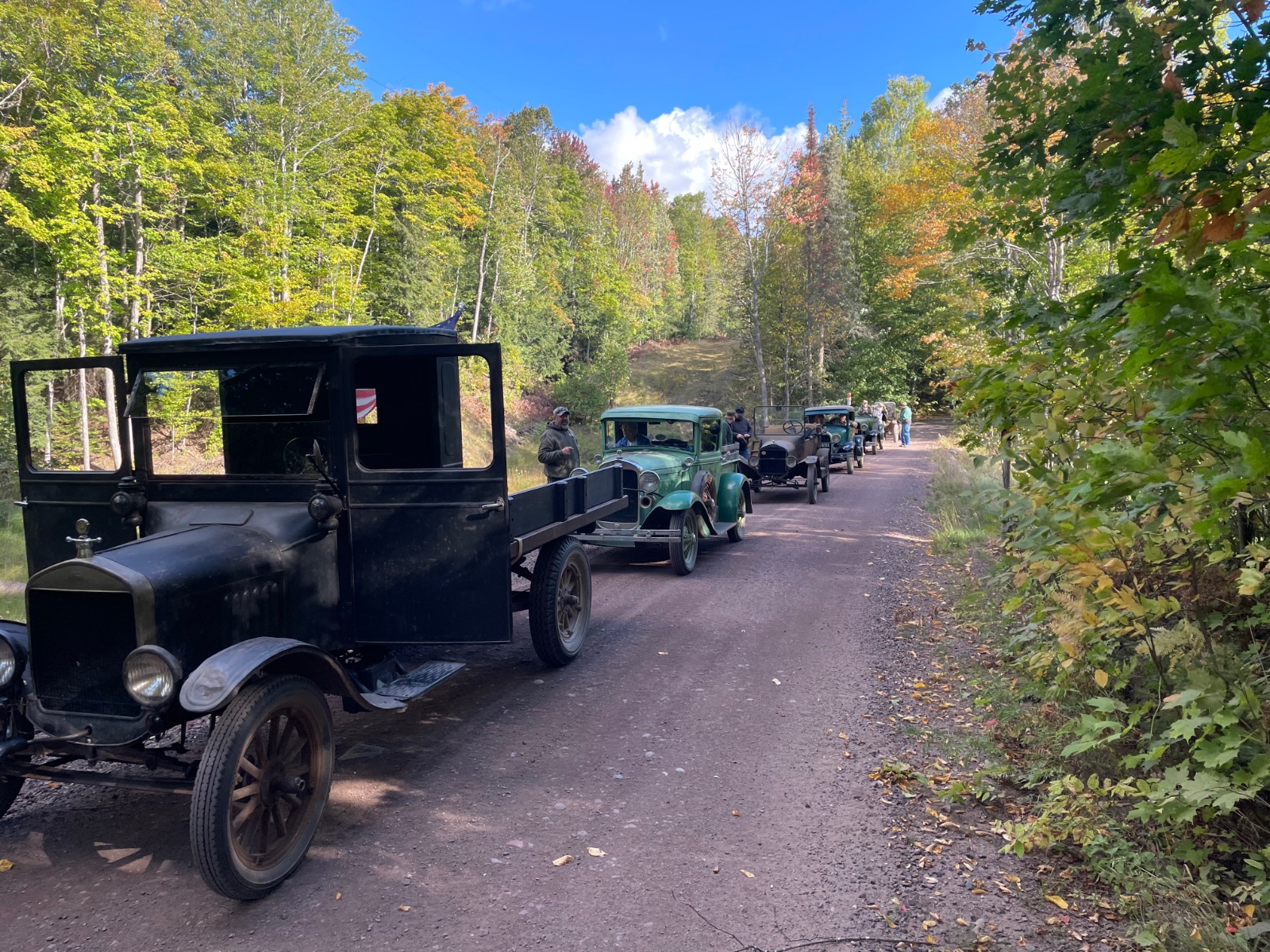

We had a great time on our 2024 Fall color tour this year. 8 vehicles this year. Color was not peaked yet. 115 miles roundtrip.
