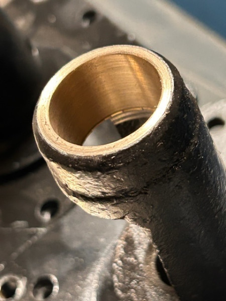

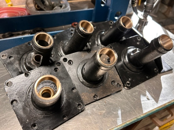

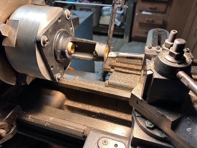

Good timing! I was actually doing a batch in my shop this afternoon.
I bore out the Babbitt and press in bronze bearing material then bore that for the bendix. This will last the life of the starter and much stronger than Babbitt.
Happy to help.

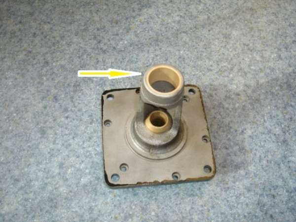

For those of you replacing the bushing, remove the babbitt and a Model A wrist pin bushing is just the correct dimensions for a nice press fit and leaves enough material to be bored to size. No need to make up special bushings.
- Posts: 4482
Re: who does babbit in starter snout?
Thanks Dan for re -reminding us about using the Model A wrist pin bushing for the T starter babbitt replacement. This has come up before and I remember reading about it in maybe Tinkering Tips or maybe years ago on the forum.

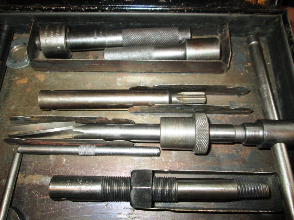

- Posts: 5263

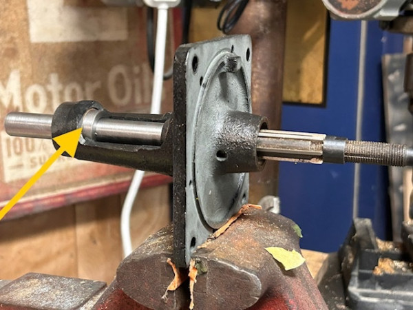

My Stevens gen. & starter repair kit has the alignment reamer that centers on the starter snout and align reams the front end bushing in perfect alignment to the snout - I also use Model A w.p. bushings honed to fit the Bendix.

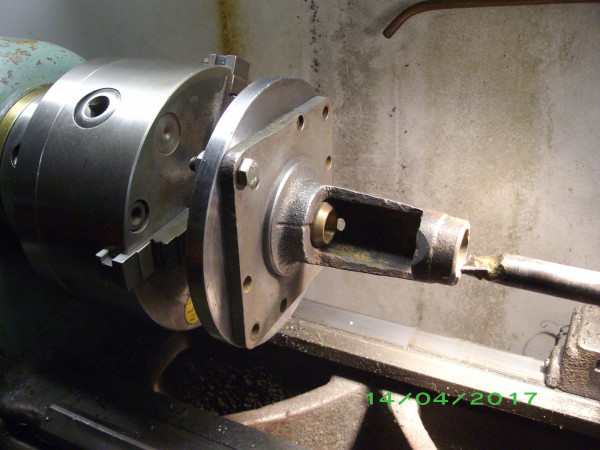

It is reare to find an end cover which is not bent somewhat, so fitting a bush that is bored/ reamed/honed to size is somewhat fraught
Fitting a thicker bush and boring it to size helps to correct slight bends in the snout.
I do find some are off center more than others but haven’t really had issues. This summer I did have a starter with an alignment issue but it was the sealed bearing in the brush cap was off a bit and caused the bendix to drag a bit. This was corrected by replacing the brush cap and sealed bearing.
I also made an alignment jig I made to ream the center bushing using the new nose bushing so everything seems to line up nicely.lastly they get an oil seal was everything is fitted and bench checked.
If anything is dragging you will see it in the free spin test. The starter should draw about 70-75 amp at a RPM of around 4000. The starters that have drag due to alignment will draw more and have less RPM’s so it does show up when testing.
Hope that helps.

Re: who does babbit in starter snout?l

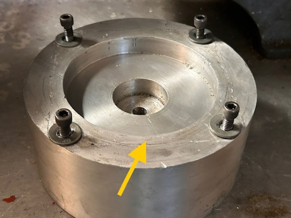

If you look at the inside of the nose that seats with the body you will see a rim that centers the nose to the body. So I made a jig to mount in the lathe that uses that rim to center the nose on the jig that I use a dial indicator to center the entire assembly on my lathe. The nose is almost a press fit into the jig so the tolerance is tight enough one can push the nose into the jig by hand but not so tight you actually have to press it.
Ounce that is centered you can determine if the nose is bend or not.

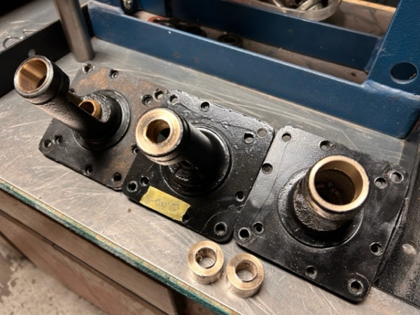

Next I bore out the babbitt, which also recuts the center. Then cut a piece of bronze, press it in and bore the bronze to the 1.00 +/- the tolerance you want for the bendix.
The middle bushing is pressed out, press in the new and line ream it to the nose. In the photo you can see a spacer to simulate the bendix, now the middle bushing is reamed to fit the armature shaft and centered to the nose.
I have done this many times without issue or drag.
So I’m sure there are several ways you can go about this, this works for me and the bronze will last much longer so shouldn’t have to mess with again.
Hope that helps.

David W.
I do nearly the same with the snout of the starter as you.
But sometime I have some problem to line up all the bearings :
The brushcap , the bronze bearing , and the new bronze n the snout .
Do you have a solution for that ??
Is there a reamer to make all three in line .
Thanks for your answer . Toon

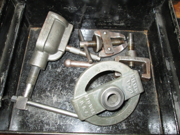

- Posts: 5263
The Stevens starter & generator repair set has an indexer for the brush end of both pieces then the new bushing is reamed. The long reaming tool centered in the top tray has the align reamer for the snout - photo above for that.
Addendum: the circular tool removes & reams the starter brush end - too early & not enough coffee - gen. takes a bearing but then one can use a bearing in the starter brush end also.
- Posts: 65
- Joined: Thu Jan 07, 2021 1:40 pm
- First Name: David
- Last Name: Woods
- Location: Williamston
That’s a nice puller. I had to make one. Same function basically drill
and tap the old babbitt or bronze bearing and pull it.
As far as the brush cap. Yes I use a modern sealed bearing and found the same for the alignment.
You typically need to bump them to fit. This cap is not in place when I ream the middle to the nose. So you’re correct this has no effect on the rear bearing alignment in the brush cap.
David
- Posts: 1098
- Joined: Wed Jan 16, 2019 6:32 pm
- First Name: Jeff
- Last Name: Stevenson
- * REQUIRED* Type and Year of Model Ts owned: 1921 Touring
- Location: Wilder Idaho
I use exactly this same process and have on 100's of starters with great success, and bronze is far superior to the original Babbitt. I used to use A bushings in the nose, but if you do as many starters as I do, bronze tubing stock is vastly more cost efficient, has more material, and it's not split like the A bushing. If you finish bore the bronze nose bushing on the lathe and then use the alignment tool correctly when reaming the shaft bushing, you won't have any binding or alignment issues.Woody23 wrote: ↑Sun Nov 12, 2023 8:30 pmIf you look at the inside of the nose that seats with the body you will see a rim that centers the nose to the body. So I made a jig to mount in the lathe that uses that rim to center the nose on the jig that I use a dial indicator to center the entire assembly on my lathe. The nose is almost a press fit into the jig so the tolerance is tight enough one can push the nose into the jig by hand but not so tight you actually have to press it.
Hope that helps.
David Woods
If there's interest I can list out all the parts to create the tooling to do this without that rockin' Stevens tool that RajoRacer holds so close
