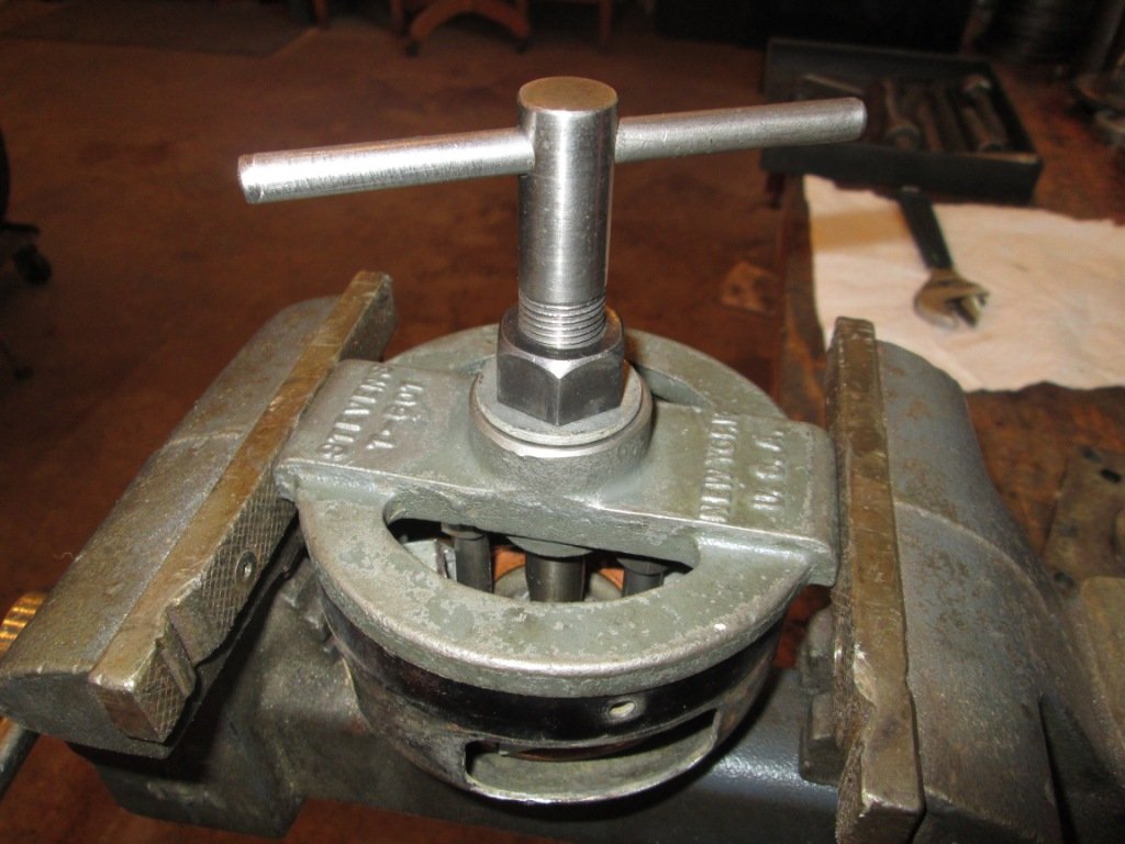

Posts: 5482
Re: who does babbit in starter snout?
Post by RajoRacer » Tue Nov 14, 2023 10:48 am
The Stevens starter & generator repair set has an indexer for the brush end of both pieces then the new bushing is reamed. The long reaming tool centered in the top tray has the align reamer for the snout - photo above for that.
Addendum: the circular tool removes & reams the starter brush end - too early & not enough coffee - gen. takes a bearing but then one can use a bearing in the starter brush end also.

Post by Woody23 » Wed Nov 15, 2023 3:51 pm
That’s a nice puller. I had to make one. Same function basically drill
and tap the old babbitt or bronze bearing and pull it.
As far as the brush cap. Yes I use a modern sealed bearing and found the same for the alignment.
You typically need to bump them to fit. This cap is not in place when I ream the middle to the nose. So you’re correct this has no effect on the rear bearing alignment in the brush cap.
David
