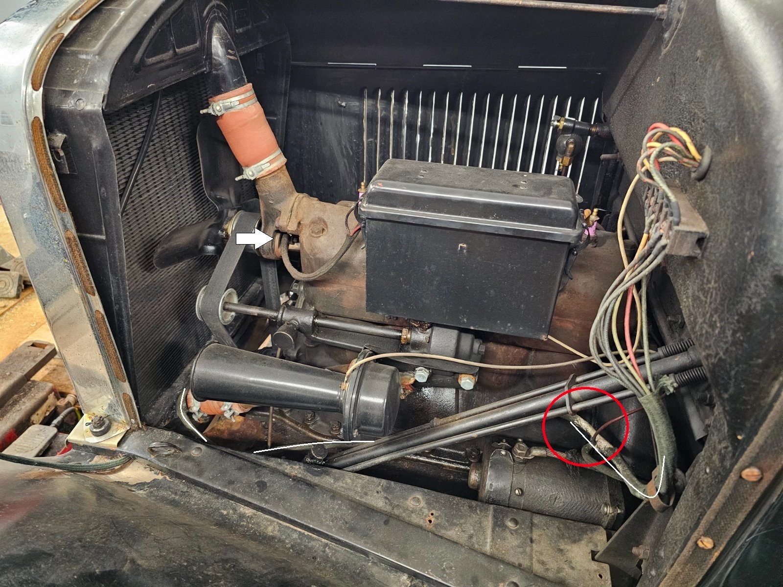

That little gold can is likely to be one of those cheap repop mechanical generator killers.
Get a diode cutout before it fails. It could be the source of your current draw.

You said that the car had been in storage since 1987, but you didn't say you replaced the battery. Did you?
Your spark plugs, if Firestone Polonium, are somewhat of a collectors item. I'd save them for a show Best price on new spark plugs & wheel bearings is RockAuto.
A cut-out is just a simple switch. If the cut-out contact points were sticking when the engine was shut off it would cause the generator to try to run like a motor - think you would notice that. It does not prevent the battery from overcharging. If you are thinking of replacing it get a Voltage Regulator instead. These are made by the Forum administrator - negative ground https://modeltstarters.com/product-cate ... s-cutouts/
Your wire routing in the engine bay needs some securing also the white area on the harness needs to be investigated. --
note white tracer I added of wires going to headlights --
example --
routing -
example --
routing -

If the cutout was closed, the generator couldnt motor still bolted in the motor, but it would get hot.
That you could notice.

One thing about a water pump, is that it is at a very low point on the water level so that any leak, even a small one can lower the coolant to the point where the car will overheat. So look often for leaks and always check coolant level immediately before you start the engine to be sure it has not leaked out. The normal coolant level is about 2 inches below the cap or about even with the Ford name on the front of the radiator shell. This level is when checking cold before you start the engine. It will rise to the top as the engine warms up and the water expands. So do not overfill nor let it run too low. I hope I explained this and did not confuse you.

My own experience with a water pump. The only T I had with a water pump was the first one I bought which had one on it when I became the owner. One January or possibly February day, we went into the mountains on a tour. We stopped at for a rest stop. (This is in California, so only snows high in the mountains, usually) It was a cold day and many of the members were standing in front of their radiators to keep warm. My radiator was cold because of the water pump. Later it went bad so I removed it and installed the original type inlet to the block and have had no problems with overheating nor problems with warming up on the colder days. Only overheating problem I had was one day when I didn't listen to my wife and when we had driven about 50 miles on a tour we stopped for lunch and she, " said you better check the water before we start back". I said,"it's fine, it hasn't been overheating". So we went back to the starting point of the tour. Then we started for home which was almost all uphill from there. As we climbed the first 5 miles or so, I noticed the motometer was moving above the circle, and knew we would have about 3 miles of level and then another mile uphill before the last mile which was quite level to home. So I continued. The motometer didn't come down but I thought, "just a short way now" and kept on going. About a mile from home it blew the headgasket and steam came out all over, so I pulled over to let it cool for an hour or so. Anyway, It was not because I didn't have the water pump, but because I had a slight leak at the small hole where the water goes from the block to the head right behind the exhaust manifold. This leak was caused because the location of that hole is on a corner of the head between two bolts but the last bolt in the back was bottomed out in the block and although the torque wrench read correctly, it was reading against the block but the head was not pressing down. A new gasket and a washer under the head of that bolt fixed the problem. Had to get a head gasket and new motometer. So check everything. You can find problems in the "darndest places".

Oh yeah, that was the first thing I did. Got it home and made it run, then drove like 25 feet to make sure it all worked and parked it till I changed the bands and cleaned out the oil panBilly Vrana wrote: ↑Wed Dec 20, 2023 2:28 pmAnother thing to think about, if that car has been sitting 20-30 years you should probably replace the bands in the transmission. They break down with time, it'll come apart and block the oil galley. You won't feel or hear it until it's too late, then its bearings. That sure is a good looking car,

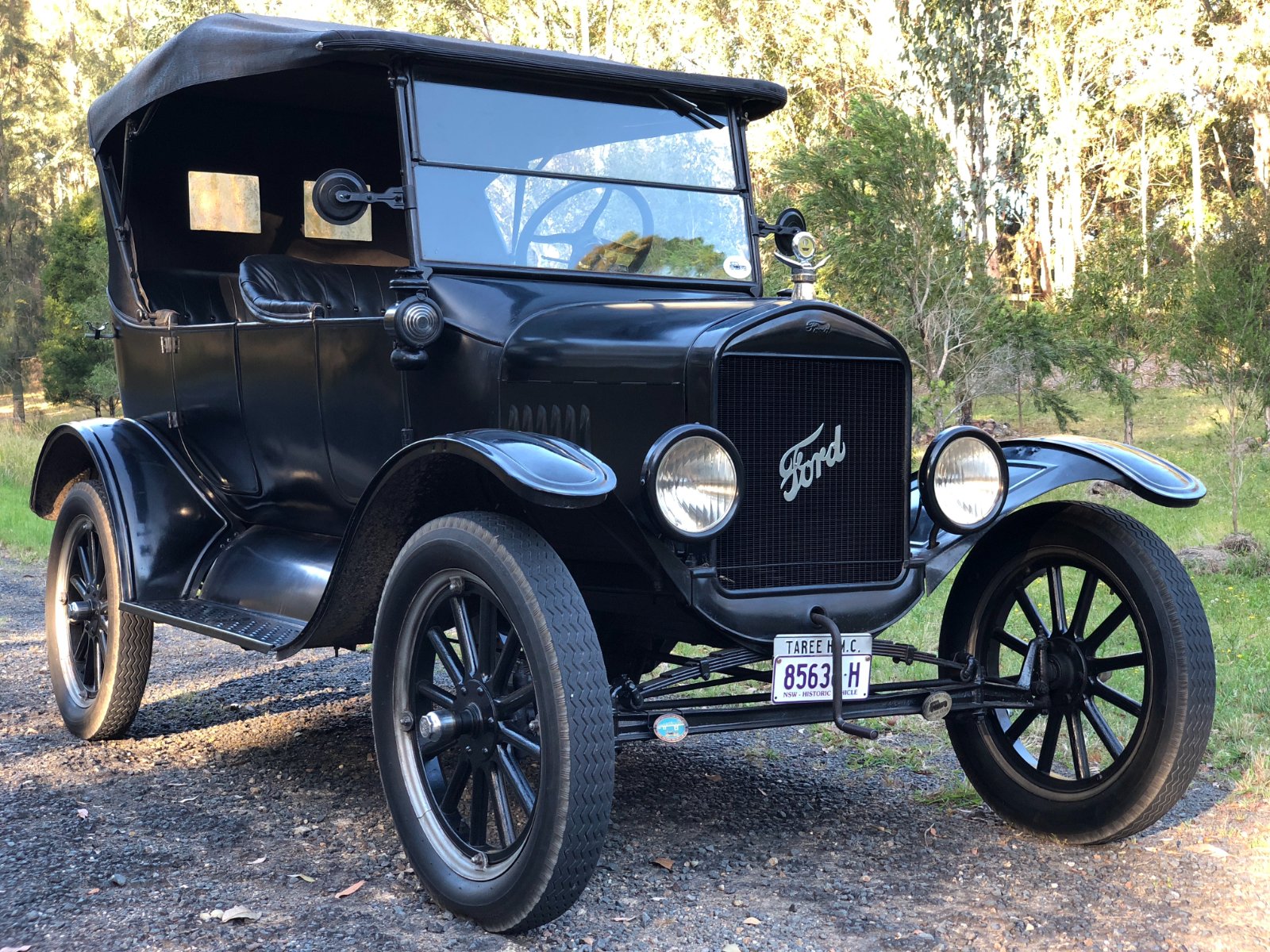

ModelTMitch
- Posts: 170
- Joined: Tue Mar 19, 2019 6:58 pm
- First Name: Mitch
- Last Name: Taylor
- * REQUIRED* Type and Year of Model Ts owned: 1924 Ford Model T touring
- Location: https://www.fordmodelt.net (Manning Valley, NSW, Australia)
Re: New T owner, wanted to share my project
Welcome to the hobby mate!
I was 24 years old when I purchased my '24 touring, you're 26 with your '26 funny how the numbers align sometimes
Your car looks great! You'll grow to love her (and hate her)... actually scrub that, it's impossible to "hate" a Model T
They're more like an old friend that will do anything for you! Owned mine since I was 24 (im 36 now), and she's never skipped a beat!
Enjoy!
