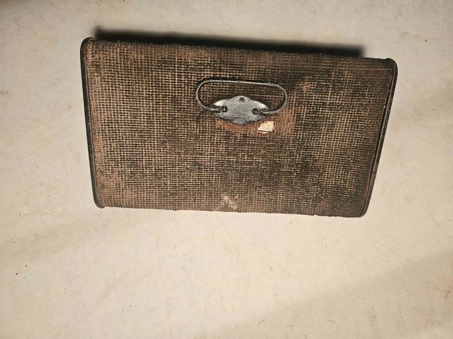

Cant wait.
Interesting foot horn.
Does it work well?
This might be a good option to keep the normally mounted bulb out of the way.
Does it work well?

The horn works fine, but I don't think I like the idea of working the bulb with my foot...thinking too much potential for stress on the brass, but also about the time you're honking at something is the very point in time your foot should be dancing on the pedals.
Conversely, at 6'4" its gonna be a job figuring where I can mount it on the "door" without it getting in the way of my leg.
Once cleaned up though I'll be painting the horn body back to black

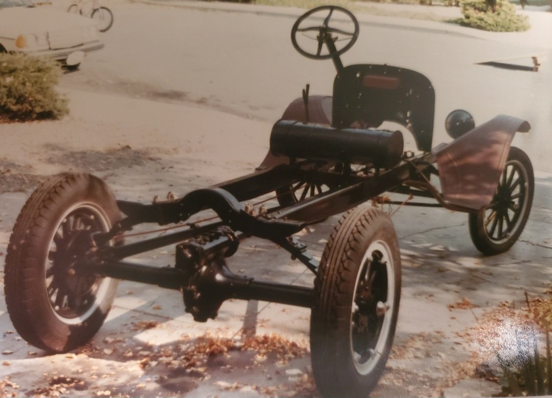

The second owner was a neighbor of the Gobles, who was 7 at the time they bought it new. He was instantly in love, and as he got older he continually begged to buy the car...finally being successful in 1930...when he was in college. The car was moved to the family farm, covered & stored in the barn....where...due to life's circumstance, it sat for decades. Ultimately, the car became a retirement project in the late 60's/early 70's.
This pic was taken when it was rolled out of the barn for the first time in the 60's (apologies for the poor quality, pic was taken looking thru a slide) The engine was rebuilt, and the sheet metal was painted. The wood on this thing remains solid, as are all metal panels. It has minimal rust, just surface spotting, no cancer, all seams intact.
Unfortunately, the man went blind before he was done...and...it was rolled back and recovered in the barn yet again. Per the son, these pics were of the car being stored back in the barn after the initial restoration. His son decided it was time to sell...where I am now the next care taker of this piece of history.....

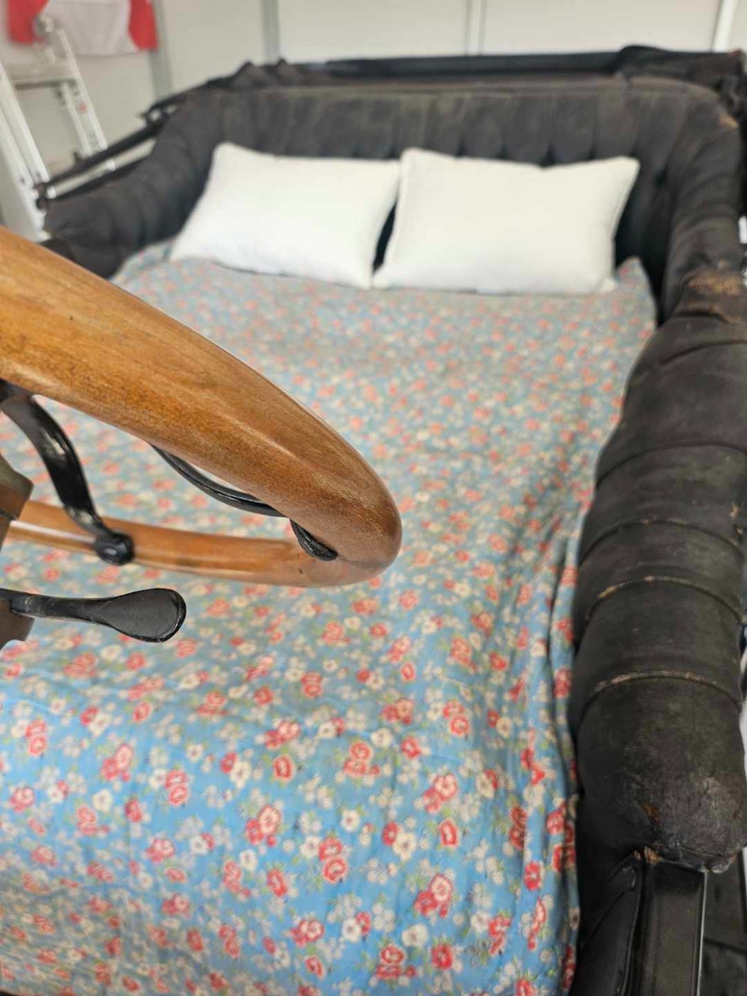

I imagine that Mrs. Goble, being a fine lady, was not as enthralled about the trip as Mr. Goble, certainly not considering the prospects of a month long trip sleeping on the ground sharing her bed with the creepy crawlies.
I bet the first and most important mod Mr. Goble made was to convert the front seat back to recline, and in so doing to make a bed to convince his wife to make the trip!
By cutting the sides of the front seat, adding in new wood to strengthen and to tack each side of the sheet metal and upholstery, adding hinges and lock brackets, enabled the seat back to be lowered and convert to a bed. Not a very big bed, all of 38"x58", and certainly no PosturePedic, but...workable enough!
Daisy Mae
Topic author - Posts: 491
- First Name: Kurt
- Last Name: Andersson
Re: Newbie (Kind of) here...
I'm sure this looked more enticing than sleeping on the ground!

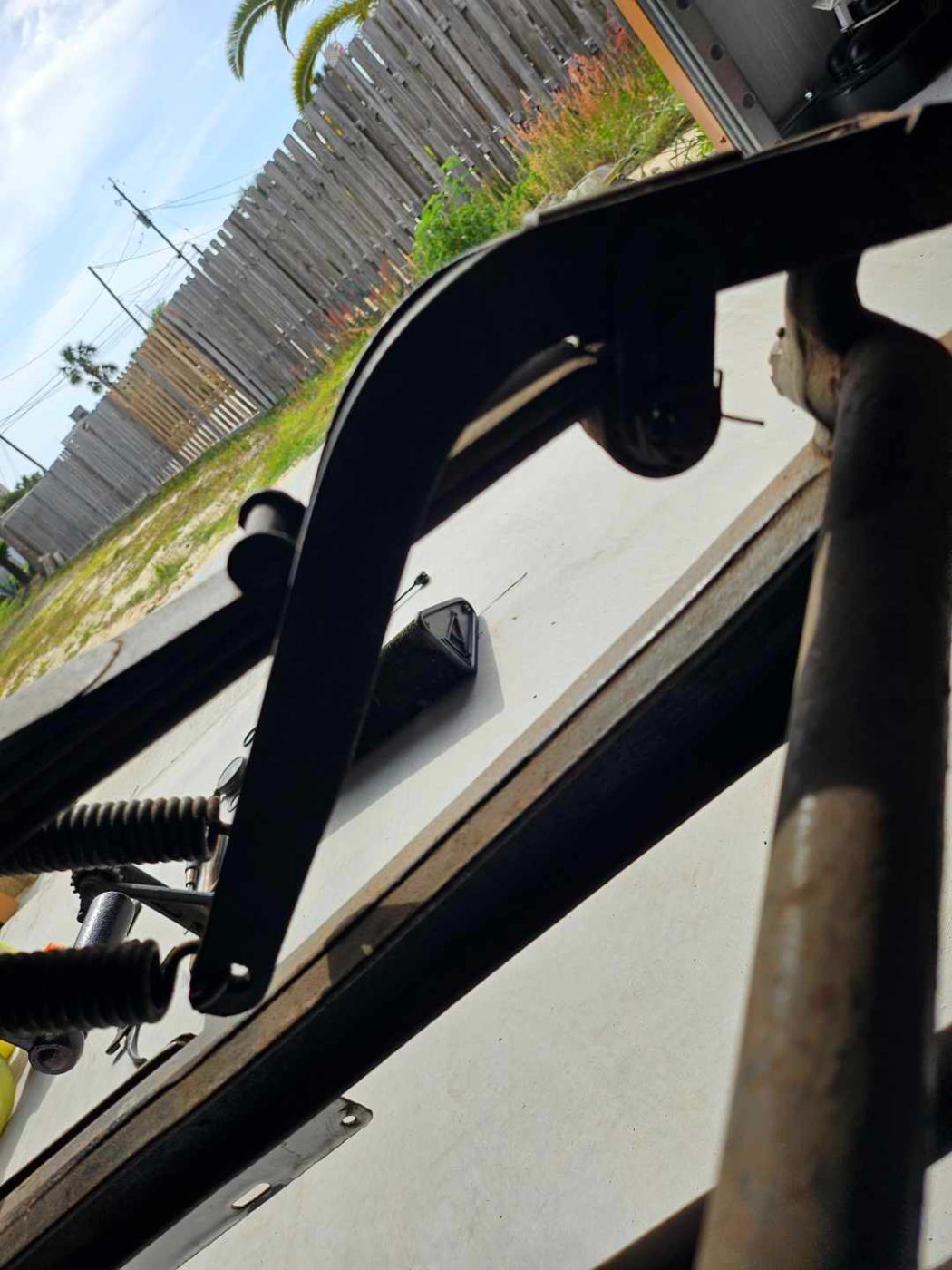

Given the lack of improved roads across that expanse of rural America between MI and CO, the other mod made to the car was to add aftermarket spring shock absorbers on all 4 corners.
Now, I have seen the common Hassler's, as well as the W&C, Liberty and H&D shocks. While these are similar design to the H&D and W&C style, the arms on mine are more straight and less curved, and made a bit differently. There are no markings on these, and I have not been able to find anything that looks similar.
Any conjecture?
Any conjecture?

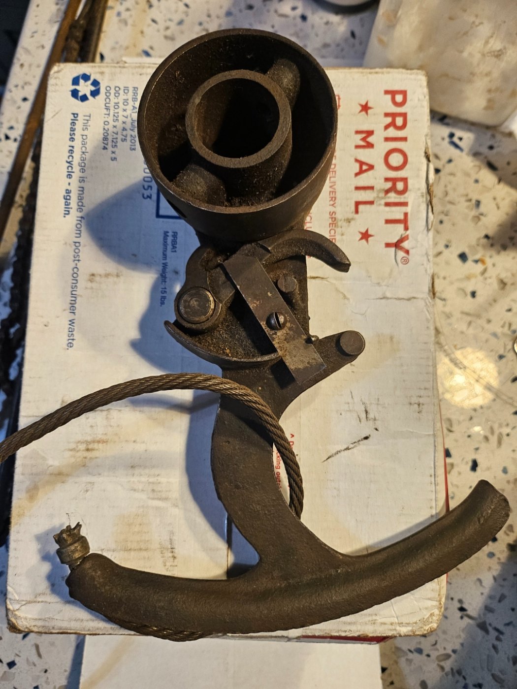

So much inclement weather to expect on a long cross country trip, who wants to get out of that nice warm bed and go outside in the mud & rain to start the car?
So...next mod on the car was to add an in cabin pull start. The only remnant actually remains on the car is the firewall tube for the pull handle, the other pieces no longer on the car, one of which now missing.
But, similar to the shocks, I have never seen this pull starter before. I have seen the Simplex, Universal, Sieverkropp, Boston...but found no reference to this one. It's cable operated vs the more common chain, but does have cast marks with the name Brinnon, and patent pending. I figured without a patent number I'd be SOL, but, a patent search using just the name was successful.
The armature is bent, probably explains why it was removed from the car

A patent search on the name Brinnon led to the application submitted Sept 22, 1915

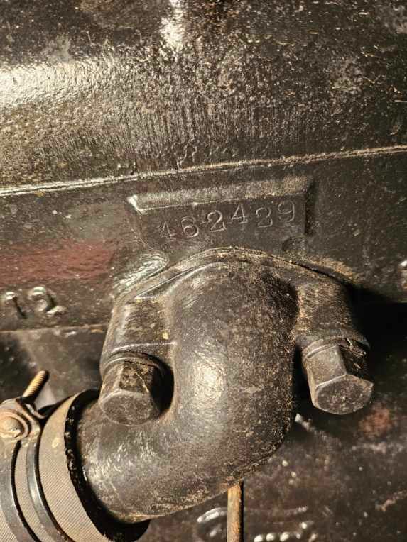

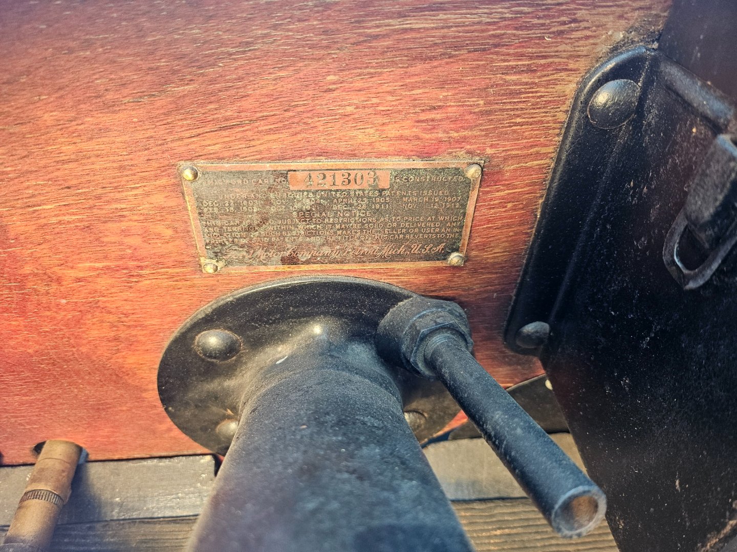

The car retains the original engine, built in April 14.
My experience being T titles use the engine # as VIN being the most common/consistent number source. So, I gulped hard reviewing the Title noting a mismatch.
Apparently from what I gather, the bodies produced by Ford in the early yeats contained a body # stamped to the patent plate. Up to 1913 there was consistency in stamping the engine # to the body plate, but, that diverged to using different #'s....or so I've read.
Such explained the Title number...it was the body plate, not the engine. Cast dates of 1/28/14 on the block, and Jan 13 on the head.

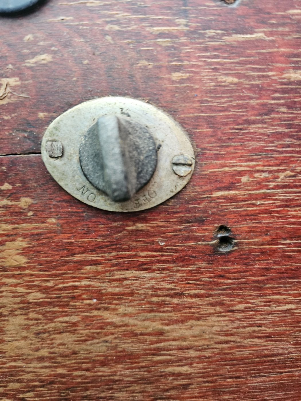

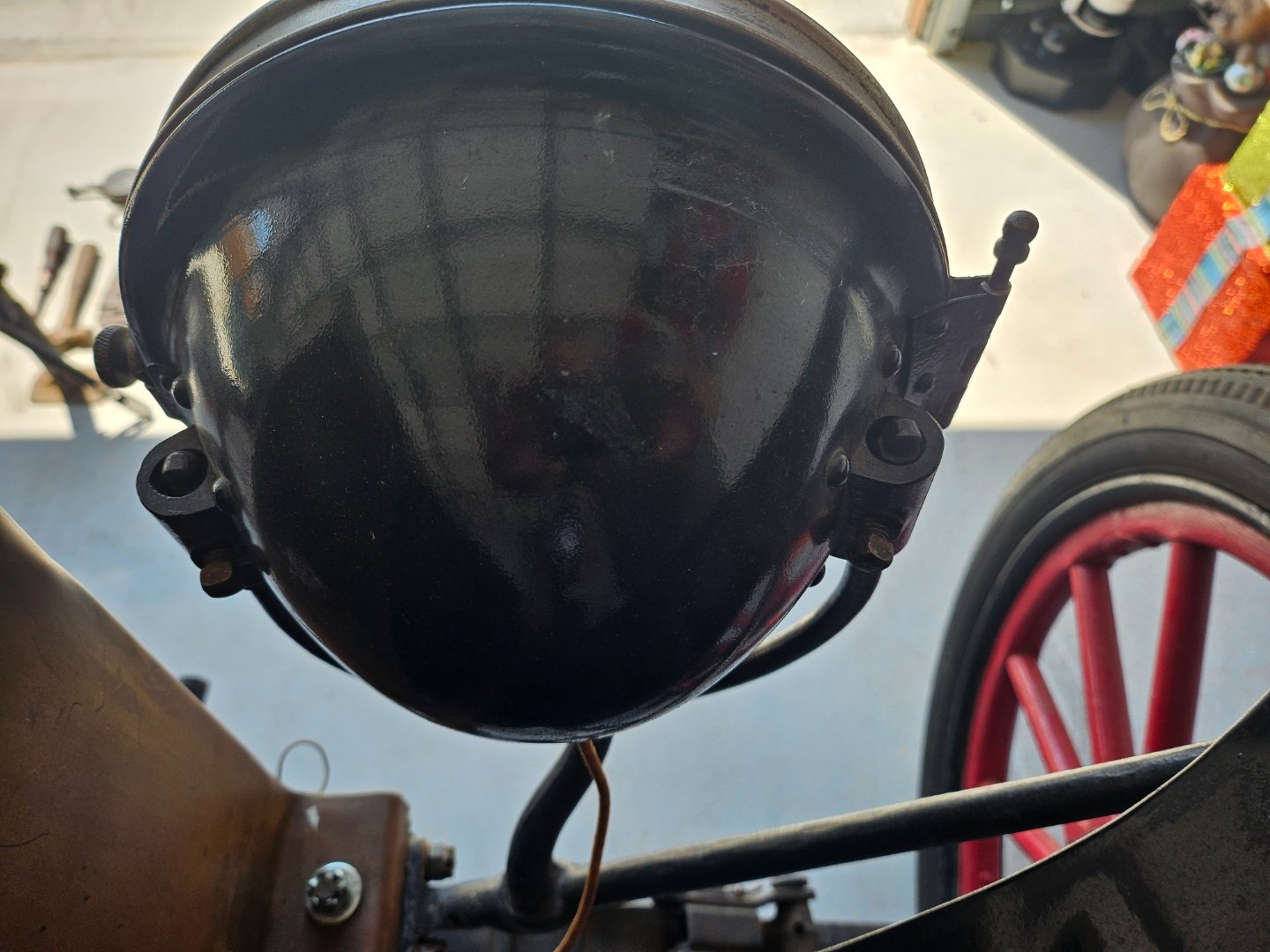

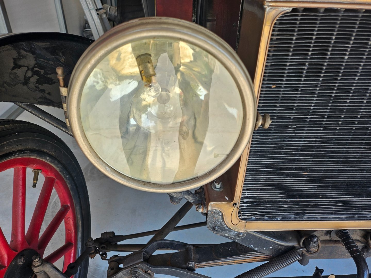

As for the headlights, the son told me his Dad stated the car originally came with the electric lights, and never had the gas headlights per his memory. I seriously doubt it came from the factory this way, April was way too early for any crossovers with '15, that, and neither did Ford produce electric pickle fork lamps, being single post design from day one, nor were they of this rim design. So, either the Ford dealer modified the car with aftermarket headlamps per the buyers request, or, he changed them out himself, maybe in preparation for the CO trip...who knows. The running board does show what appear to be mounting bolt holes for a carbide acetylene generator. Regardless, it is known, at least via first person witness, that these are correct to the car since new. I haven't yet taken them off the car to check for any manufacturer stamps, but none are visible.
The switch also looks to be a period aftermarket, a simple on off switch, that, and certainly no resemblance to the 15 style switch.
Unfortunately, there's no continuity thru the switch, so I'm crossing fingers I can repair it...

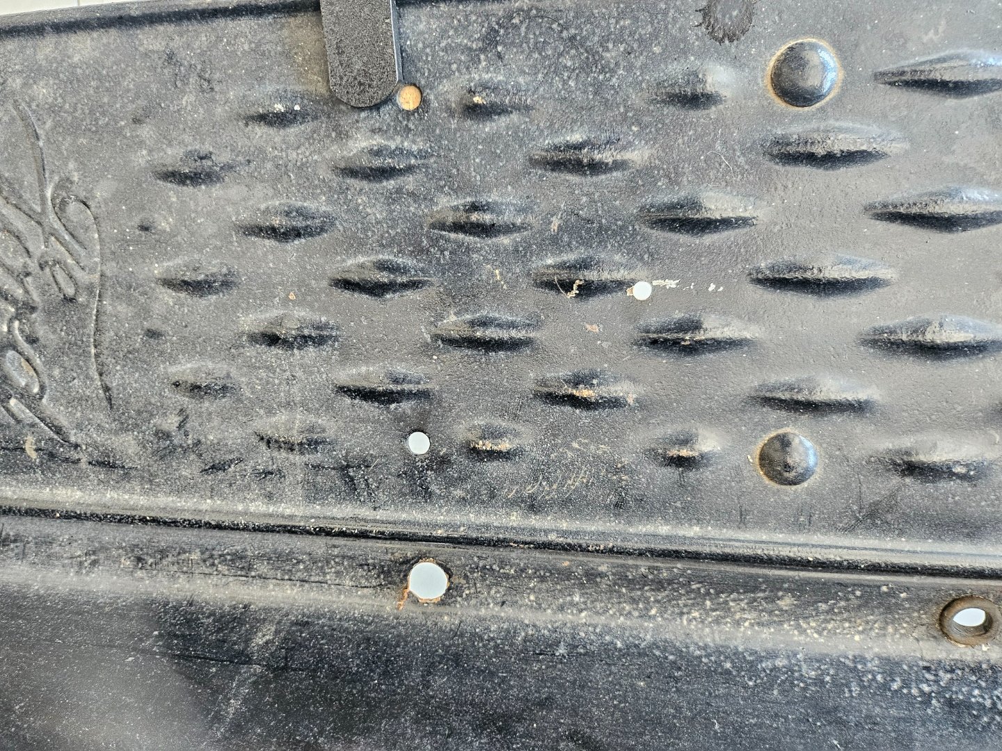

The car apparently had a speedometer at one time, but does no longer.
The only thing I'm scratching my head over is there are 4 screw holes in the dash, whereas I had thought most speedo's of the 14 era were 3 screw mounts..... ????
Thoughts???
Thoughts???

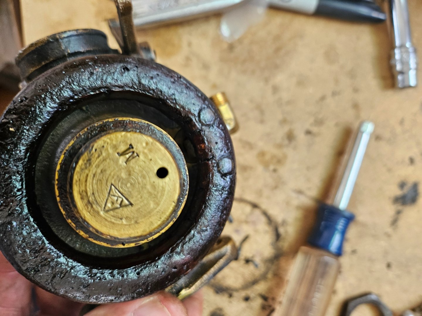

The coils that are currently in the car are a mixed bag....
From a '13 era 6 screw brass top, a '14/later 4 screw brass top, a K&W wood top, and an unmarked wood top....
Here's the two earlier ones....
Only 1 of the four (the KW) are buzzing off of 12v...
The mag on the other hand is my first hurdle to tackle, currently producing only 1.6v on a fast spin of the crank....
Dead magnets...maybe...will first recharge in car...
After a thorough prep of the engine/electronics I may attempt a first crank on a battery and see how the mag operates at speed...
If it starts. I'm just paranoid enough to believe it's the ring coils, requiring a tear down. But, that might not be a bad route either.
