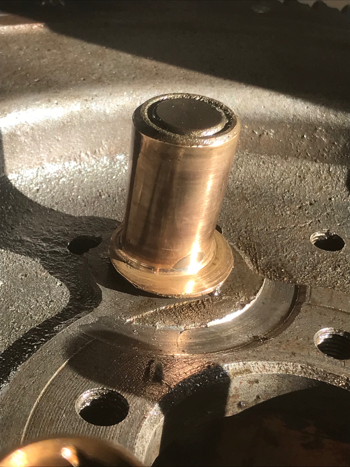

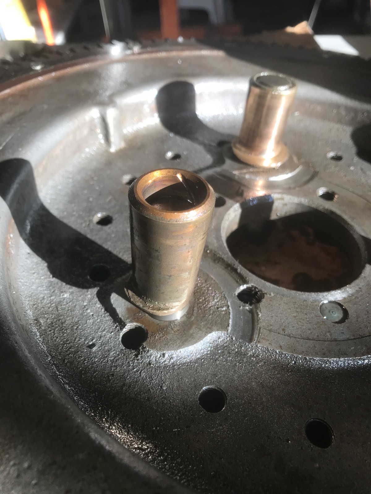

Well then, today is the day...
(Photo courtesy of Tim Juhl)
- Posts: 2310
- Last Name: Juhl
- Location: Thumb of Michigan
Re: Seized Triple Gear Bushing
Neat photo, eh? Expensive too. Now that I know the symptoms, I think the problem actually started soon after the engine and tranny was rebuilt. Even so, it kept working for over 5000 miles before finally reaching the state seen in the photo. The pins on two of the gears just spun in the flywheel while the remaining gear spun on the seized bushing.
- Posts: 5020
Did you figure out why??
Dissecting a failure such as this is important to not repeat with other fellows.
Too tight on the bushing clearance?
Some of that expanding brass?
Lack of oil?
Assembled with grease?
Must have made quite a racket as the bushings seized, maybe bucked & locked up in high for a while.
Lack of oil?

Tim - did your rebuilder or you decide to use the "early" riveted triple gears in your rebuild ? Were the rivets verified for tightness ? Just curious.
- Posts: 2310
- Last Name: Juhl
I was a total newbie at the time that I had the triple gears seize. I had no idea what was happening.
The engine and tranny were rebuilt by a very reputable rebuilder. The only explanation I can come up with is that the bushing clearance was too tight to allow for bushing expansion, a problem I know they were aware of at the time. I have a 1917 engine that I added a starter to so the flywheel was replaced during the rebuild. They also did the repairs and I've put over 4000 miles on the new tranny with Zero issues.
As to the gears, the rebuilder made the choice and I have no idea if the rivets were checked. New gears were used in the repair. I did a total transmission rebuild with new drums and components from Dave Nolting.
Before the final failure, I had two other instances where the transmission seemed to lock up ---- always after using reverse gear. It made a bit of a racket and bucked a bit but then settled down and appeared to be "normal". It was always on tour with knowledgeable people around but they had no suggestions other than maybe adjusting the bands. I think I drove it a long time with the pins spinning in the flywheel, about 3 years. I think I would recognize the problem now.

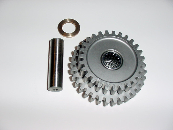

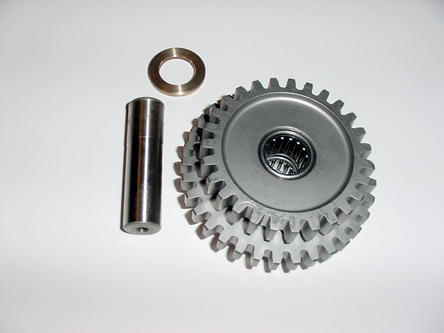

I think I win the worst triple gear bearing.... the noise was like coke cans being drug behind me when going downhill.
I got Dan's needle bearing upgrade and never looked back. Sometimes a new design actually IS better...
