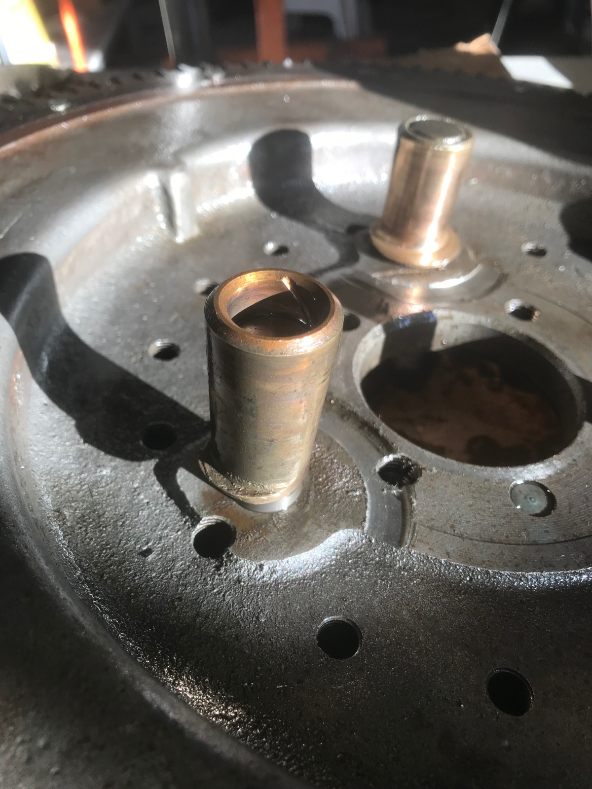

Gen3AntiqueAuto wrote:
Tue May 28, 2024 3:41 pm
I've yet to see a pin spin in the flywheel.
Well then, today is the day...
(Photo courtesy of Tim Juhl)
Posts: 2339
Last Name: Juhl
Location: Thumb of Michigan
Re: Seized Triple Gear Bushing
Post by Oldav8tor » Tue May 28, 2024 6:10 pm
Neat photo, eh? Expensive too. Now that I know the symptoms, I think the problem actually started soon after the engine and tranny was rebuilt. Even so, it kept working for over 5000 miles before finally reaching the state seen in the photo. The pins on two of the gears just spun in the flywheel while the remaining gear spun on the seized bushing.
Posts: 5299
First Name: john
Last Name: karvaly
Location: orange, ca
Post by speedytinc » Tue May 28, 2024 6:20 pm
Did you figure out why??
Dissecting a failure such as this is important to not repeat with other fellows.
Too tight on the bushing clearance?
Some of that expanding brass?
Lack of oil?
Assembled with grease?
Must have made quite a racket as the bushings seized, maybe bucked & locked up in high for a while.

Posts: 2339
Last Name: Juhl
Post by Oldav8tor » Tue May 28, 2024 8:24 pm
I was a total newbie at the time that I had the triple gears seize. I had no idea what was happening.
The engine and tranny were rebuilt by a very reputable rebuilder. The only explanation I can come up with is that the bushing clearance was too tight to allow for bushing expansion, a problem I know they were aware of at the time. I have a 1917 engine that I added a starter to so the flywheel was replaced during the rebuild. They also did the repairs and I've put over 4000 miles on the new tranny with Zero issues.
As to the gears, the rebuilder made the choice and I have no idea if the rivets were checked. New gears were used in the repair. I did a total transmission rebuild with new drums and components from Dave Nolting.
Before the final failure, I had two other instances where the transmission seemed to lock up ---- always after using reverse gear. It made a bit of a racket and bucked a bit but then settled down and appeared to be "normal". It was always on tour with knowledgeable people around but they had no suggestions other than maybe adjusting the bands. I think I drove it a long time with the pins spinning in the flywheel, about 3 years. I think I would recognize the problem now.
