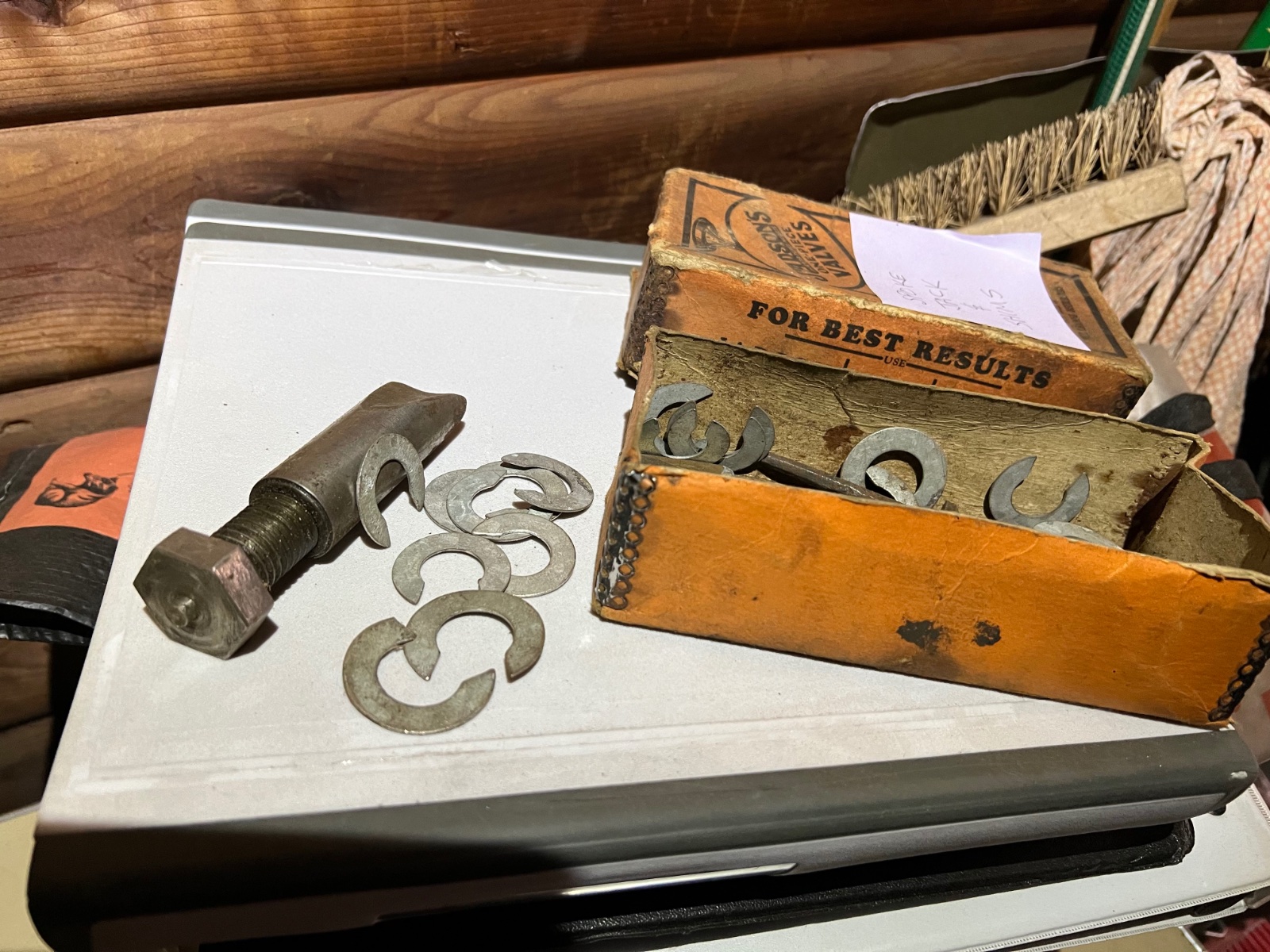

Shimming at the hub would press the spokes outward and would likely produce a gap between the tenon shoulders.
An old method of fixing loose spokes would be to use a spoke jack and shims. This older post discusses making spoke shims from thin washers.
https://www.mtfca.com/phpBB3/viewtopic.php?t=33590
I recall another post where someone described a homemade spoke jack.
Of course the preferred method would be to respoke your wheels. Read the later entries on the link above for warnings about shimming your spokes.

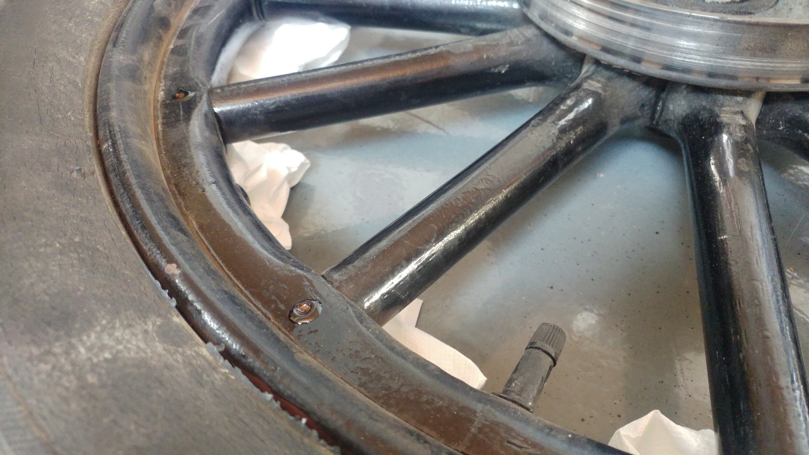

I jacked up the wheel to have a close look.
It seems the spokes have not worn out the wooden wing, but the tension is lost. No radial free play, but also no pressure on the wooden ring is the result.
Using water makes me a bit nervous. My father in law used to do so with his hammer shafts, and this finally ended up in a much looser shafts. Without soaking the shaft before using a hammer, this was a really dangerous tool. - He actually destroyed the shaft with water.....
So I think about a more durable solution.
Oil will not cause the wood to expand,again, but is an excellent protection against more water.
So I get back to this magic "spoke-jack" (which is actually a "wood-rim-jack"). It will lift the rim, so I can insert a thin shim. I think a shim of 0.5 mm thickness should be sufficient, as this will be +1.0 mm in diameter. Is a wheel elastic enough or should I use 0.25 mm shims?
Because my spoke ends are elliptical, I think about laser-cutting shims from thin sheet steel in this shape. When cutting them in two halves, I cam insert them with very little Epoxy resin as glue towards the wooden ring, So they can't move, and protect the wooden ring from wear.
Finally soak the wood in oil and apply some new black paint.
What you think?
What diameter has the peg on the spoke? Let's assume the thickest possible.
Using a piece of steel pipe with cutout for spokes and a M20 bolt + nut should give a wonderful "spoke jack"
What you think?

Some use wood shims, I prefer steel. Thickness is from 6 to 12 thou. Most preheat the rim before reinstalling the felloes and spokes. I have had no long term success shimming between the spokes at the hub or using a spoke jack and shimming each spoke where it inserts into the felloe.

The method for repairing wood felloe wheels would be to remove the rivets that hold the wood fellow to the steel rim and use a steel band or wood veneer as a shim. Not something I have done but discussed in old threads.
http://www.mtfca.com/discus/messages/80257/98511.html

The spoke jack & shim method is for demountable wheels where the spokes seat in the metal fellow.rainer wrote: ↑Sun Jul 14, 2024 9:53 amI jacked up the wheel to have a close look.

Exactly correct. For steel-felloe wheels, you can use the Regan press and install new spokes yourself. For wood-felloe wheels you can skip all the Band-Aids (some of which don't even apply) and send your wheels to a good wheelwright. Noah Stutzman is best known (because of his experience and expertise) but there are others who will also do a good job for you.

After removing the wheels and soaking those wood fellows in water, it would be to your advantage to tighten all the hub nuts. I bet you'll get at least one to one and a half turns before they are tight again. I agree with RVA23T

I only want to tell you that I fixed the problem with slightly loose wooden spokes this weekend. This may be also of interest to others who have the same situation, it costs almost nothing and is a reliable solution.
Initial sitiation:
My Model T '16 got slightly loose spokes on one wheel. I have wooden felloes, wooden spokes, not demountable rims. The spokes had shrunk and got a little play sideways, caused by hot summer and low humidity.
Of course, making them wet will be a quick fix, but with repeating that, the situation will become worse very quickly. So I definitely didn't want to do this.
The "non plus ultra" solution I was repeatedly suggested was "Rebuild wheel with new spokes". Sounds like buy a new car because it has a scratch in paint? Also no real solution, this costs more than 1000 $$$-
Solution:
Tools and things to prepare: Electric drill, very sharp ø4mm drill, 1-2 one-way syringes, 50+ grams Epoxy (resin + hardener) with open time of 15-20 minutes. Lots of cleaning paper.
Here the step-by-step guide:
Cost is minimal, time needed also less than 2 hours.
I already hear comments that the wheel cannot be disassembled any more then... NOT TRUE.
With some force the wood felloe will separate from rim. Then the spoke pin can be drilled out.

- Take off the wheel from your T and lay it flat on your workbench.
- Drill a short hole of ø4 mm and depth of ¨12mm depth from the wooden felloe towards every spoke pin. This hole crosses the gap between the wooden felloe and the 1/2" spoke pin.
- Make a kneel of cleaning paper and place it below every spoke end and wooden felloe to catch oozing Epoxy. Big open gaps I would close before with some plasticine before.
- Mix approx 50g of Epoxy resin and suck it into the syringe. I used Epoxy that starts curing after 15-20 minutes. This gives you sufficient time. So from now on you have 20 minutes...
- Insert the cone of syringe into the drilled hole and press in Epoxy until it starts to ooze out between spoke and felloe (and possibly wooden felloe and metal rim). Apply some pressure to force all air out from the gap, with too low pressure this is not ensured. Finally put an excess drop of Epoxy on top of the hole. .
- Repeat previous step on every spoke / hole.
. - All you have to do now is adding Epoxy to drops on top. This has to be done more frequently at the beginning, but when resin starts to gel, this boring time is over.
- When the Epoxy drops start to become stiff, use a sharp X-ACTO blade and cut them away. Don't wait until they are too hard. Also flip over the wheel and clean wooden fellow and spokes from oozed Epoxy now.

Keep a close watch on that wheel, looking for signs of re-loosening.

Not a critique just a thought about the epoxy.
Worried about adding some moisture to wood with the concern being eventually softwood and now adding a more dense or hard or brittle component to the wood that could change the flexibility or springyness at the point of interference of the wood with the epoxy.
Dont take we wrong, I would do the same in you situation but I would look in the the physical properties of the epoxy chosen to use against the species of wood the wheel is made from.

RAV23T,RVA23T wrote: ↑Sun Jul 28, 2024 12:50 pmNot a critique just a thought about the epoxy.
Dont take me wrong, I would do the same in your situation but I would look in the the physical properties of the epoxy chosen to use against the species of wood the wheel is made from.
what moisture do you think about? The wood was and is bone-dry and Epoxy contains almost no water. I had a close look on condition of the wood, this is hard wood with fine strands (or whatrever the right name is). It drills very well. I would rate the overall condition of wheel as very good (except the gap because of wood shrinking).
Physical properties...
Yes, I also thought about that, but I see no problems because of following reasons:
- Dimensions of where Epoxy is used is small (only around the spoke pin). So different expansion by temperature and humidity causes almost no changes.
- Chiccory is very strong and allows forces of up to 450 kg/cm². And Chiccory is elastic. The Epoxy I use is approved for aironautics and allows forces of up to 650 kg/cm² and is also not brittle.
- What I have now is some kind of a resin-sleeve between spoke pin and wooden fellow, filling all gaps without applying further pressure. The pin is simply sitting a perfectly matching hole again. In addition, some Epoxy was absorbed by the wood. So even when the surfaces inside the gap are a little worse, this is fixed now. All loose wood-powder absorbed resin and is embedded in resin now, so the link is now very stable.
- Epoxy also keeps water away (so the wood will not swell and shrink so much and often any more). The spoke is either painted or inside of Epoxy.
This is a picture of my wheel. Picture was taken before cutting off the excess drop of resin at every drilled hole. Now the felloe is flat and smooth again, like all the rest of it. Here two short videos (cannot upload here):
Camera walk along the felloe: http://www.hantsch.co.at/_temp/WheelRepair.mp4

My concern filling the gap is it goes against the normal press fit tensioning.
A normally assembled wheel has the rim pressed in or shrunk on.
A good repair is having the wood fellow made larger by adding a shim, wood or metal, around the OD, heating the rim to tight shrink fit the rim.
Your fix has no press fit. I would not do such a "fix" on a wheel intended to be driven as opposed to a museum display.

If you would have carefully read my posts, you would know that the spokes have perfect radial fit (along their length) and the wooden felloe is sitting well inside the metal rim (does not move as it would when there is no perfect fit).speedytinc wrote: ↑Tue Jul 30, 2024 8:14 amMy concern filling the gap is it goes against the normal press fit tensioning.
The only thing that had to be done is getting away the sideways-play of the spoke pin within the wooden felloe before the wheel gets worse, and for that your suggestion is absolutely wrong. Shrinking the wooden felloe by re-mounting the steel rim with some shim increases the axial pressure to the spokes, but does not remove the gap between wooden felloe and shrunk spoke-pin (because of drying). So what you suggest will temporarily make the play invisible, but the spokes will wear out the wooden rim again, and then it is back, often worse than before. I would agree if the entire wheel is loose, but this is not.
I think as Mechanical Engineer I have sufficient knowledge to evaluate the condition of things.
But do as you like, I don't throw 1000+ $$ out of the window for fixing the wrong things by building up a wheel from scratch, when a simple injection of Epoxy gives at least the same result and stability. I was meanwhile in touch with many restorers, they all told me that my repair is the best possible.

As I understood, your spoke(s) had some side movement. They would not provide the support between the fellow & hub as designed.
Filling the gap doesnt put the tension back in.
As a degree'd engineer with "sufficient knowledge to evaluate" & the opinions from all the many restorers on the matter, why do you bother to ask this forum?
Having your wheels completely rebuilt from scratch with shipping to the States may cost $1000, but taking to a local wagon wheel-rite or DIY to add shim to the fellow & get the strength of the wheel back as new would be relative pocket change.
I got no dog in this hunt. As long as YOU are happy, good for you.

Final status:
Spokes sit rock-solid. Absolutely no play anywhere. If my other wheels will start with the same issue, I know how to fix it.
I still can only recommend this solution.
Today I saw that the tire started cracking on the same wheel. It is a very old Olympic 30 x 3 1/2. I guess it is at least 15-20 years old, so brittle it was. I could see the carcass at the border of the rim when prying it up a bit, so it was highest time to get it off.
This gave me the ability to also check the sit of the sit of metal rim on wooden felloe. Rock solid, as before my repair with Epoxy, with absolutely no play. (All I have to do is stop the fine rust inside the steel rim, apply some paint, and mount the new tire.)
