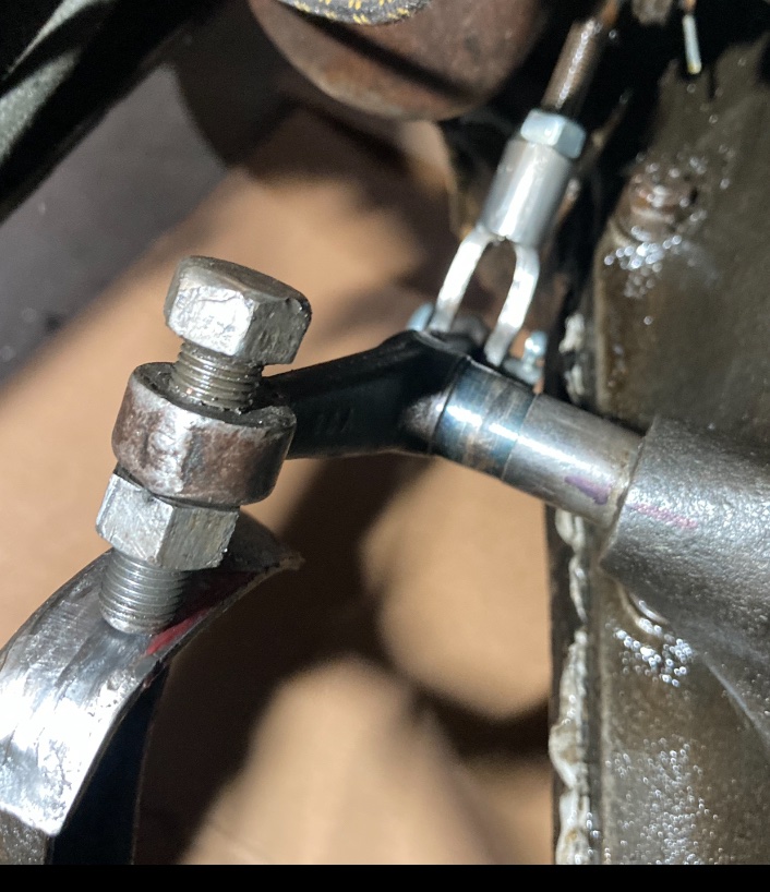

Your statement about low clevis distorting questions the correct linkage adjustment. Recheck & compensate for worn/sloppy linkage holes & shafts/pins.

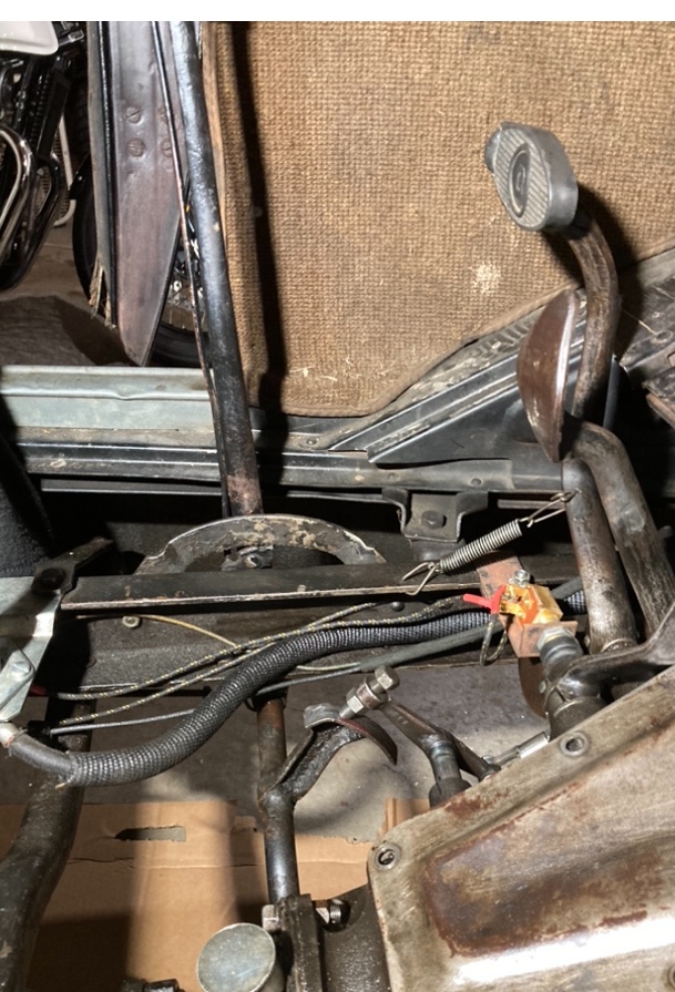

My problem is that when the parking brake is set to neutral, the parking brakes actuate.

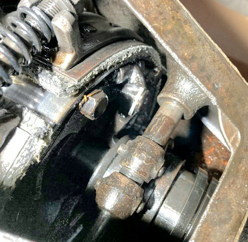

There must be a sweet spot on the cam so the car can be pushed around, between high and parking brake activation?
Mark Chaffin
- Posts: 4784
- Last Name: Chaffin
- Location: Lake Elsinore
Re: 26 T Clutch not disengaging

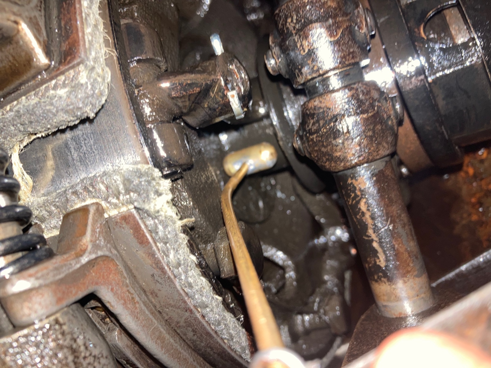

It appears in the picture shown your brass clutch collar cam is in the wrong position. It should be position in the slot above the slot closest to the clutch fingers. It looks like the ring is between the spring and on top of the clutch collar.
- Posts: 7166
Well spotted Mark, I think! The question is how in heaven could it have been fitted that way?

I have to take a look in there. Would that limit the clutch from disengaging? To correct it, must the whole trans be torn down, out of the car?

To help with Mark Chaffin's 's fix, the transmission cover has to be removed. And that involves disconnecting your battery, removing the starter, removing your band adjustments so that the hogshead can be lifted and to reposition the collar on the clutch adjustment. It would help to have someone with Model T knowledge to help and also an extra set of hands....... Your picture shows a relatively dry transmission, I would think it hasn't been run in some time because of that problem that you found. Suggestion of 10w30 multi weight oil will help engine performance.

Not seeing what Mark is seeing. I see something a different color in front of the clutch spring, but the throw out arms don't lineup to it.
Let's see a picture from a few inches further back of the throw out arms & brass collar in the throw out bearing (double shiv pulley) to be sure.

Just curious what effect the misplaced collar has on the clutch operation. Someone had the HH off, there are traces of old white sealant around it. The pedal thru holes are worn. I would like to find a machinist who could rebush them and add seal counterbores, at some point.

If the collar is mislocated, thats a serious issue.
I cant tell with the angle of the one picture. I am not clear enough to say it needs to all come apart.
Take a shot with the camera further back & further forward, as I suggested previously.

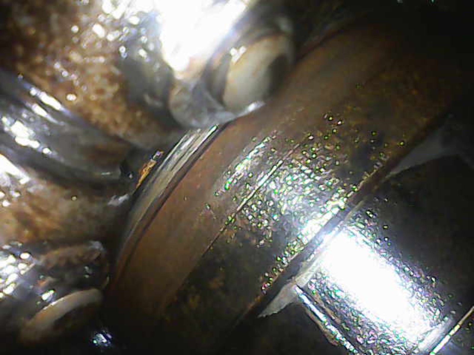

More aft of the pedal shaft? I'll get some shots tonight. I have a borescope also.

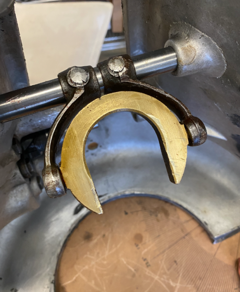

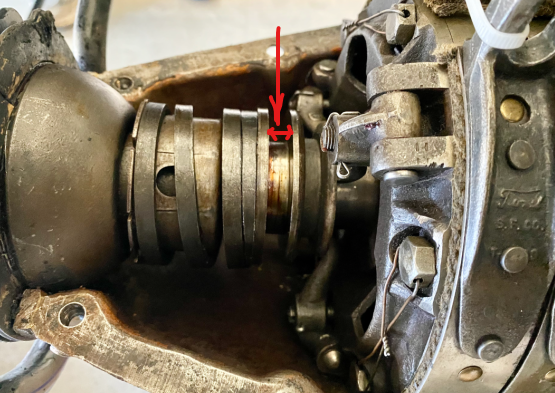

The sliding clutch collar is positioned so that the spring itself seats on the "wide" flat side of the collar with the adjustment screws riding on the end with the bevel - I don't believe one can insert the throw-out fork into the wrong slot & replace the cover - looks correct to me.
- Posts: 4400
I agree. I have had the collar drop into the wrong slot while installing the hogshead. Things bound up and the hogshead would not go down all the way. Plus, if the OP's collar does somehow happen to be in the wrong place, I believe he'd have some very obvious problems, beyond his current issues. Still, the photo that's been requested may still be very helpful.RajoRacer wrote: ↑Fri Sep 06, 2024 12:48 pmThe sliding clutch collar is positioned so that the spring itself seats on the "wide" flat side of the collar with the adjustment screws riding on the end with the bevel - I don't believe one can insert the throw-out fork into the wrong slot & replace the cover - looks correct to me.
To the OP, here is what we're trying confirm...
THIS...
FITS IN HERE...

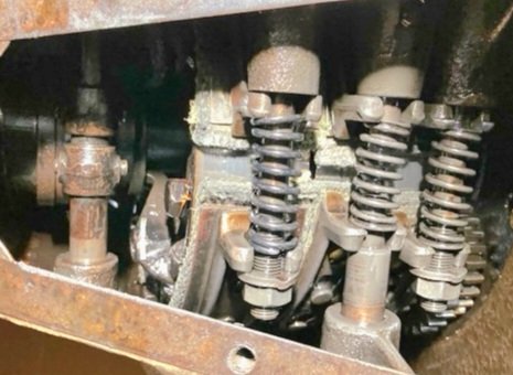

I cant get any more pics to load up.

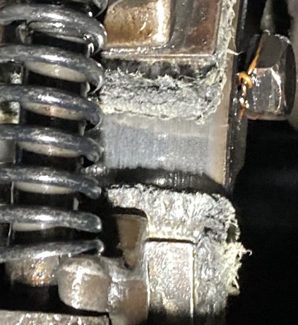

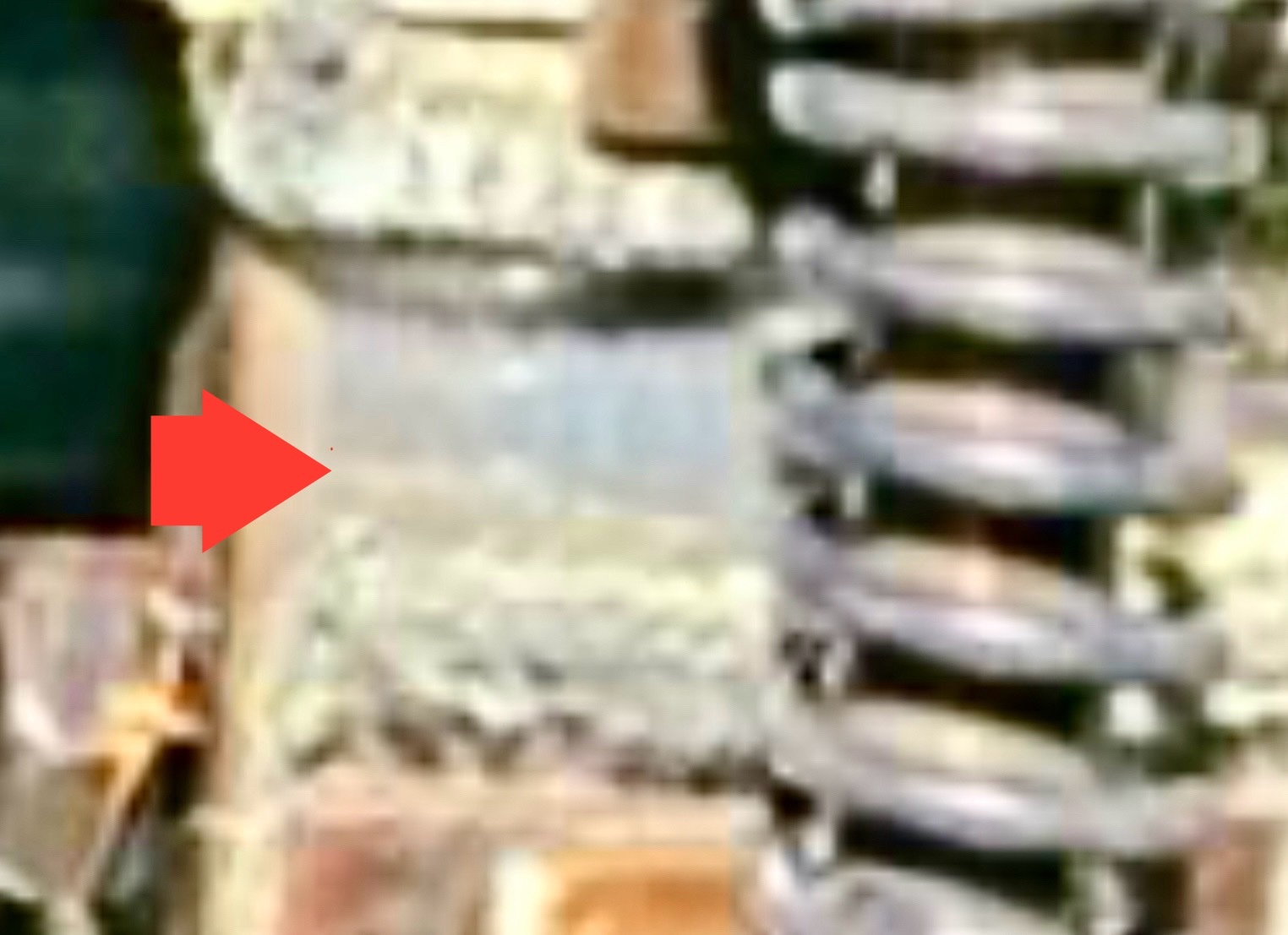

Here are 2 more of Recklesskelly's pictures Horseshoe looks to be in the correct position to me.
- Posts: 5167
Agreed. The different colored ring appears to be the end of the spring.

With the inspection cover off, can you see the clutch lever move when you move the parking/clutch lever from "parking brake" position {close to your seat bench} to the fully foward {towards the fire wall}?
I'm thinking the Ramp bolt on the lever might be out of adjustment and you can only get free/neutral on you left/clutch pedal.

The ramp bolt was worn down, it had a bevel on the end from wear. I took it out and filed it smooth and then emery paper to the ramp and bolt end, turned it down to get full clutch shaft rotation when on the ramp with the bevel of the bolt end mating to the shoe and a bit of grease. I had replaced the bolt but it ran pretty rough on the shoe. With the bevel profile on the bolt, less wear on the shoe is a good thing?

With the clevis pin removed from the the clutch arm, I turned the clutch shaft to full disengagement with a vise grip and marked a line on the shaft and the HH. I set the bolt to get actuation at the mark. The brake lever is canted back slightly when the bolt is just on the shoe. In that position the brake rods were pulling. To put it right, I only end up with two rod threads in the brake rod clevis. There isnt an adjustment on the brake lever, it looks to be riveted onto the cross shaft.

I found these drop forged yokes on ebay, They are 1/2" longer than the original. I need .60 longer to get 8 rod threads into the yoke with the cam and bolt positioned as above. These yokes should give me 5 threads in. Im not sure if there is enough rod travel to get the lever full forward so the bolt clears the other end of the shoe without them bending, I have to put the rods on to check that. Did a '26 come stock with fiber brake linings?

Yes on the lined parking brakes of a 1926-1927. Your low band seems tight on the drum though it may not be. The spring seems to be compressed more than usual but it may be due to a worn band lining that was adjusted to compensate.
May be nothing but is that a crack in the brake drum? Can’t really tell, may be residue?

Its a rust stain. The low pedal is an inch above the floorboard when pressed snd the left side is a little loose. The right side looks tight against the drum.

After oiling the brake cam shafts and moving the rods in and out a bunch of times, the wheels freed up to spin in neutral. That was the major problem.

John, I am surprised no-one suggested taking the bolt out of the clutch shaft and putting it in from the bottom. That will give you a much larger contact area on the cam and reduce the wearing of a channel in its surface. I radius the bolt head on two opposite flats so you have a more gentle lead in on the cam. The nut is then on the top and and serves the same locking purpose as before.

Allan, That was what I was thinking too as far as wear, but wouldnt that essentially elongate the shoe? It may require the brake lever to be pushed further forward, bending the brake rods.
I think the angle profile on the bolt end is a good idea along with a little grease. I could losen it a turn or two so the clutch shaft isnt so stressed.
I have the oil draining now. It was overfilled and the excess oil looked a little dirty. I could have driven the car today except that I left one of the yokes at work when I was measuring it. I think the original yokes are fine now with the proper brake action.
