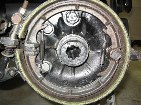

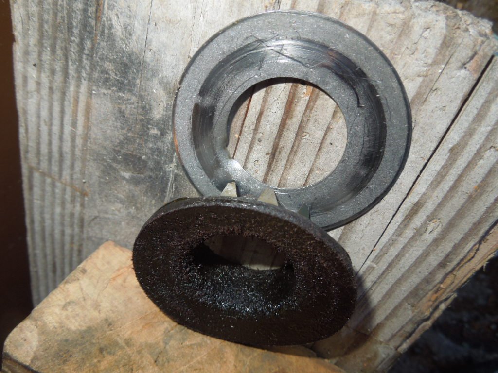

1926-27 had the pressed steel washer with fingers that used a leather seal.

Re: New style of rear axle oil seal, you ever tried it?

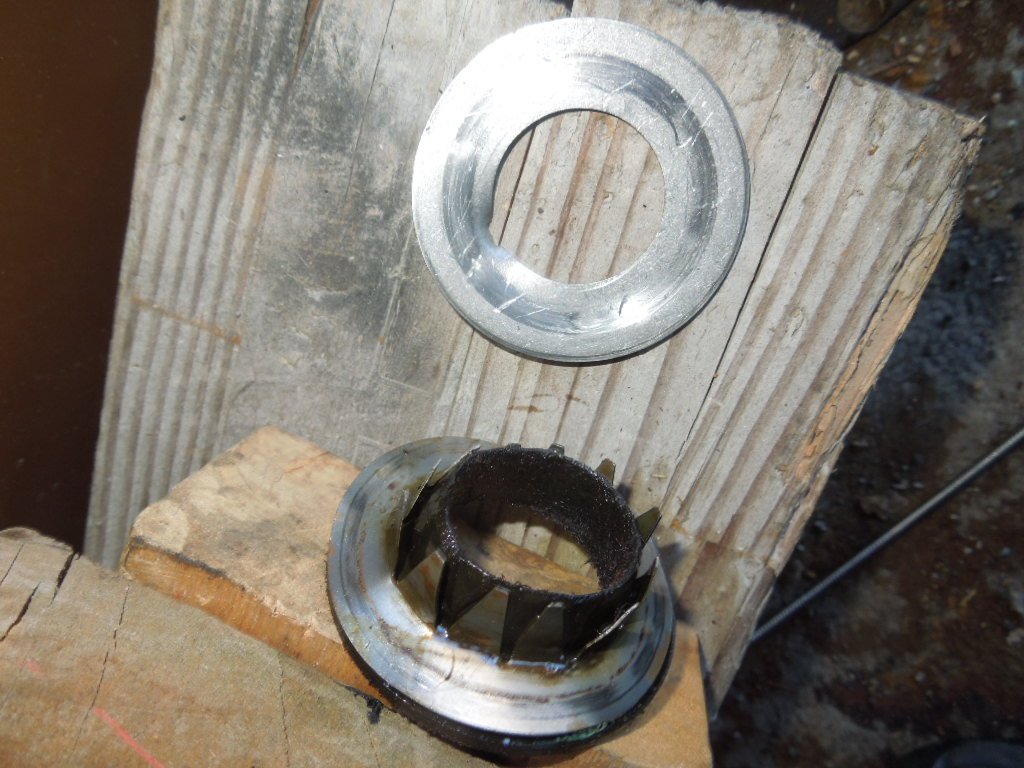

That sounds like what I found on the other side yesterday, this side was leaking badly.
I followed the TWrenn advice with the Neoprene seal and will nail it up today.

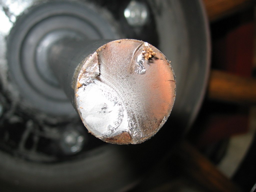

Use caution if using the Ford type leather & steel finger seals - after the leather wears down, one has steel fingers attempting to groove the axle shaft and we all know what happens at that point !

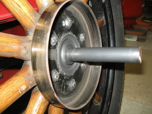

Here are some pics of one of my 1924 rear axles after the Ford style leather and spring steel seal cut a groove into the axle, creating a place for fatigue cracking to start.
