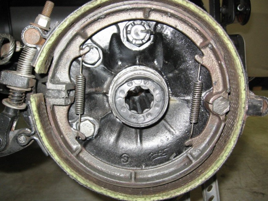

That sounds like what I found on the other side yesterday, this side was leaking badly.
I followed the TWrenn advice with the Neoprene seal and will nail it up today.
[attachment=1]DSCN5043.JPG[/attachment]
[attachment=0]DSCN5044.JPG[/attachment]

Now where did I see the diagram, (actually a drawing), of the axles being wrapped with felt “rope” in a screw pattern to wind the diff lube back into the pumpkin? There was a right and left method to the wrap so that forward motion would wind the lube back to center. Isn’t that what we’re looking at here in the first pic?

Probably but this isn't felt rope, a pair of lady's nylons. I guess it works the same.
They have been in there from the mid 90's at least with no issue.
