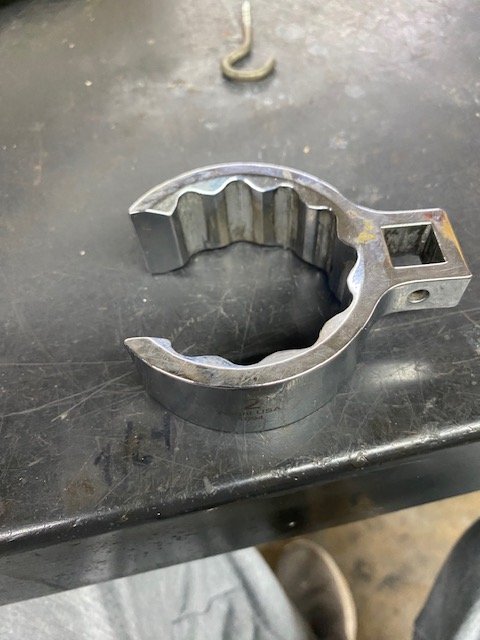

I bought one of these several years ago and it does a great job of tightening the nut without any fear of rounding the corners of the nut like the original open end wrench.
It fits the 2 inch nut very closely and the gap will slip over the pipe. An extension and a ratchet is all you need to snug the nut up. I bought it off of Ebay.
