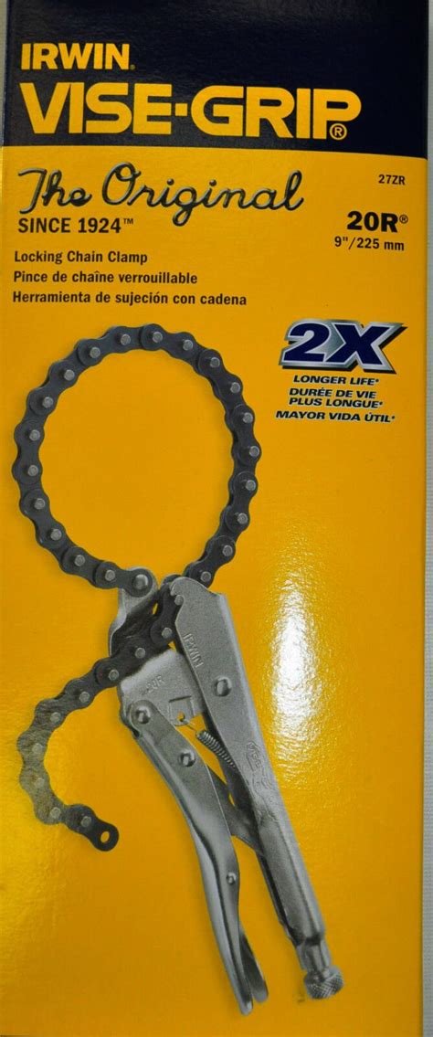

How about the incorrect tool previously to turn the pack nut such as pipe wrench or chain vice grips like these:

Richard I was there when the pack nut was installed using my original pack wrench. The flange on the repo exhaust pipe didn't seem to tighten properly so the nut may have been overtightened somewhat. We're going to replace the pipe also. I personally believe that the design of my '17 muffler is superior --- I especially like the little tail pipe that carries the exhaust away rather than coating some of the underside components.
