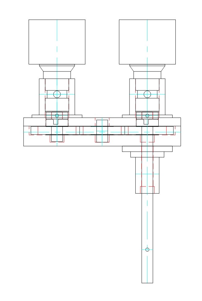

Several years ago, I designed a dual distributor setup as the current options available are very limited an expensive. This project was shelved when COVID happened and the cost for materials skyrocketed. The design utilizes two independent Bosch 009 distributors driven by a main shaft and three separate gears. Each distributor head can be adjusted (advanced / retarded) independently to suit specific engine performance requirements. Replacement parts plentiful. The unit is designed to mount to a Bosch front plate and utilizes the same Bosch gears. I am considering a production run; however, a quantity of 50 units will be necessary to keep cost as low as possible. Please let me know if you have interest in this project. PM's, calls and text messages appreciated. Mark Chaffin (951) 805-0928

Yes. I designed this for use with out RAJO head with dual plugs. Both heads turn same direction (clockwise rotation).

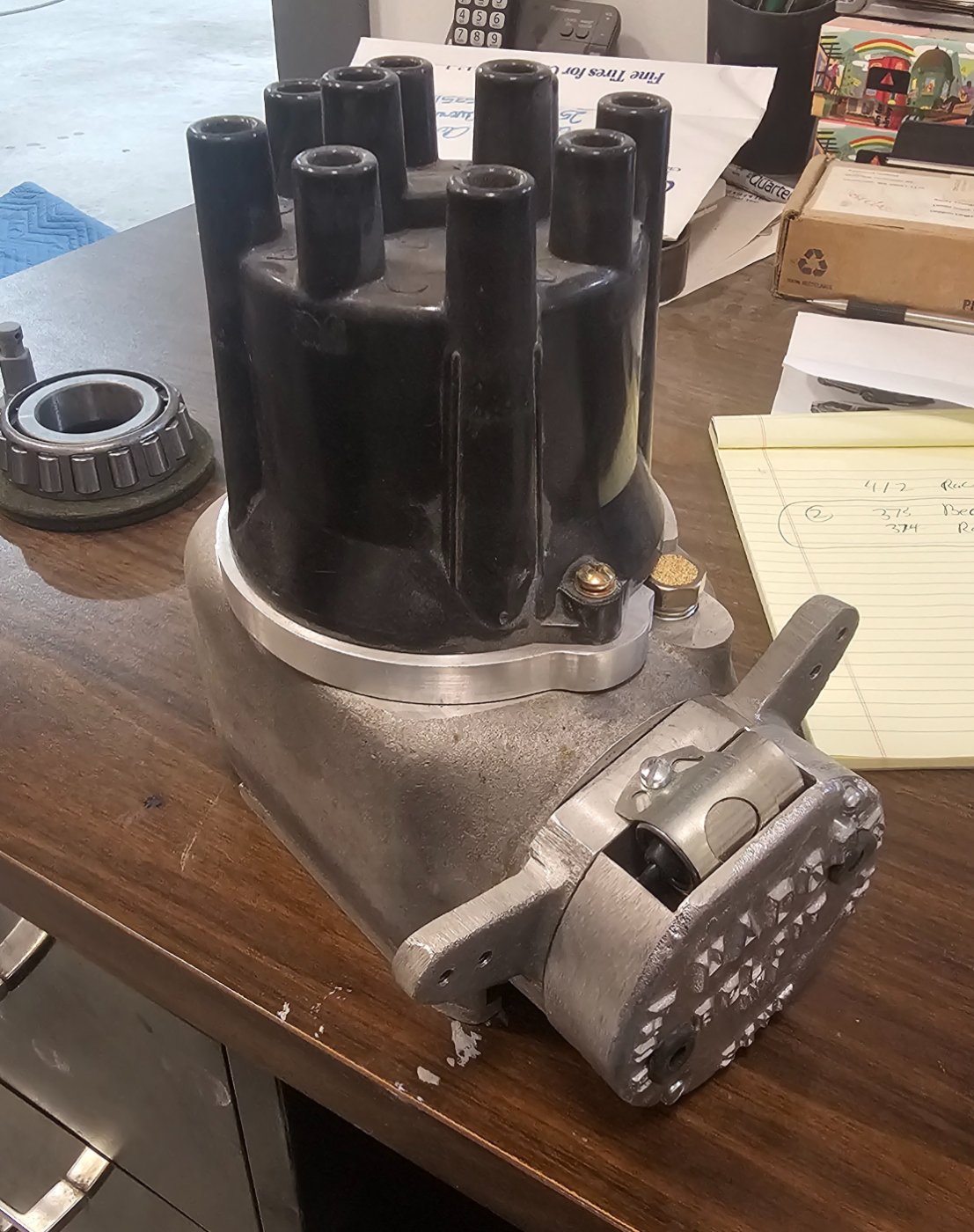

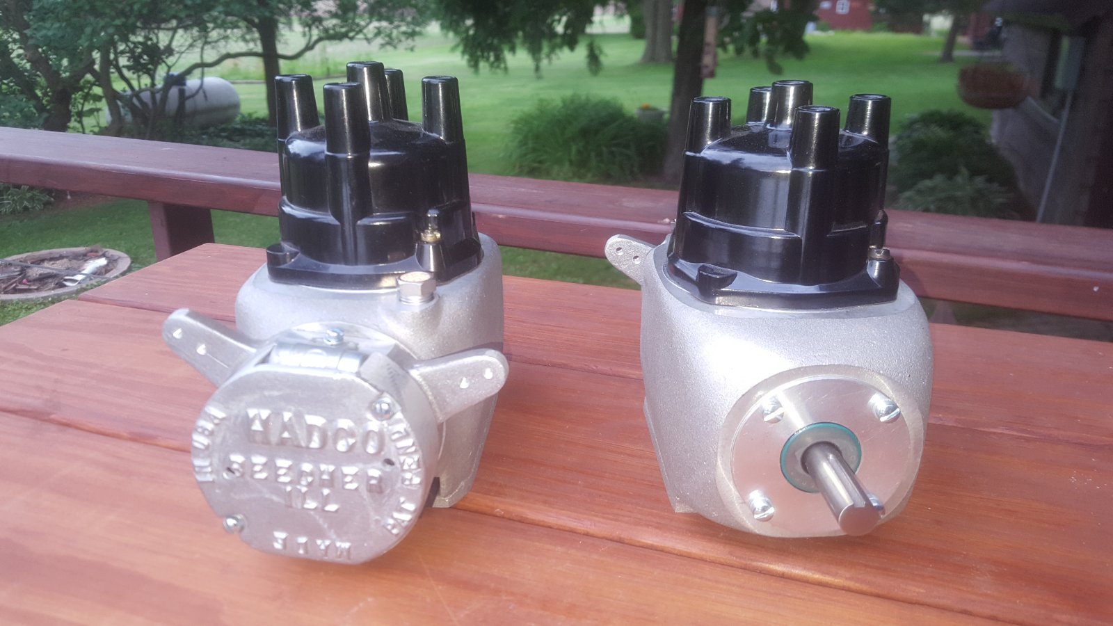

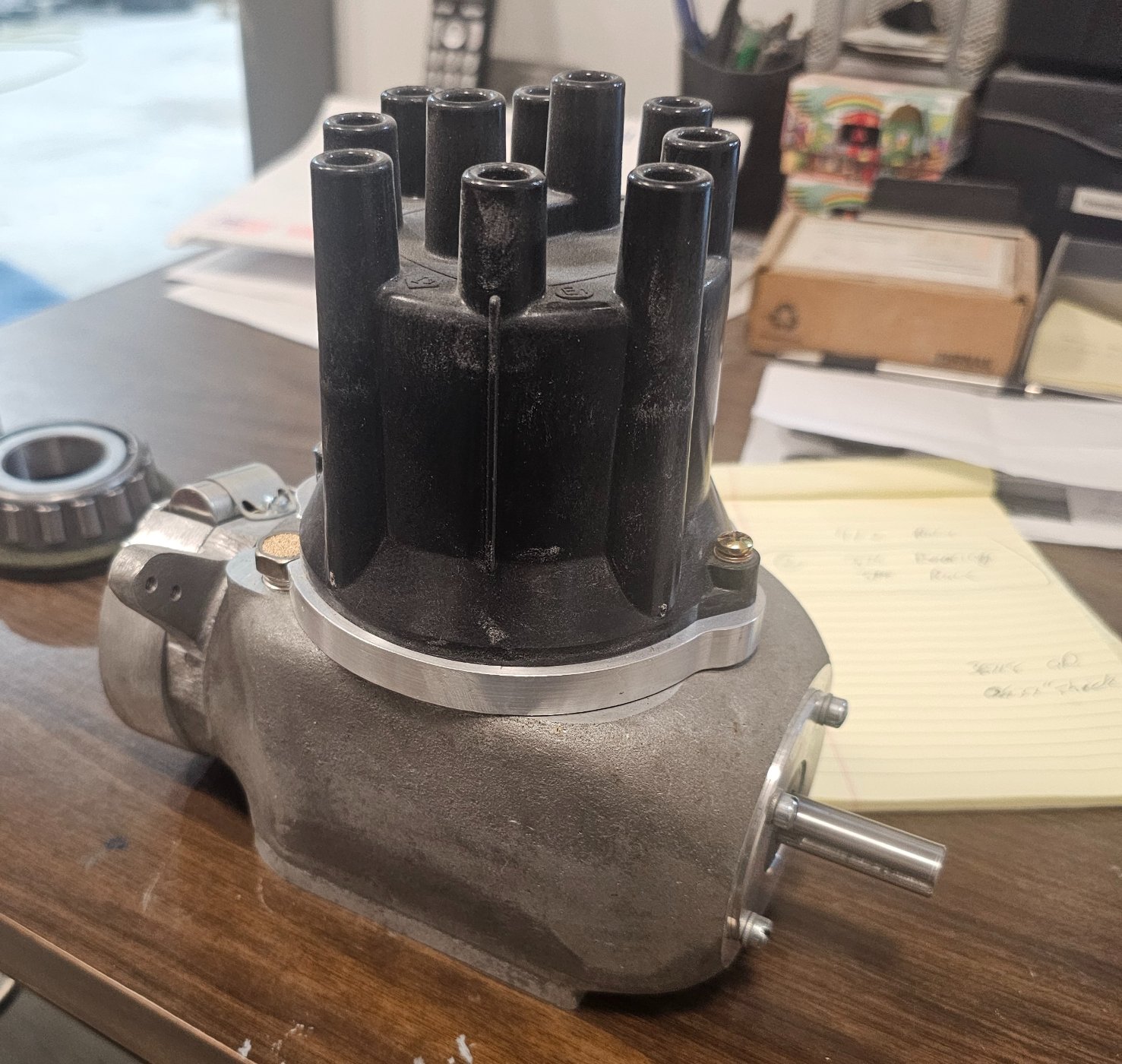

I have a dual fire distributor set that has been made for about 20 years. bolts into Bosch mounts. will post pictures in a minute.

I have read in the past that sometimes when setting up, the two banks don't fire at the same time, one is just a little offset from the other.

Post by Tim D » Wed Nov 13, 2024 10:08 am
Here is the picture.

I can have one ready to ship in a couple of days. $975 plus taxes and shipping. I also make a single fire one. I will post a video later.

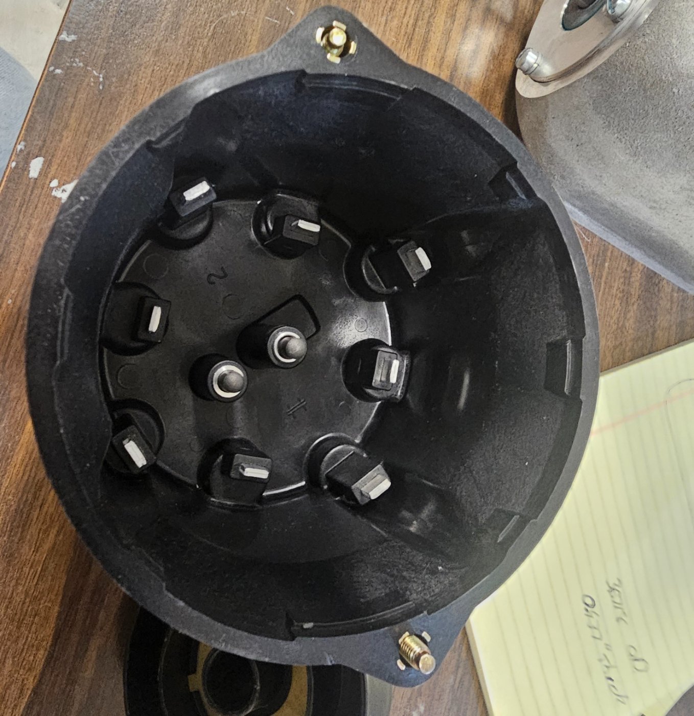

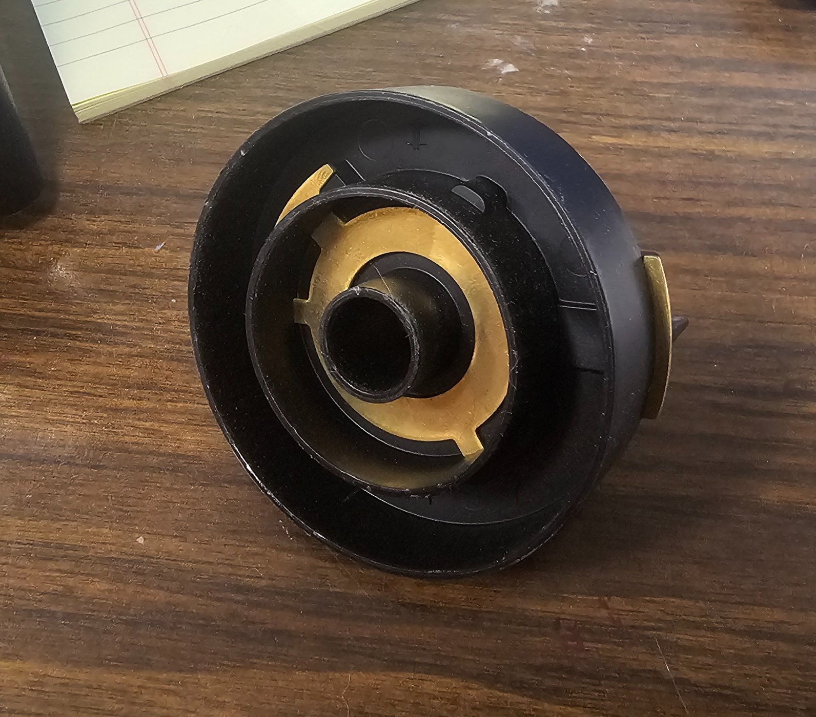

My set up uses chevy points. And the cap is a off the shelf Nissan pickup truck cap. No way for it to be off when firing.

Post by Tim D » Wed Nov 13, 2024 10:32 am
Here is the single fire 4 cylinder.

For my set up use a 6 volt or a 12volt depending on the the cars voltage. and will run in either direction.

Years ago I successfully adapted an 8 plug Nissan distributor to a Bosch front plate to fire a dual plug set up.

I’m planning to use a Onan 2 cylinder coil in combination with the Nissan cap and rotor to try on a dual plug T head. The Onan coil fires 2 plugs at the same time. This way all they have is points running off the camshaft and no distributor parts are needed. There may be factors I’ve overlooked but I plan to try it.
A distributor that I’ve used in the past is the Vega one as it rotates the appropriate direction and with the combination of centrifugal and vacuum timing control it negates the need to have a spark control lever. I first used this back in the’80’s on a A crank counter balanced T speedster and I was totally satisfied with it. The car is capable of 100 mph and still exists (I sold it years ago)
