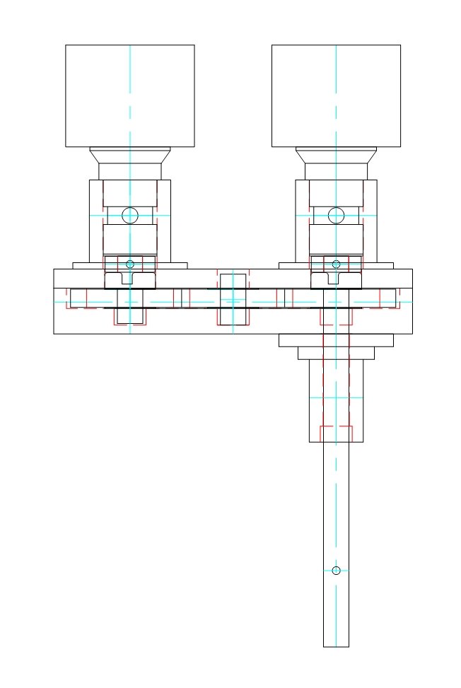

DUAL DISTRIBUTOR SETUP
Several years ago, I designed a dual distributor setup as the current options available are very limited an expensive. This project was shelved when COVID happened and the cost for materials skyrocketed. The design utilizes two independent Bosch 009 distributors driven by a main shaft and three separate gears. Each distributor head can be adjusted (advanced / retarded) independently to suit specific engine performance requirements. Replacement parts plentiful. The unit is designed to mount to a Bosch front plate and utilizes the same Bosch gears. I am considering a production run; however, a quantity of 50 units will be necessary to keep cost as low as possible. Please let me know if you have interest in this project. PM's, calls and text messages appreciated. Mark Chaffin (951) 805-0928

Re: DUAL DISTRIBUTOR SETUP
Great for duale plug heads. Do they both turn the same direction? I once got hired because figured out that both distributors on a very old
American La France fire truck turned in opposite directions but the plug wires where set for the same direction of rotation.
Yes. I designed this for use with out RAJO head with dual plugs. Both heads turn same direction (clockwise rotation).
This fascinating!! Would be a more-rough version be available? Would love to adapt the system to my A block.
Not enough interest. Actually none. Big layout of cash to make 50. I have had several other projects where interest was expressed and a ton of money was spent and in the end, no one stepped up.
Dual propagation found a use in aviation, but mainly for safety.
In racing, did more trouble than value. Esentually, it just changes the timing by accelerating the flame front constant.
On a 4 cylinder, you would have to operating at 10k rpm to benefit.
I may have what you need. Somewhere I have an adapter that was made to use an early V8 Ford distributor on a Model-A/B engine. Basically the early V8 used two separate distributors, -each firing one bank of cylinders. Send me a PM with your contact info if you are interested.Retson Ross wrote: ↑Tue Nov 12, 2024 6:11 pmThis fascinating!! Would be a more-rough version be available? Would love to adapt the system to my A block.
I have a dual fire distributor set that has been made for about 20 years. bolts into Bosch mounts. will post pictures in a minute.
Why not split the plug wires, so that they fire two plugs at once? It would probably require a smaller plug cap to keep the cap and rotor alive.
Or use a coil for each cylinder, one plug positive and the other one negative? You could use the body of the distributor to trigger coils. Just thinking out loud here.
I can have one ready to ship in a couple of days. $975 plus taxes and shipping. I also make a single fire one. I will post a video later.
My set up uses chevy points. And the cap is a off the shelf Nissan pickup truck cap. No way for it to be off when firing.
Because it would always fire the plug with the path of least resistance. Never fire both.Ed Baudoux wrote: ↑Wed Nov 13, 2024 10:19 amWhy not split the plug wires, so that they fire two plugs at once? It would probably require a smaller plug cap to keep the cap and rotor alive.
For my set up use a 6 volt or a 12volt depending on the the cars voltage. and will run in either direction.
