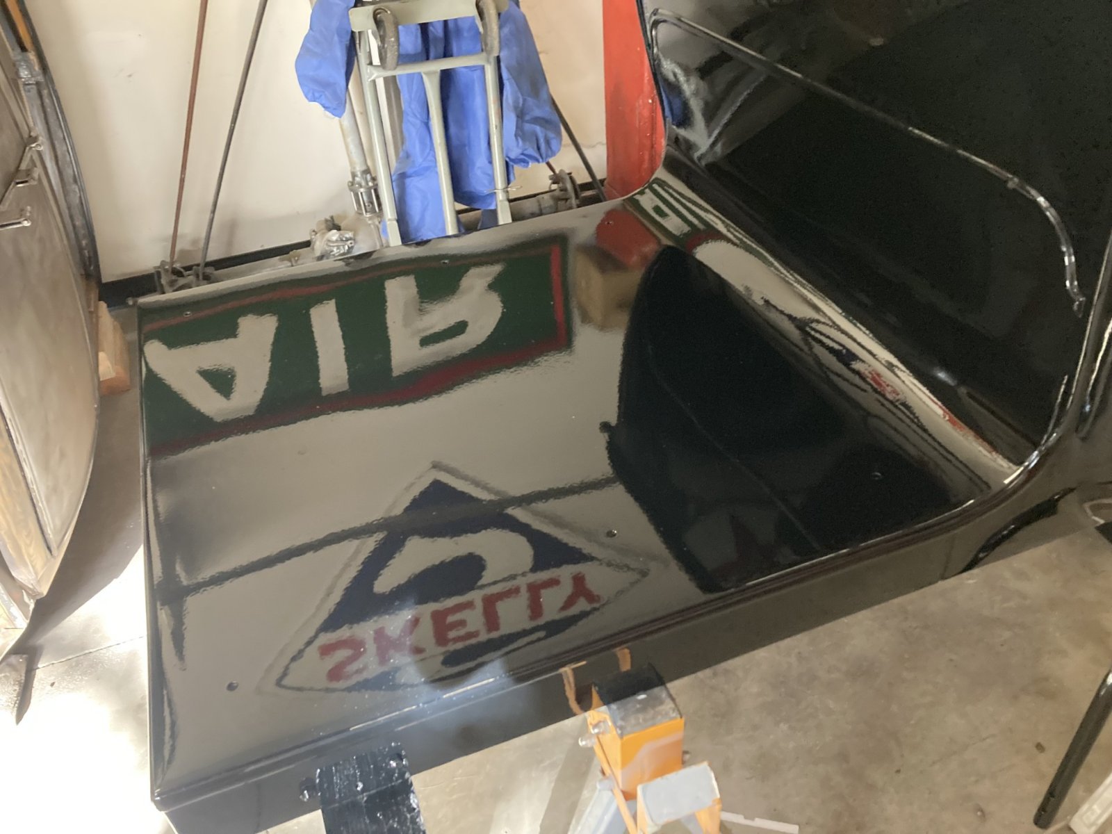

This is a 1914 Runabout body. It is s Beaudette body dated 10/14. Is this transition from the rear of the body correct? It looks like a patch. Art

Re: 14 Runabout body question
Post by KWTownsend » Mon Nov 18, 2024 2:51 pm
That was added on. Looks like it needed it.
Posts: 4303
Post by Jerry VanOoteghem » Mon Nov 18, 2024 3:22 pm
Yes, that's an add-on. I think the piece of galvanized sheet metal is as well. I believe the rear panel of the body should slope/curve down to the rear deck floor, then stop after becoming horizontal. The rest of the rear deck should be wood. (I have a '21 Runabout. Happy to be corrected if my advice doesn't apply to a '14)
Post by Art Ebeling » Mon Nov 18, 2024 3:29 pm
I figured as much. Can someone share a picture of what it should look like? Thanks for the info. Art

Post by Jerry VanOoteghem » Mon Nov 18, 2024 3:42 pm
I may be in error about the sheet metal deck covering. See here, Russ Furstnow's car... viewtopic.php?f=5&t=40709&p=312755&hili ... 14#p312755
Post by Art Ebeling » Mon Nov 18, 2024 4:52 pm
Should the turtledeck have a wood floor?
Post by George House » Mon Nov 18, 2024 5:17 pm
Yes, it is a patch and yes, it should have a wood floor. I have two ‘14 T runabouts. One of which I’ve restored and the other Ed Messenger restored. They both have wood floors. In fact, heres a picture of an original 1914 runabout turtledeck floor:

Post by Wayne Sheldon » Mon Nov 18, 2024 5:48 pm
I am not positive that the 1914 was the same? However, when I was looking at early turtle decks while trying to get my 1915 close to right, I found several 1915 through 1918 turtle decks with original wood in them that clearly did not have a floor built into the turtle deck. Mine had solid steel, but nothing whatsoever left of the wood or front steel panel (hidden from view when installed), and it was more than a little bent.
A very good friend loaned me a very nice early take-off turtle deck so that I could copy the wood and the missing front inside piece as well as match the shape and curves as I repaired mine. (Thank you Phil!!)
His very nice original with totally original paint and wood had no sign whatsoever that it had ever had a wooden floor attached inside the turtle deck. So that is how I restored mine.

Post by Wayne Sheldon » Mon Nov 18, 2024 6:00 pm
I suspect that whether or not they had a built in wood floor of their own may have been a body supplier difference? It might have also been a year to year specification difference from Ford. However, this question keeps coming up, and I have not yet seen a definitive answer based upon Ford's records or a significant study of surviving cars. So there may not be a clear answer to the question.
While searching for the answers for myself, I did see several original turtle decks that clearly DID have the wooden floor originally, so they clearly (to me?) were done both ways. The remaining question becomes "when did they do what?"
One of the reasons I chose to not have the floor built into my turtle deck is that the turtle deck/trunk is small enough and I figured the added almost an inch of height might be helpful with gasoline cans or boxes of tools or spare parts.
Post by George House » Mon Nov 18, 2024 6:51 pm
Wayne, I’m not an ‘expert’ on ‘15-‘18 turtledecks like you but my great fondness for specifically 1914 runabouts caused me to closely inspect this year model over 2 decades. They all had a wooden floor. Ed Messenger has won 6 AACA Jr and Sr First Places on his restorations and, although the 1914 runabout I now own wasn’t one of the 6, he restored it with a wooden floor. Two Saturdays ago I was at the Kingsbury Aerodrome for a fly in and car show. In a shed there sat a very dilapidated 1914 T runabout with a turtledeck wood floor. It’s still there. I recently sold a ‘19? - ‘22 turtledeck with a wood frame but no evidence of a wood floor. I am only trying to answer the OP’s question to the best of my ability and thought a photo might lend some credence.
Maybe Russ Furstnow will chime in. He has a ‘14 runabout and is a knowledgeable restorer.

Post by John kuehn » Mon Nov 18, 2024 8:54 pm
When I bought the turtle deck years ago for my 1919 Roadster/Runabout it had a wood frame around the inside and a single piece in the middle with no evidence of a floor. It looked original to the turtle deck and had what was remaining of black paint. If I remember the main difference in the years were the two lid handles. The earlier ones 14-17? rounded and the later 17-22? flat. Also the later had clearance for the battery. More knowledgable folks would know more.

Post by Norman Kling » Mon Nov 18, 2024 9:15 pm
Depends on whether you want a show car or a driver? If a driver, just find the correct turtle back and place it. My 22 has a wood floor with an opening for a battery. If you are not going to have a battery, just make the entire floor out of wood. Once the turtle back is installed, it will function just fine and you will get a lot of complements on your car. I know that a lot of things on mine are not original for that car, but I bought it from an estate and haven't done anything to the body. I have had the transmission out because the car is an atheist. Twice when I tried to drive to church it broke down. Once the low drum broke and I stopped right in the middle of the road couldn't even push it. Had to get a trailer and put a rolling jack under one end of the rear axle to winch it onto the trailer.
That happened about 10 years ago and it is running fine today. In fact I started it up and am going to clean the dust off it and drive to the local museum Saturday unless it rains.
If you want a show car, you have a lot of work and research to do to get everything perfect.

Post by Wayne Sheldon » Tue Nov 19, 2024 3:22 am
George H, There are so many confusing details about our beloved model Ts, so many things for which there are no definitive answers. Thank you for your comments and contributions. Very likely the earlier models did have the floor inside the turtle decks, and it may have been discontinued later to save a few more cents per car. The really curious thing to me is that I have seen a few (I did not look at many?) later starter era turtle decks that also had a floor in them. So again, all we can really do is speculate on the reasons and timelines.
Again George, I always look forward to reading your contributions here. I like to share what I think I know and spent many years trying to learn. And this forum is at its best when several people contribute to the discussions to give a more complete picture.

Post by Art Ebeling » Tue Nov 19, 2024 7:54 am
Thank you for all the responses. I can see the nail holes indicating where the turtledeck floor was nailed to the wood side frames under the turtledeck. I think the biggest challenge is going to be repairing the back of the body where the patch is. I assume the rear should curve into the turtledeck platform as Russ's does. Russ's is a Wilson body, can someone post a picture of the rear of a Boudette body without the turtledeck on it. Art

Post by George House » Tue Nov 19, 2024 2:32 pm
Art, I’m very sorry but both my Beaudettes have a turtledeck installed. :oops: When the snowflakes start falling in Illinois, why don’t you drive south to sunny south central Texas and pick up that original turtledeck wood floor - like they all had.
Post by Art Ebeling » Tue Nov 19, 2024 6:48 pm
George, Thats a great idea on the wood and I might be able to get that way. Can I let you know when I know? Art
Post by Original Smith » Wed Nov 20, 2024 12:18 pm
I have an original 1913 runabout, and the sheet metal under the turtle deck starts just at the top of the body and goes all the way back to the rear.

Post by Bmodeltman » Wed Nov 20, 2024 7:13 pm
On a real 14' the turtle deck is more forward than the later roadsters. On my 19 the deck is almost even with the rear sill cross member and the 14 is im guessing 3/4 to inch ahead of the rear sill.
Post by Russ_Furstnow » Thu Nov 21, 2024 6:39 am
The rear body panel on my son's 1914 runabout is like Larry Smith's 1913 runabout. It is one piece that goes all the way under the turtle deck. Also, the bead on the back panel is different that some other bodies. This is a Wilson body and was produced in August 1914.
Regarding the turtle decks, the 1914 turtle deck that was on my son's 1914 (the car photographed) did not have a wood floor. The steel floor provides strength for the items stored in the turtle deck. I have a 1913, Wilson body runabout, and it is identical to my son's 1914, with a one piece rear panel and no wood floor in the turtle deck. It seems that Wilson bodies varied from other manufacturer's bodies.

Post by Art Ebeling » Thu Nov 21, 2024 10:19 am
Here is the latest picture of the 14 Runabout body after removing the paint. Art

Post by Russ_Furstnow » Thu Nov 21, 2024 11:13 am
Art, The turtle deck floor looks great. Is there any letter stamped into the kick panel just below the seat cushion? Russ Furstnow

Post by George House » Thu Nov 21, 2024 12:07 pm
Yes ! You’ve obviously accomplished a lot ! You can cut off the cancerous rustout at the lower back body panel and there exists machines that can correctly curl 20 ga sheetmetal to MIG weld to the original squared off panel. I’m curious of the 2 vertical holes in the very rear ostensibly for the tail lamp bracket ? My 2 (4) bracket holes are on a horizontal plane ? A bit of $35 research I had done at BF Archives revealed the carriage bolts at this location used SQUARE NUTS. FWIW :roll:

Post by Wayne Sheldon » Thu Nov 21, 2024 7:14 pm
Another for whatever it is worth?
There are some obvious changes between 1914 and 1915. However, my 1915 in spite of poor condition, still had the inside corner brackets in place. The 1915 tail lamp and bracket are of course quite different from the 1914, and the original bracket had been broken off. Yet the original bolts for the bracket were in place. And so were the square nuts. And that is how I restored it.

Post by Art Ebeling » Thu Nov 21, 2024 8:03 pm
Russ, There is a B on the seat riser. George, I am glad you noticed the tail light bracket holes. I do not have a bracket and I think the holes should be horizontal like yours. Art
