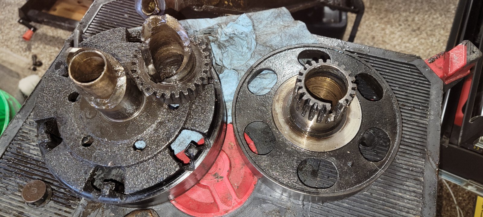

Update
Looks like Speedtinc was on top of it. The shaft was broke as well as some other stuff.

Actually. Adam was first.
I have seen a few that spiral crack & expand to lock the 2 drum shafts. Yours actually broken is most severe.
That spiral break seems to only happen on a wide drum.
It appears that the extra brake surface exceeds the design limit's forces.

Thanks Jerry! The diagnosis is the product of nearly 25 years of experience with several engine and/or transmission rebuilds per year. It’s not in any of the books but I’ve seen it several times and there is nothing else that acts like it. (A couple of these are in “running & driving” cars that the owners either didn’t want to fix or didn’t think it was a major problem because it “still works “good enough” most of the time”… Until that fateful day arrives.Jerry VanOoteghem wrote: ↑Tue Mar 11, 2025 12:45 pmNot sure which I'm more impressed by... your diagnosis or the damage!![]()
Excellent call!
