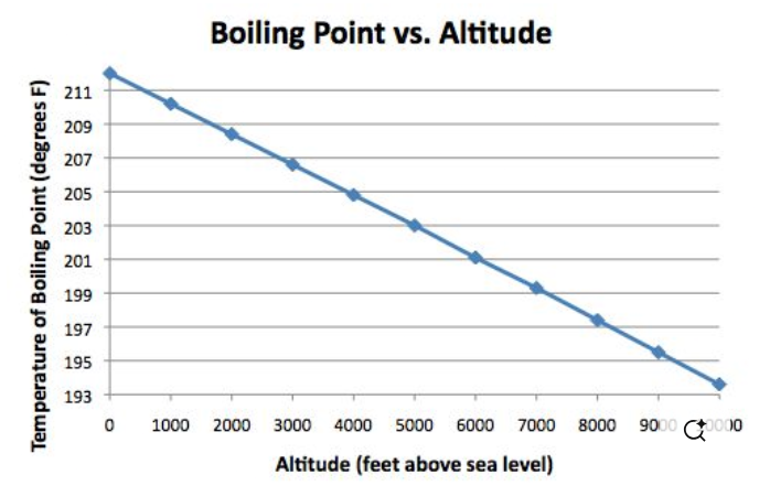

They usually run from about 180 to 200 F. Boiling over is too hot. With modern oil and modern coolant, 200 to 215 F is no problem for the engine, as long as the system is full of coolant and working properly. Any atmospheric cooling system will boil at lower temperatures at higher altitudes.

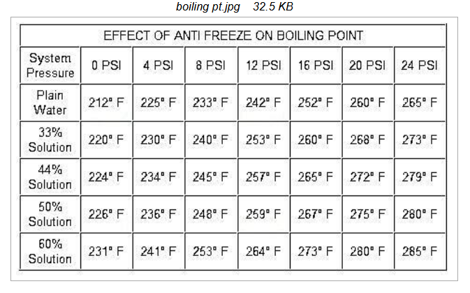

The push back on pure antifreeze is, (as you stated) lowers the boiling point. The T cooling system is not pressureized. Running 180 to slightly over 200 is fine as long as it's NOT BOILING. Most T's will occasionally spit out some coolant after a long hill climb. To put it plainly, cruising on a hot day and it's not boiling but for a gurgle or two from a hill climb or when you first shut it off, you are fine. You don't need to know the precise temperature. You just need to know it is not continually boiling.

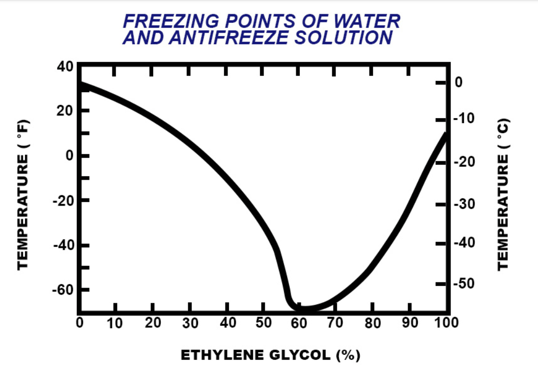

100% antifreeze is counter productive
Choose by your winter freeze
Pick your boiling point based on altitude
For Boiling point in an unpressurized system
At sea level a 50% solution raised the boiling point 14°F. At 4000ft the boiling point is 205°F so raising it 14°F would need just a 33% solution.
So at higher altitudes, where air pressure is lower, the boiling point of water and coolant mixtures can be lower. Then you don't need to use as much antifreeze to achieve the same boiling point elevation as you would at sea level BUT the higher you go the colder the winters are so you need a higher ratio to prtect from freezing like 50/50

Modern oil will allow operating at 200 F or so with no issues. Just be sure the system is kept full of coolant. 50/50 water and "green" antifreeze works very well. There is no practical reason not to use it, and use it as directed. Modern type valves are recommended for any Model T being driven on the road. Ford designed the T to run at 180 to 200 + F. With modern oil, there is a wide margin of safety at 200F as far as oil temperature. As long as the cooling system is reasonably clean and kept full of coolant, the engine will be fine at higher temperatures. Ford pointed out that temperatures near boiling gave the most efficient operation.
Topic author - Posts: 8341
Re: Operating Temperature - what is the range?
Fifty-fifty, unless you are touring the Yukon Territory in January.
