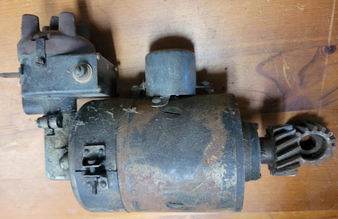

Does anyone know about this setup? I just won it on eBay. Not a lot of info in the listing.

Interesting find! The mid 20’s Chebby had a dizzy on the back of the genny similar to that. Don’t recall the funny shape dizzy housing tho. Be careful with the drive housing as many are pot metal, so possibly very delicate

For the distributor to time correctly there must be some gear reduction built in. There are less teeth on the generator than the crank gear, making the generator turn faster than crank speed.
EZ check. Watch the rotor as you turn the gear. it should turn less than 1 revolution to one revolution of the gear if my math is correct.
You could have something special here or an experiment that didnt work out.

From the color of the housing for the distributor mount, I am thinking it might be aluminum (hope anyway). Yes, the Chevrolet around 1925 ish did have the distributor driven off the back of the generator and I think other brands did also. Not only were those Chevrolet housings pot metal, so was the body of the distributor. I get the impression that it might be an Atwater-Kent distributor but not sure. Yes, I sure hope the gearing to drive the distributor compensates for the speed the generator is driven at!

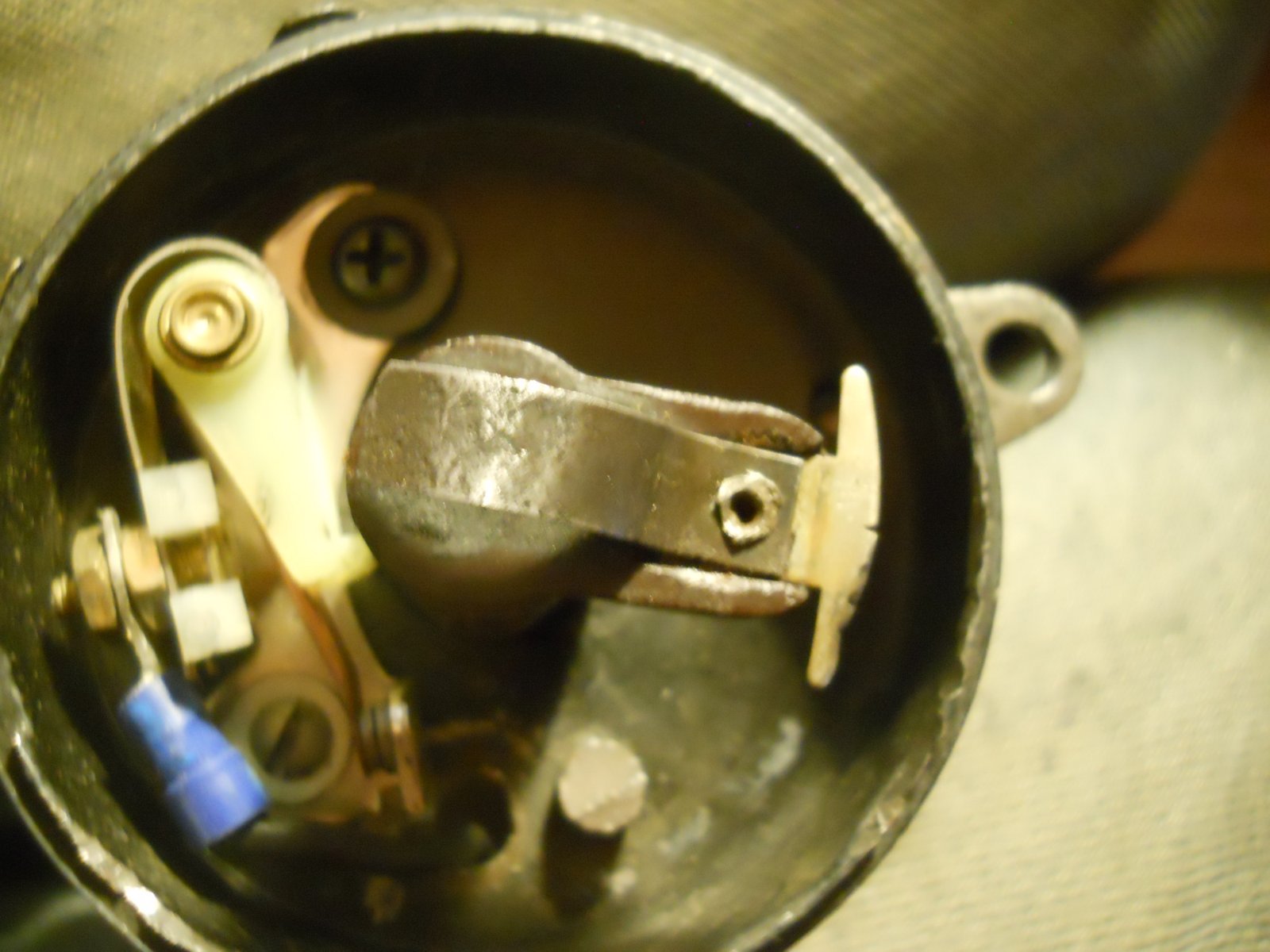

I'd like to see a photo of the points and rotor before I guess what the manufacturer was.

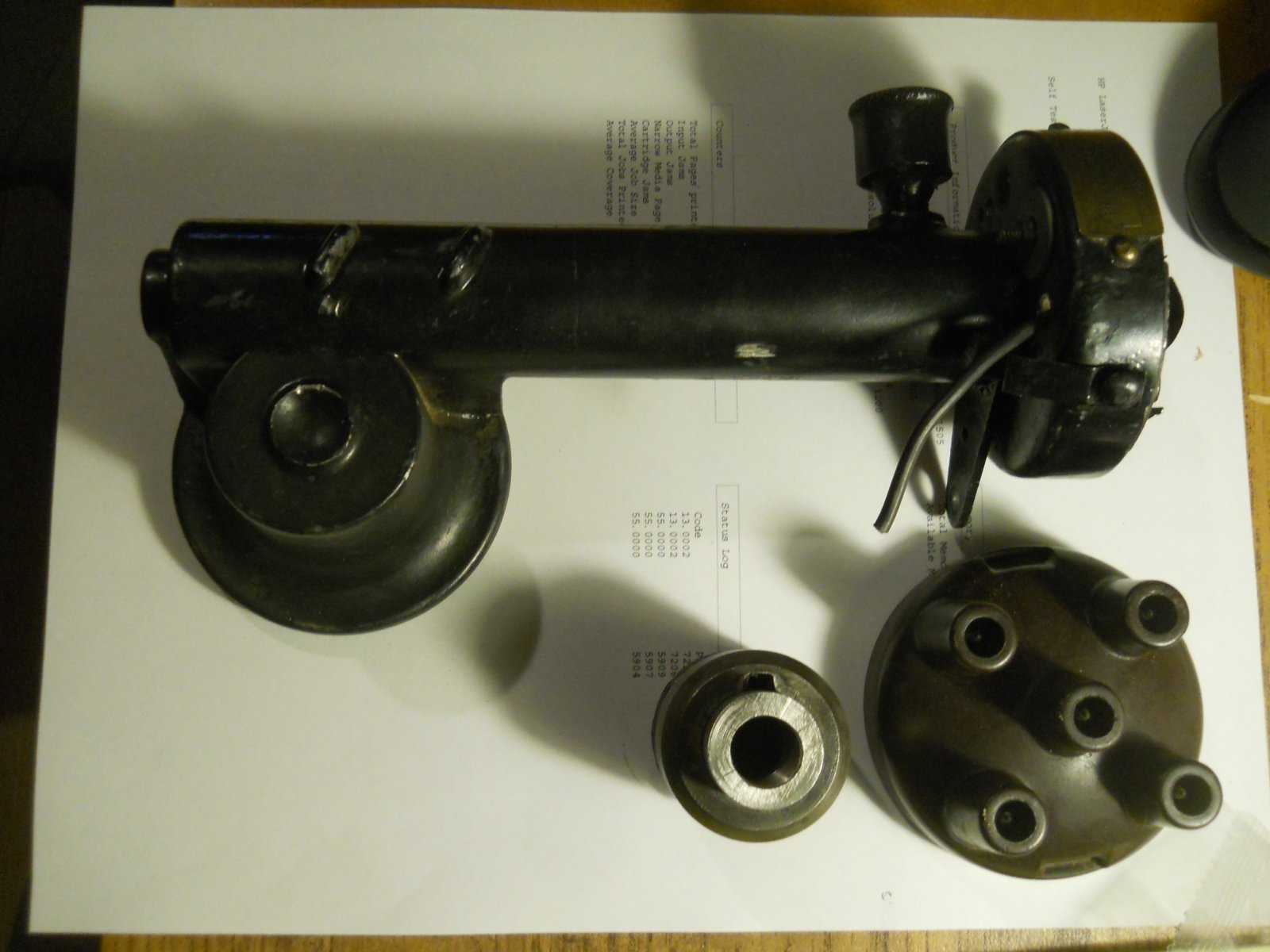

I have had one of the Ignitor distributor for years. It was missing the part the cam gear fits onto the camshaft and holds it in place. I will have to go look now and compare caps, but offhand I think it might be smaller.
Dan thank you very much for posting those.
Here is the one I have. The cap looks really good and rotor not too bad, hope they are the same. Someone replaced the points with modern ones. I had made the part that holds the driving gear, which is threaded and still needed a keyway cut and hole for pin to lock on the camshaft but don't know how well I got everything centered, was one of my early lathe projects.

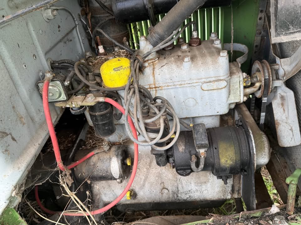

That is a really cool find!! As mentioned above, this was a common arrangement on several makes of the era. 1925 Chevy had this setup plus the oil pump added onto the rear.

Same arrangement on my 29 buick

Got it on Saturday. Looks really good inside even the distributor gears had good grease in the housing. The gear on the gen. shaft is 4 tooth and the one on the distributor is 12 so 3:1, with the generator gear being the same count as stock.
I put it on the KRW test stand and out of the box was charging as about 7-8ish amps.
The cap from my other distributor fits as does the rotor. The only difference in the two rotors, the end that sweeps past the terminal is a little wider on one then the other.
Going to remove the brush end cap, give a good clean and figure how the 3rd brush moves and check on the growler, paint and install.

While the generator looks good inside and after cleaning/painting put the casting that holds the distributor on and check it for output on my KRW test stand. That part checks out.
The distributor: The cam can be adjusted to any position, like a Model A but instead of using a screw and lock washer it uses 2 ball bearings that are pushed out by a cone on the end of a set screw. (the other one I have used the same idea as the Model A and makes me wonder if Ford bought the pat.) Even after cleaning the cone up some, unless you hold the cam tight it wants to walk around the shaft because the cone is rolling the balls. The pickups for power to the movable and stationary points is a sleeve with spring loaded contacts that ride on insulated plates in the bottom of the distributor body. Then there are two pickups on a spring loaded thing that rode on an insulated sleeve on the main shaft that turned with the shaft and cam no idea at this point how that works but can guess. I rewired the two spring loaded pickups, one to ground for the stationary contact and one to the movable points arm and removed that insulated sleeve.
Got everything lined up and mounted, set the timing, made the advance/retard rod, installed new wires, coil and condenser. Well it ran for a little bit till the cam worked around and went out of time (reset it more then a few times) and think also the movable point arm spring is too weak getting too much bounce.
Pulled the distributor out. This is when I cleaned the cone on the cam setscrew and really looked at the brass gear on the shaft, POOP it is really worn and has a crack running top to bottom.
To save it at this point will need to get a new gear made and am going to modify a Ford Model A distributor to fit. The machined part is just a little smaller in diameter, but the length is pretty close.
