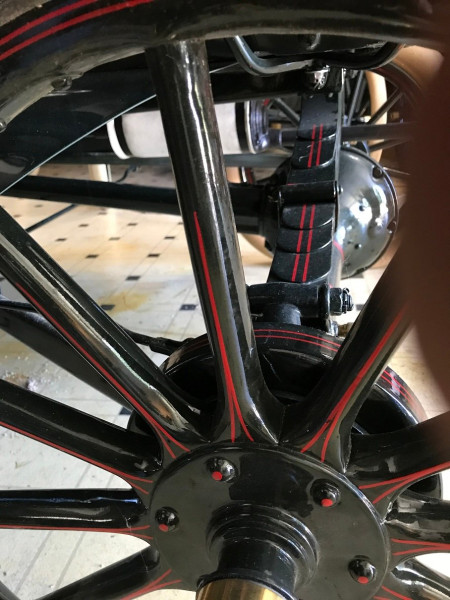

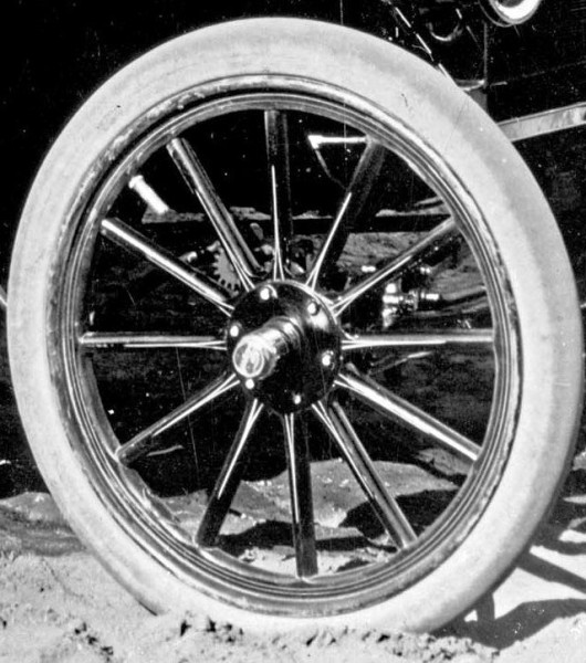

Here are a couple pictures of some original striped wheels. I think the color photo is of a pre-1912 and the black and white is of a 1912. I am going to get my wheels striped so I am interested in which is original for my late 1911/early 1912 Commercial Roadster. I personally prefer the striping in the color photo, but will go with what is original. I don't want to be called "Non-Original Jones!"

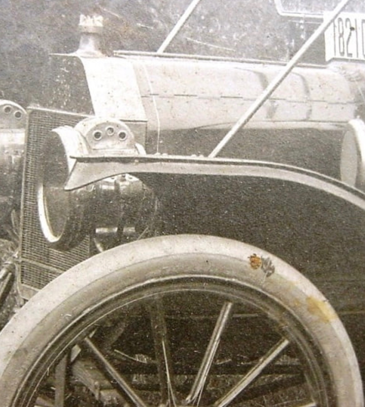

Another view, this is a late 1912 slab sided bodied touring. Wheel spokes have open darts on the stripes.

I like your colour pic too, I was thinking about striping the spokes... I may do something similar to that pic....

You color photo is a hard no. The period photos are what you want. I have an original wheel in my collection and it matches those photos exactly. Note the large porrion of each hub bolt has paint as well. The hub plate never had a stripe on it. That was a 1970s thing that refuses to die.

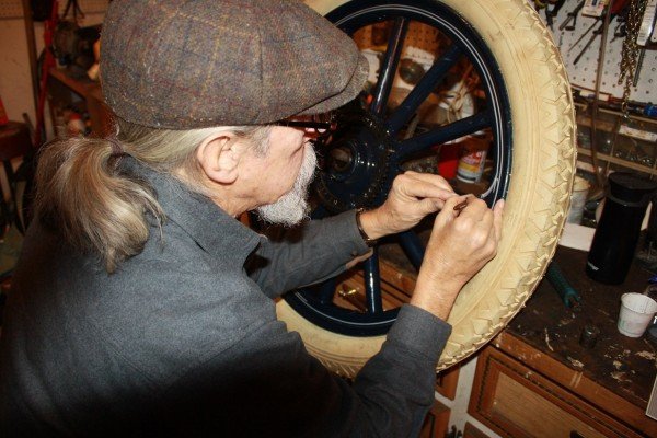

Carig Beek's striped wheels match the first BW photo A double stripe around the rim & split fork at the hub
The striper
Pin 1.jpg (63.53 KiB) Viewed 697 times

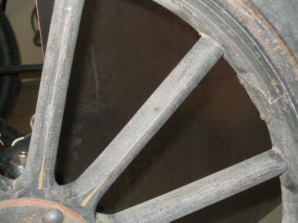

1910

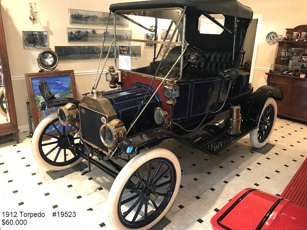

1912 Torpedo

I agree with you on the striping in the second photo, both as to style and color. Imho, subtle is better.
