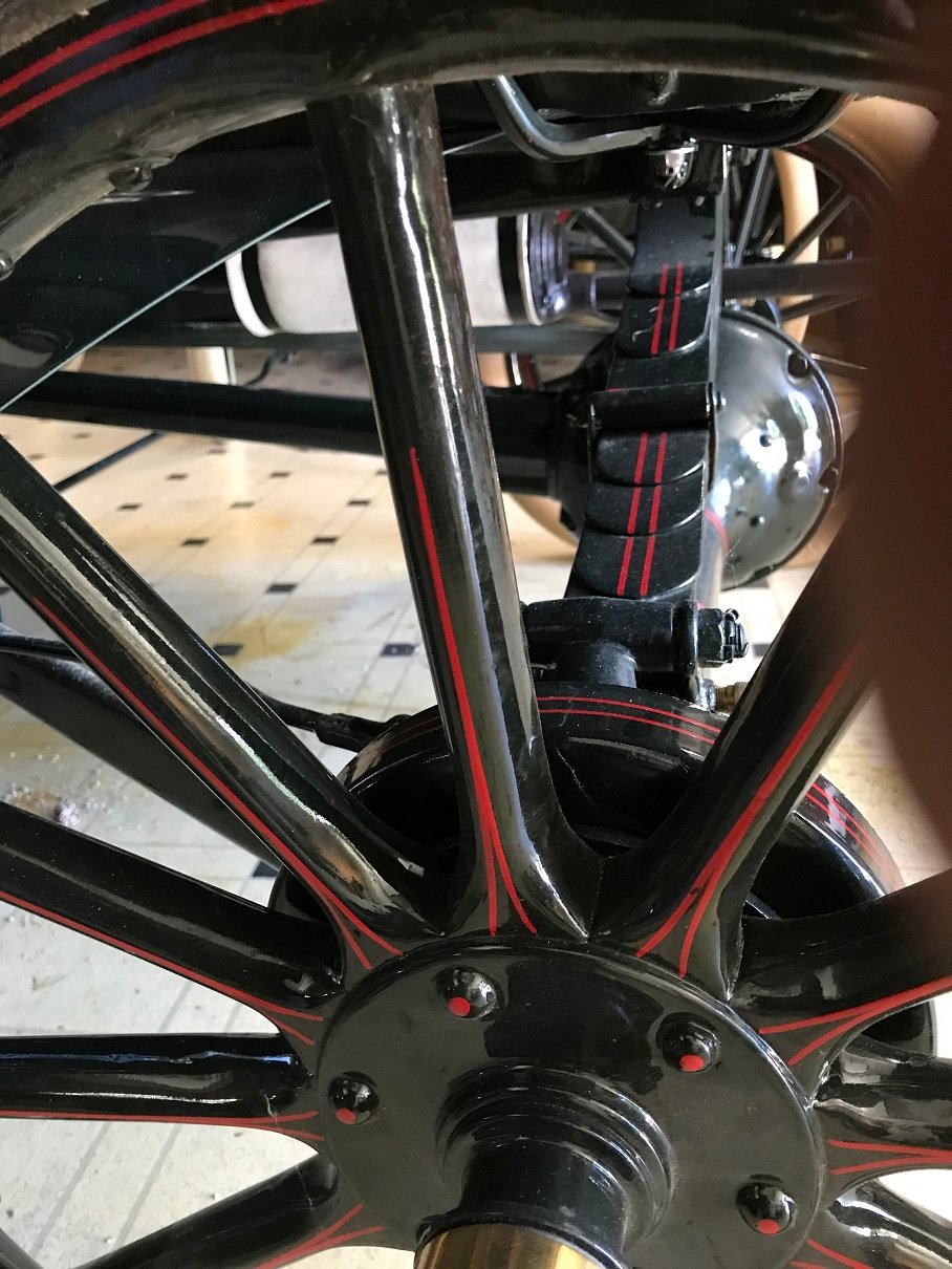

Here are a couple pictures of some original striped wheels. I think the color photo is of a pre-1912 and the black and white is of a 1912. I am going to get my wheels striped so I am interested in which is original for my late 1911/early 1912 Commercial Roadster. I personally prefer the striping in the color photo, but will go with what is original. I don't want to be called "Non-Original Jones!"

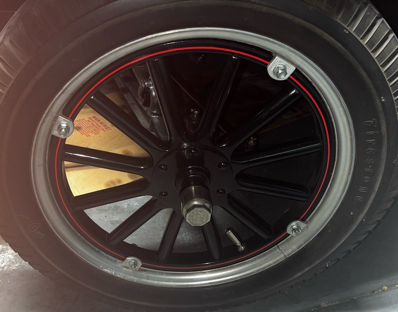

dunno, I have a 24 and I striped the rim because I wanted to.
do what you like and let future generations scratch their heads....
I like your colour pic too, I was thinking about striping the spokes... I may do something similar to that pic....

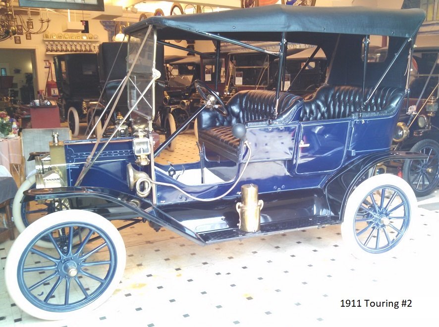

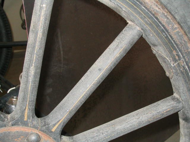

You color photo is a hard no. The period photos are what you want. I have an original wheel in my collection and it matches those photos exactly. Note the large porrion of each hub bolt has paint as well. The hub plate never had a stripe on it. That was a 1970s thing that refuses to die.

Post by TRDxB2 » Tue Jul 15, 2025 5:30 pm
Carig Beek's striped wheels match the first BW photo A double stripe around the rim & split fork at the hub
The striper
Pin 1.jpg (63.53 KiB) Viewed 1015 times

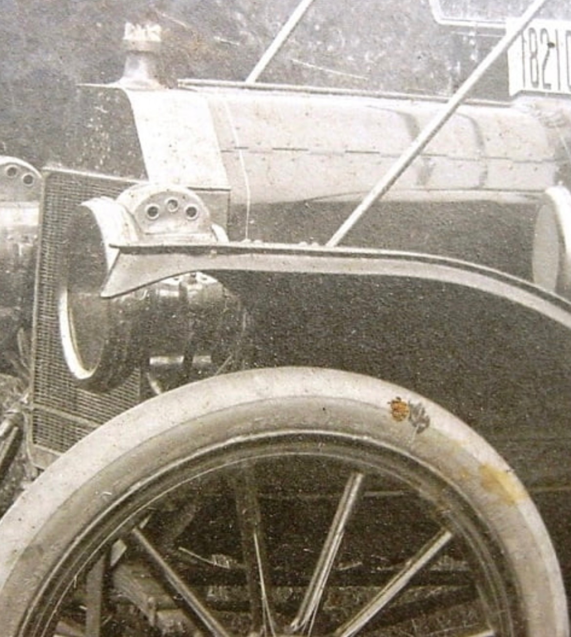

1910

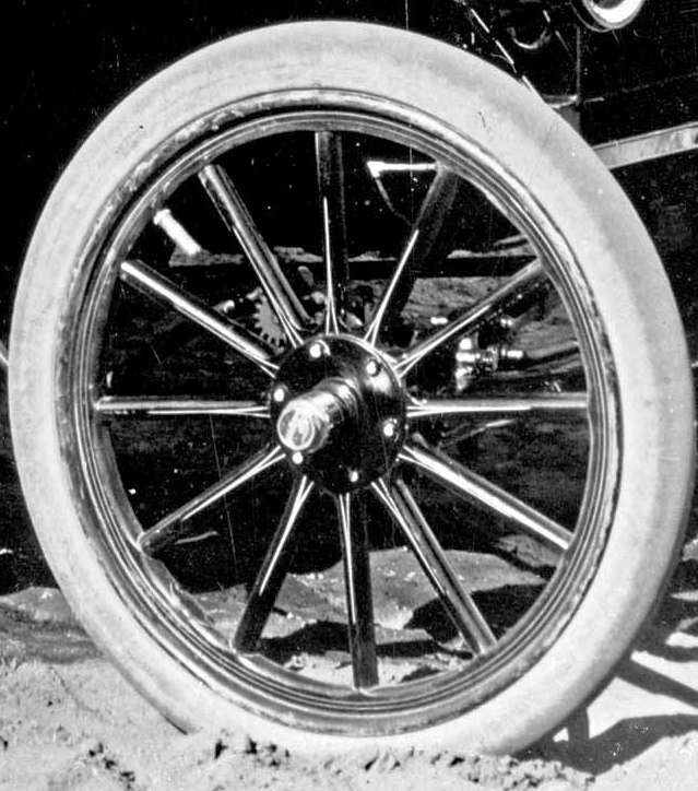

1911

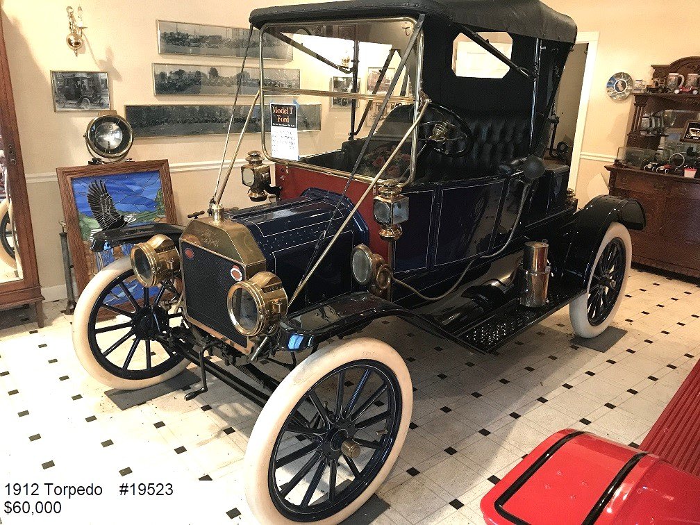

1912 Torpedo

I agree with you on the striping in the second photo, both as to style and color. Imho, subtle is better.
