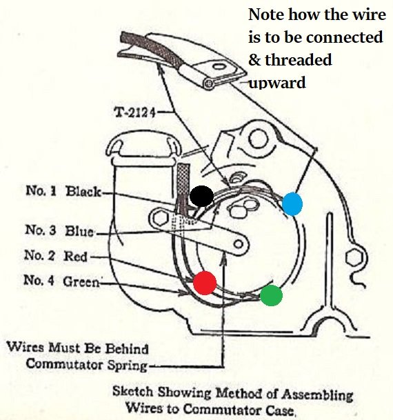

This sketch may help to check the timer case wiring.
timer wiring.jpeg (42.73 KiB) Viewed 2389 times

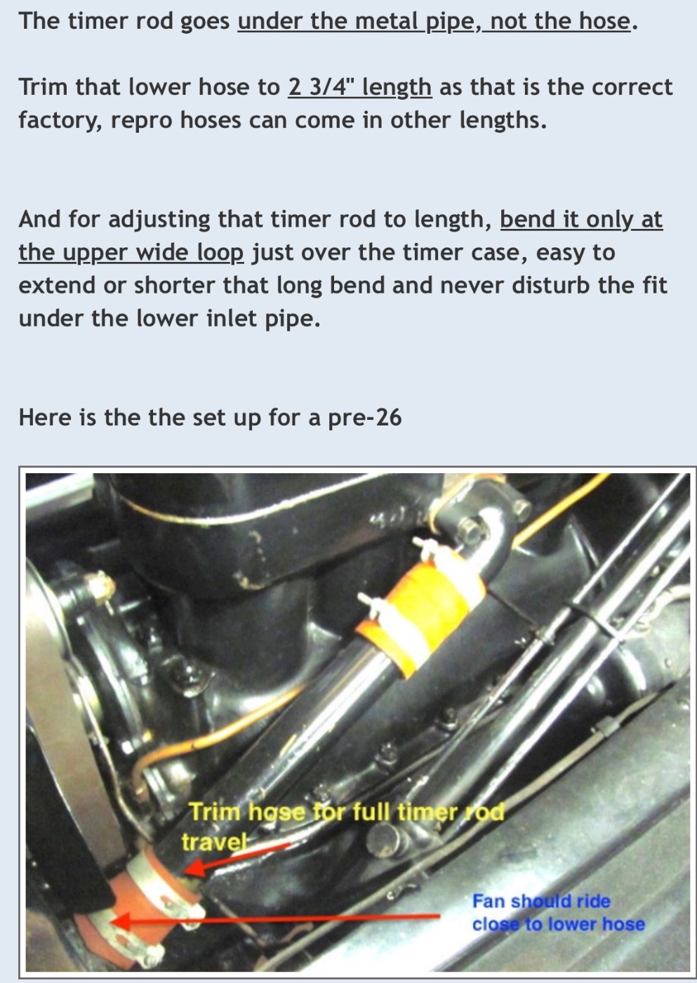

Quit wasting your time measuring any distance. THEY'RE ALL DIFFERENT. Try this:
https://dauntlessgeezer.com/DG97.html

Rainer - verify that the pan bolt directly under the timer has the head up top & the nut down below - when reversed, it can cause #4 to ground !
Good call, Steve ! Easy to miss, easier to forget when re-assembling a motor. So easy to ground a timer terminal !

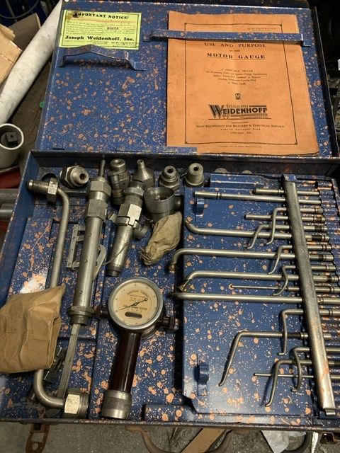

Or find one of these. Early timing light.

Anyway, problem is solved by correcting the connection for Cyl #4.

AndreFordT wrote:
Sat Jul 19, 2025 2:47 am
Had the same problem yesterday on a fresh rebuild engine.
Timer is a roller timer.
One of the wires (blue, 3rd cilinder) was connected with the terminal backwards and was touching the distribution cover.
How did I found it?
Set the contact on battery.
Turn the engine slowly by hand.
Than I found there were always two coils bussing, the one that was connected by the timer and coil 3.
Took the timer out and correct the connections.(all to the front away from the cover)
Engine is running great now and give me a free start at the end.
Just my story.
Andre
Belgium
This is exactly what I finally did.
I removed the coilbox-cover and slowly turned the engine. Whenever I heard a coil buzzing, I had a close look on the coil's contacts. The buzzing coil showed there little sparks. This way I found out that Cyl 1+2 buzzed "alone", then cyl 3+4 at same time, finally cyl 4 alone, ...
So I checked the wires on timer and solved the issue.
I don't know what Henry smoked when designing the timer-advance-rod, but that stuff was not good. :lol:

Looks like a need to order a new timing rod from one of our suppliers. It will have the curves and angles that is necessary in that rod for proper clearances. Adjustments can be made to the new timing rod, either to lenghten/or shorten, to establish/retain initial proper commutator spark setting.
Posts: 4040
Re: Strong kickback on crank since replacing the timer
Post by DanTreace » Mon Jul 21, 2025 11:48 am
It hits the engine block, rubs on water hose, is too close to the timer, ... There would be lots easier ways to link the timer.
If parts are stock, the Ford timer rod for the year of your T will work fine for doing timer adjustments.
